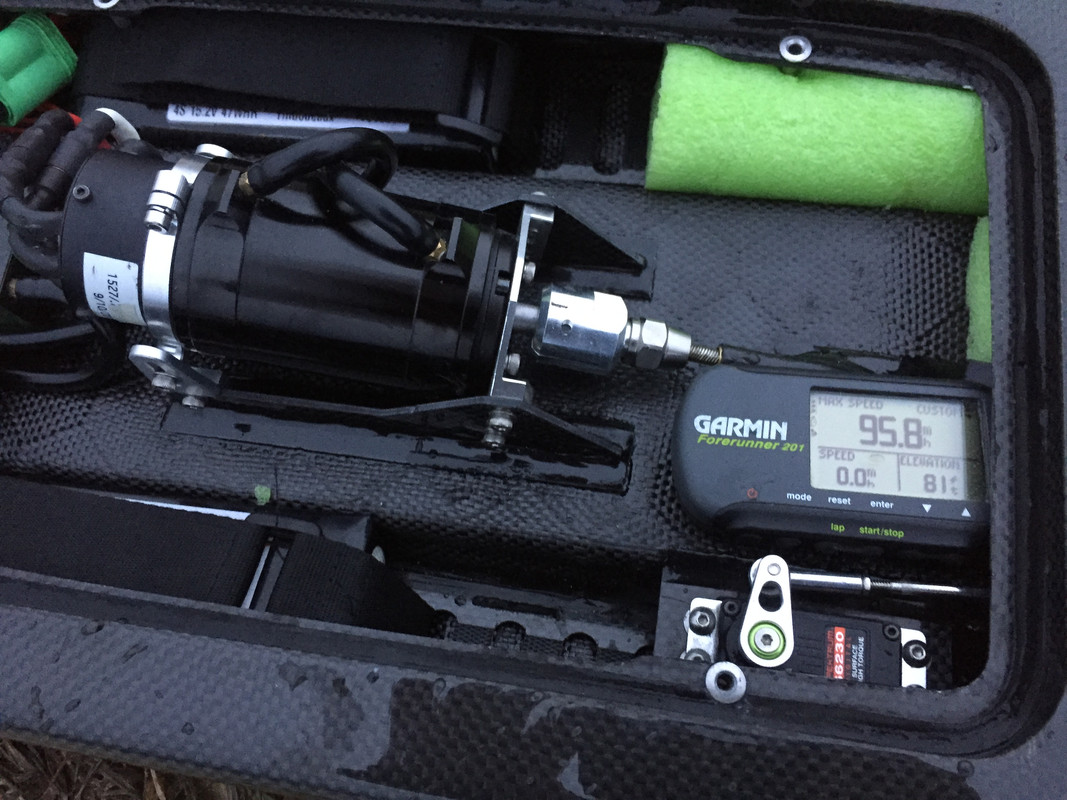

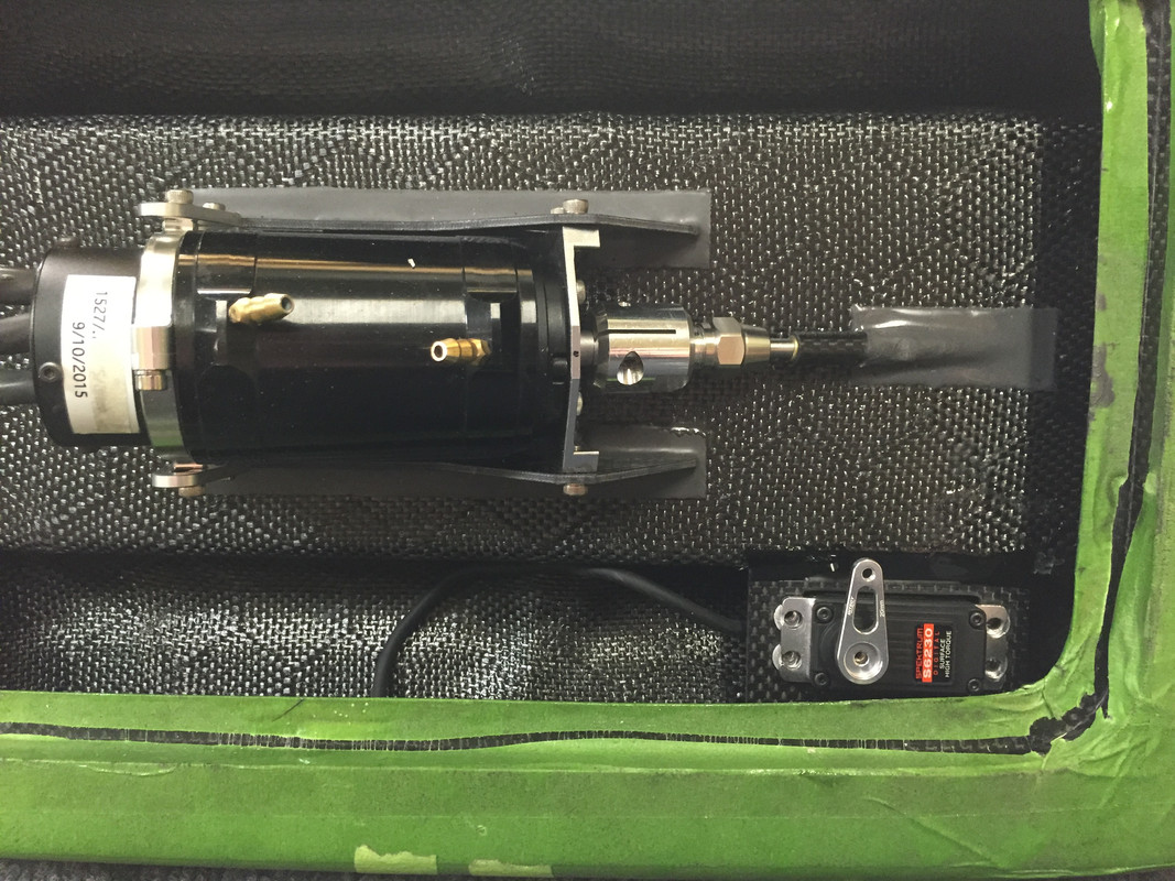

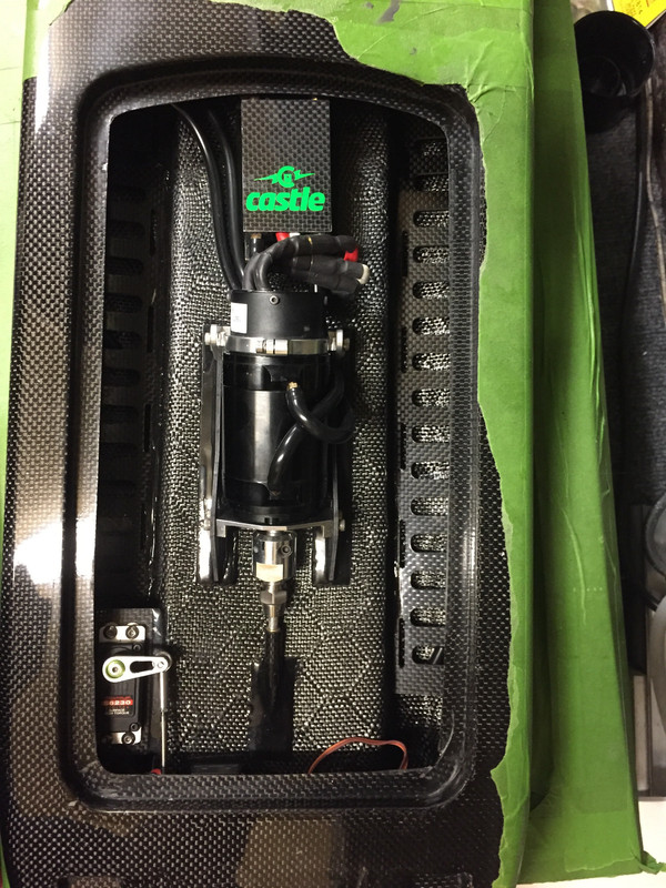

                        I'm very picky with my builds. I use jb weld and use a heat gun on low heat to help it flow and smooth out. Then if i want it black, i scuff up the jb weld and go over it with 5 minute clear epoxy, tinted gloss black (or whatever color i choose).
                          Bare jb weld
                          After coloring
                          • 30nitro
                            • Feb 2018
                            • 330
                            How does the JB weld hold up on motor mounts..? I've only used it on sponson water pick ups...
                              I’ve flipped boats at 90+ and it holds up. I flipped one boat at 100mph but the crash was 1 in 1000 and the way the boat came to an instant stop, it broke all kinds of stuff including the motor mount lose. But. Had the mount not let got it would have ripped a hole in the hull. I use jb weld every time. In my opinion it’s the best choice.
