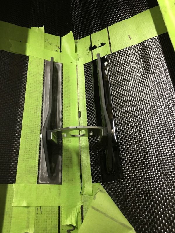

            Experiment tonight for you guys. From left to right:
            1) jb weld with graphite. It did not like to mix, was hard so work with and took a lot to get it almost black. Do not recommend. You can tell it's clumpy in the photo.
            2) Jb weld with nothing added.
            3) jb weld with 5 drops of super concentrated black epoxy dye. This dye goes a long way. Two drops will turn twice the amount of clear epoxy black vs the amount of jb weld. It just requires too much to turn the jb weld black.
            Tomorrow I'll test the hardness of each one and post back.

                    Ok I have some info for you guys. The jb that I used ropy dye, no. Not going to work unless you need rubbery epoxy. It was completely flexible. I could dig my nail in it and pull on it and it would spring back.
                    The graphite dyed jb weld was just as stiff and strong (perceived when I snapped them both in half) and the regular jb. Maybe you could experiment with it and just tint it dark grey and not try to get it black like I did and it might be a decent method.
