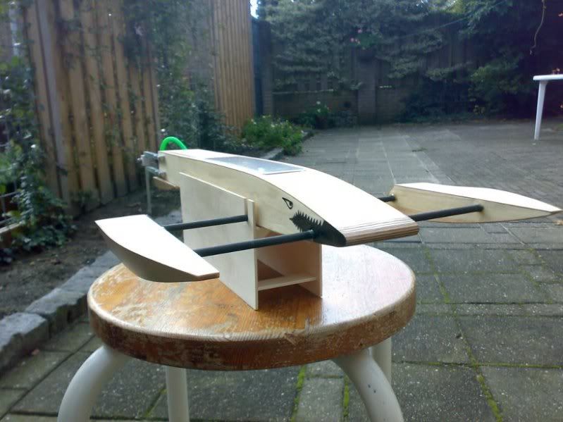

      Ik built a modified Predator rigger myself about 7 years ago. I actually narrowed down the front sponsons with 7mm, but I increased the rigger width by elongating the carbon rods. I used the rear sponsons, but I narrowed them as well with 3mm.
      I made my Predator rigger 52cm long (20.4") and I used a 28mm 3900kV motor with a 2200mAh 3S lipo. Speed and cornering was great. It reached 49mph.
      Just to say: There are several ways to modernize this rigger to a lipo setup that work great!
      Here's some photo's and a movie:
      After repaint:
      Movie:
