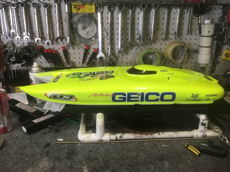

    I just couldn't not post this. Some of you have a thing for geicos so here goes.....

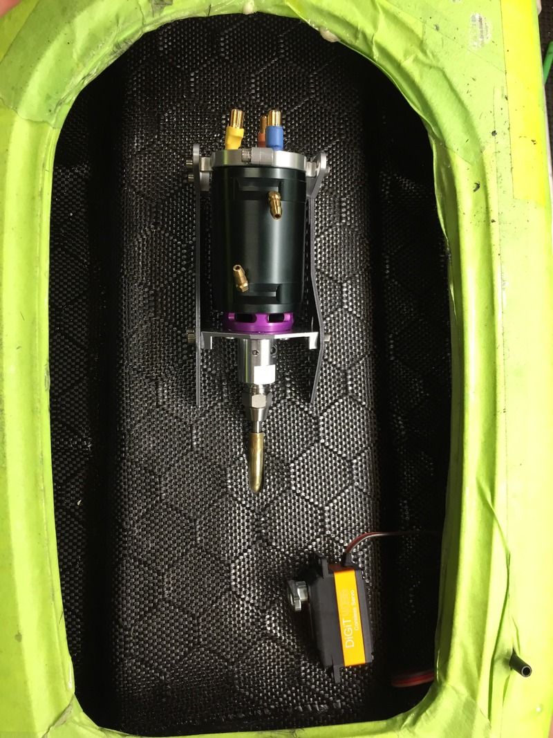

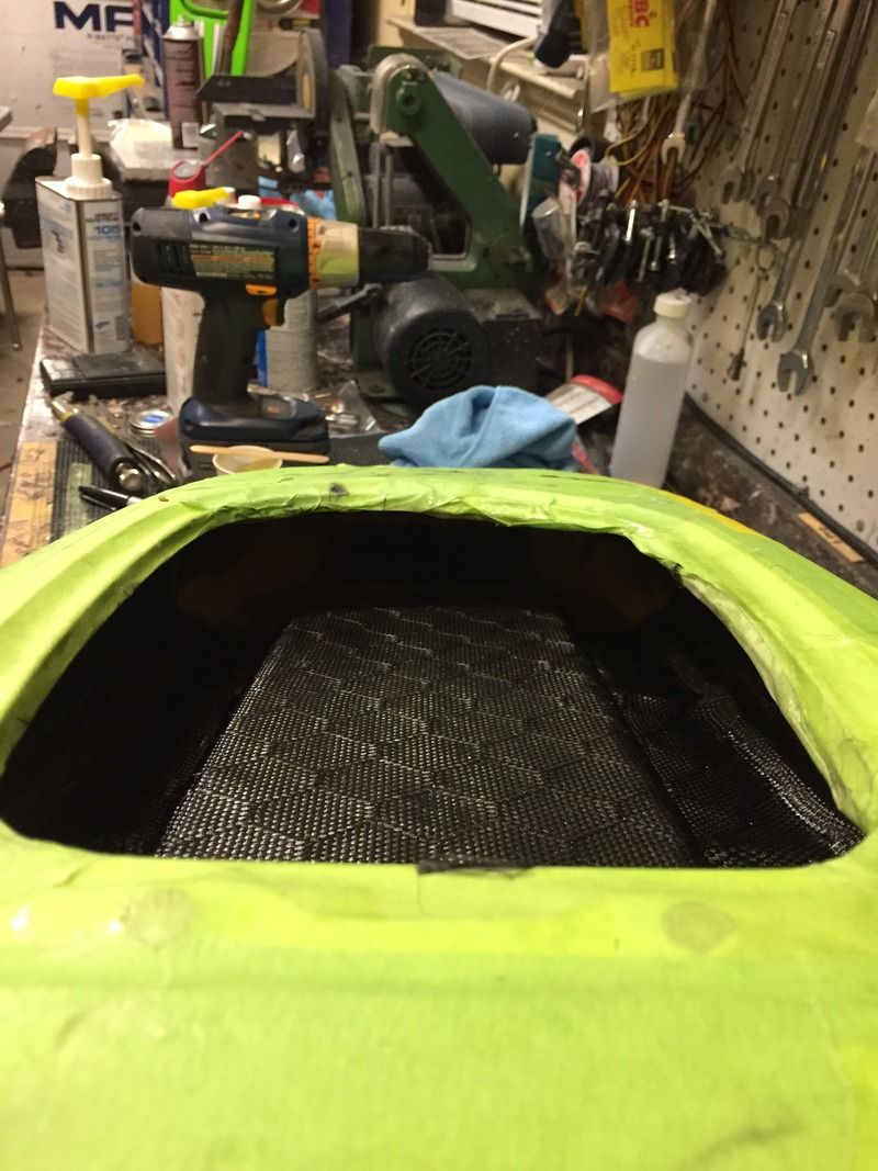

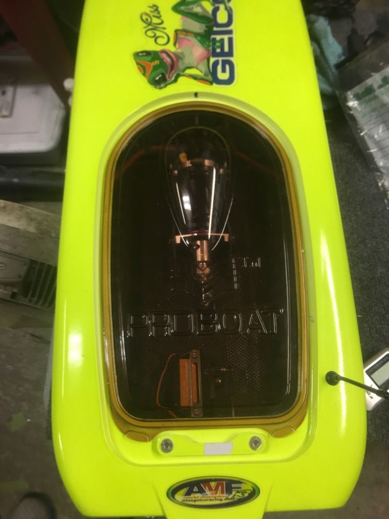

    The guy I sold my original Rivercat to had this idea to build a nice geico similar to my Rivercat build. No problem. So I reinforced the crap out of this thing and flooded the sponson bottoms with epoxy and chopped carbon. Tips, tunnel and transom too. Then I did carbon strips down the whole seams of the boat. Then a nice honey comb inlay. After I was done I got nervous at the weight of the boat. I was scared it wasn't going to perform well. Here's the layout
    Lehner 1940 18xxkv with fan
    Savox lo profile servo
    Seaking 180
    Mbp collet
    .187 flex for reliability
    Carbon motor mount
    Billet servo mount
    Stock hardware
    Abc 1615 prop (41mm)
    Inlay
    Here's the layout

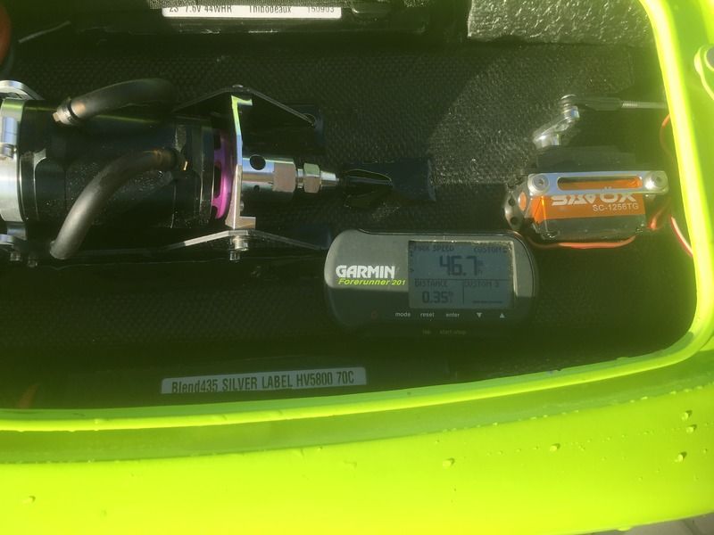

    I got to go run this puppy this past weekend. I was pretty impressed on it first run. Thinking it would be to heavy I wasn't expecting much. I was wrong. This thing drove awesome and I know the prop height was too low (bottom of strut even with bottom of sponsons). Boy it proved me wrong. It's no speed demon, it's intended to handle well and I was looking for 45-50 on 4s. Well it did that easily and in windy choppy conditions.

      How much epoxy did you end up putting in the tips? I just did my buddies and put 1 oz in each tip, also I noticed it kind of divited the tips slightly was this from heat? I probably shouldve done the bucket of cool water thing
        20 grams each tip. Yes put in water bucket. Epoxy gets super hot. I put this one in water but it still distorted a little bit.
