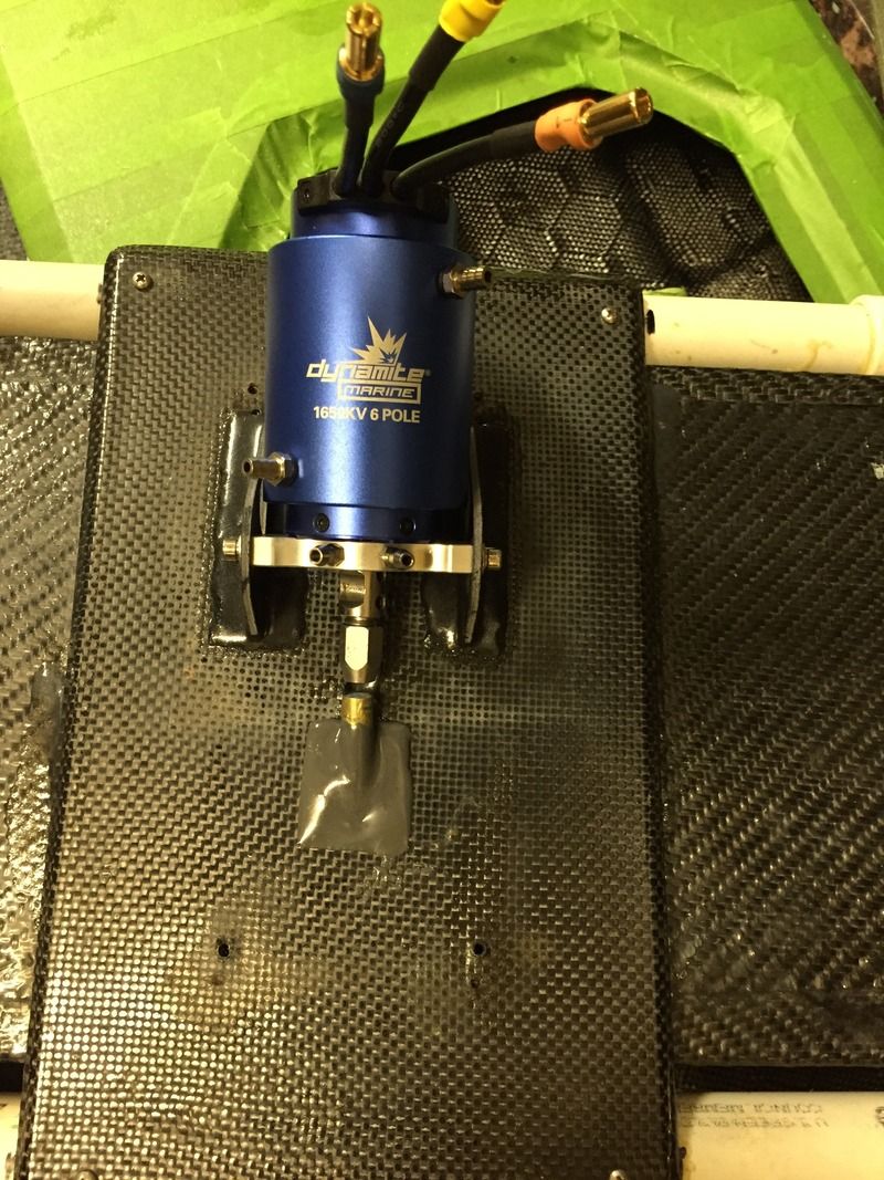

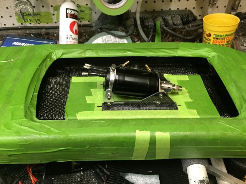

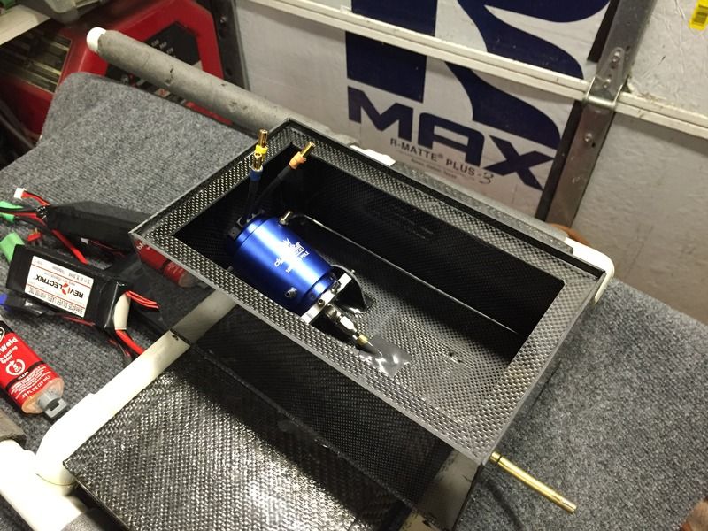

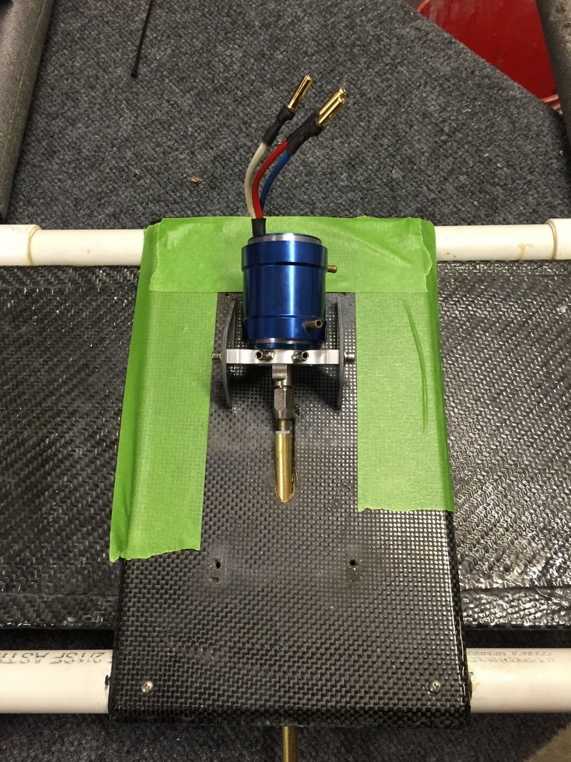

    Here it is box stripped off. Setting up motor mount
    At this point I thought I was going back with the same proboat 1800kv 36mm motor
    But then I dug through my motor drawer. I knew I needed something with some tq. Found just the thing. Muhahaha

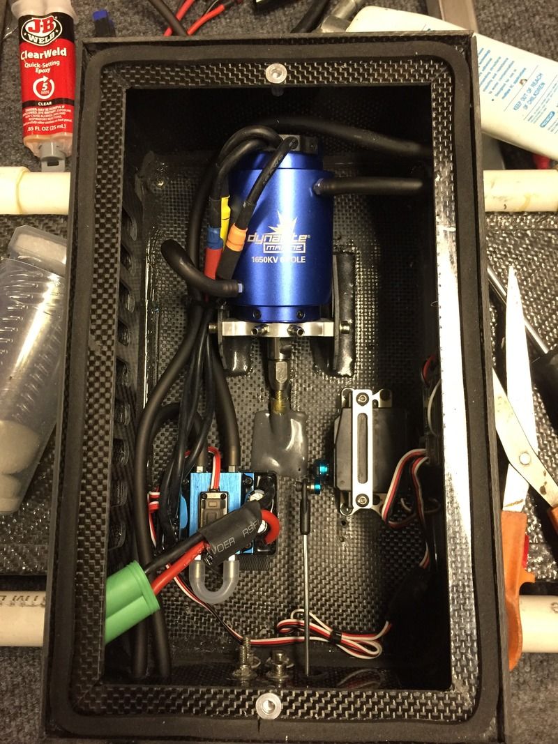

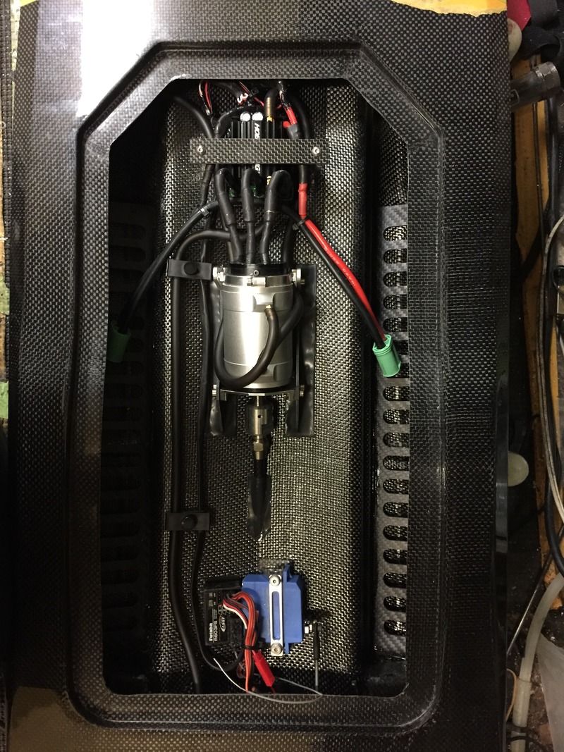

    At this point I'm winging it. Not sure what I'm doing for enclosure but I have an idea.....
    At this point I'm headed down a path of no return. But I'm liking it.

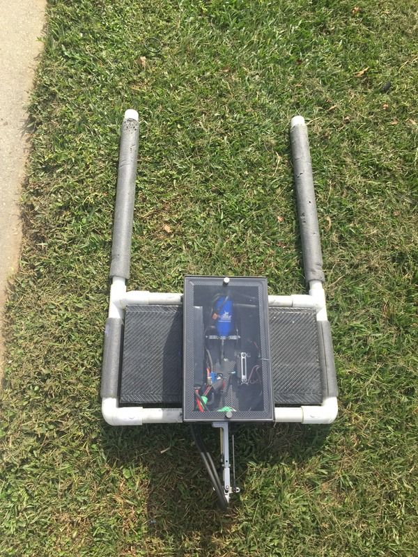

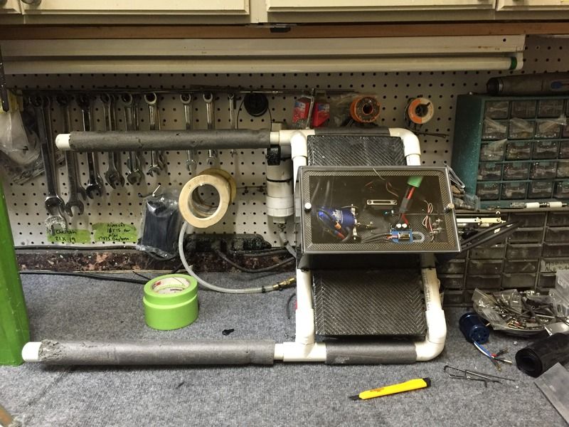

    So I know I skipped a few steps but the lip all the way around is heavily reinforced with west epoxy and chopped carbon. I decided on the matching dynamite 120 esc, .187 flex with Teflon (less maintenance I hope) and a aquacrap servo I had laying around, dual cooling Genesis rudder (this is the only thing I'd use one of those things on lol)
    And completed!

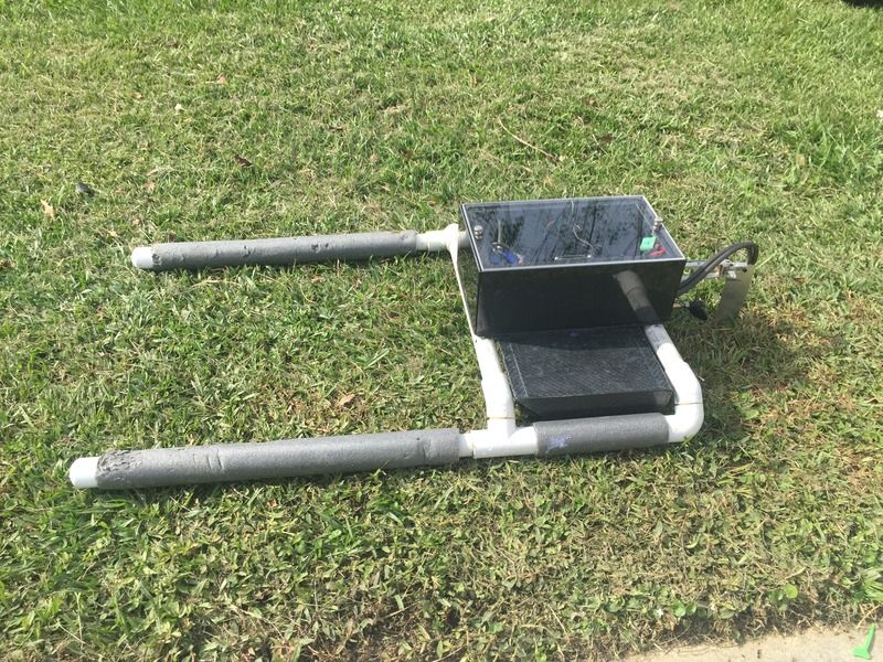

      And one more pic. I tried it out the other day. So much power that it would stand the booms straight up in the air. On 3s. So I had to give it some negative prop angle to settle it. I'm gonna extend the booms a bit and add so weight to it and change the foam out on the frame. Also needs some turn fins for more stability under full speed. It goes about 10mph now vs 3mph before. So I can get out the quicker. One thing is it would not overcome the small current in a river I ran in once. It should have no issues now. I almost lost it....had to jump on a party barge and go grab it!
      I already had someone offer me an insane amount of money for this bugger. I had to turn it down. To me it's worth it's weight in gold.

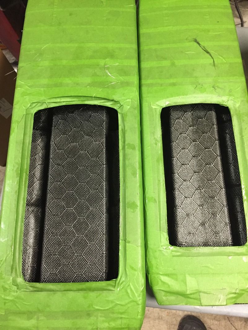

        My most unfavorite part. Sanding for an inlay. Ugh
        And inlay done

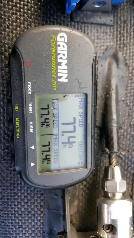

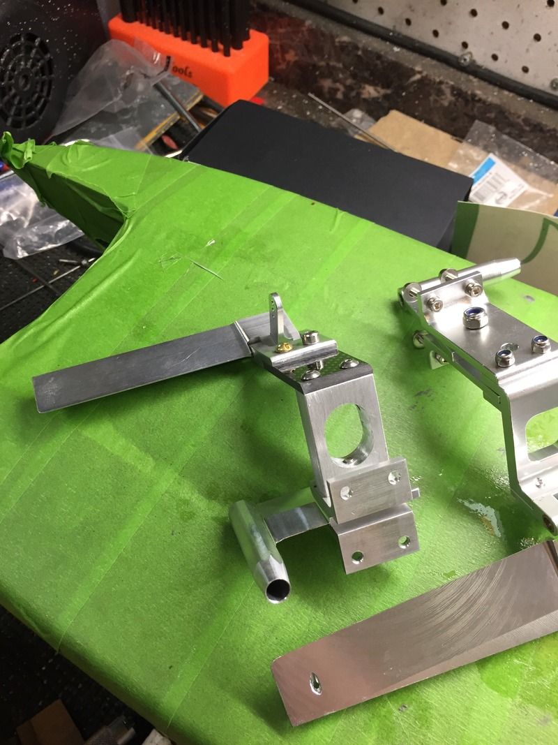

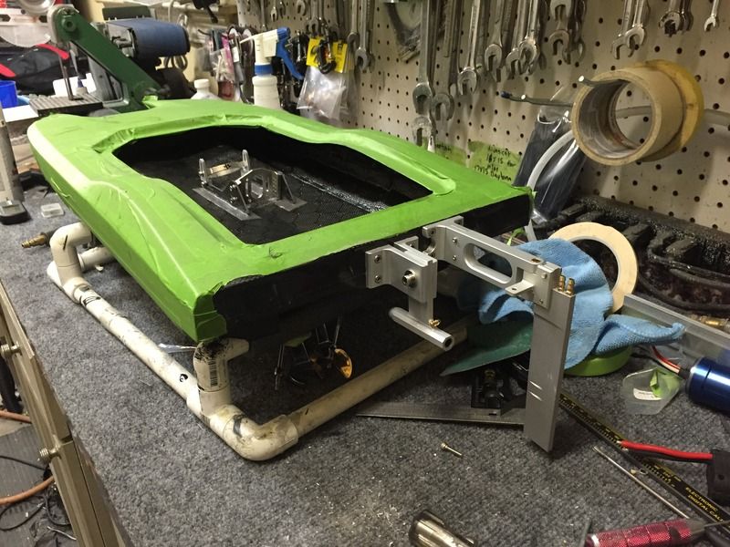

          Here's my hardware mounted up. I've come up with this combo of strut and rudder after much testing with other things. This boat is very wide and it does not work well with a short rudder. Blows over past 60 and it will spin around if you turn a little too sharp. This setup handles like its on rails and I've had this hull run almost 90mph

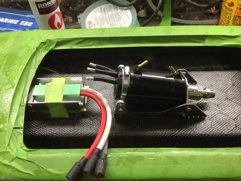

          Here's the basic layout. Very basic. Nothing special. Simple and functional.

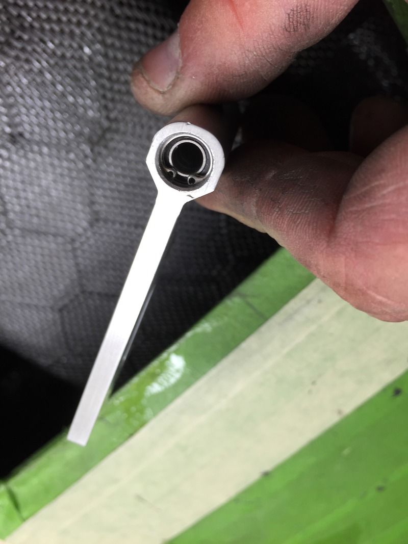

            Getting back to the bearing that popped out the strut. I've been loctiting them in. Been holding fine but when his popped out I decided it was time to make sure that don't happen again. I made a cutting tool for my lathe that would cut a tiny groove for it.

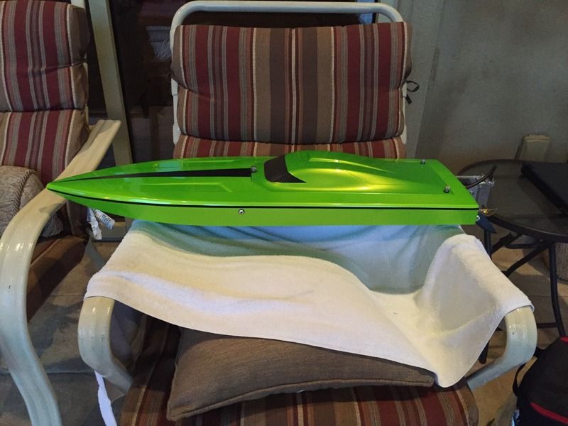

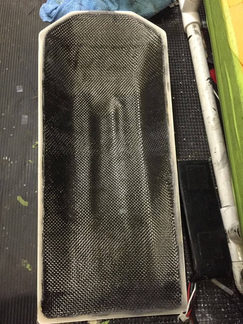

              This isn't a full build. I did a thread on it already but I crashed it the seam split I and forgot about it. Neu sent me a 2900kv 1530 (just had this happen again with a 1527) and I ran it on 6s and it flipped. I think the gps said like 92mph and it only flipped because it surged when I let off. The hatch Broke too. So after sitting for a few months I decided to repair it and give it to a friend of mine for his b day. I couldn't sell it like this and I don't have the time to sand it and fill the crack and repaint. So instead of it sitting or tossing in the trash, I repaired it and gave to him.

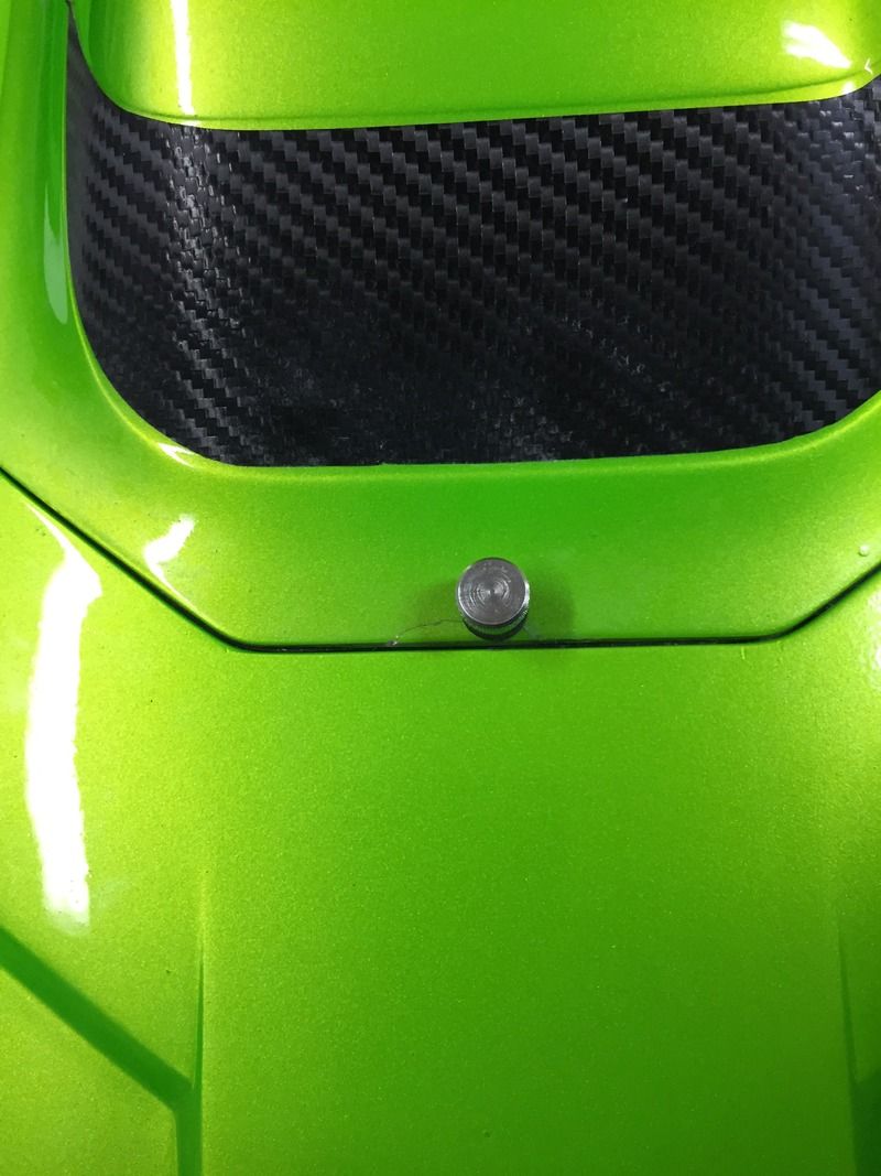

              Little crack. Broke my heart

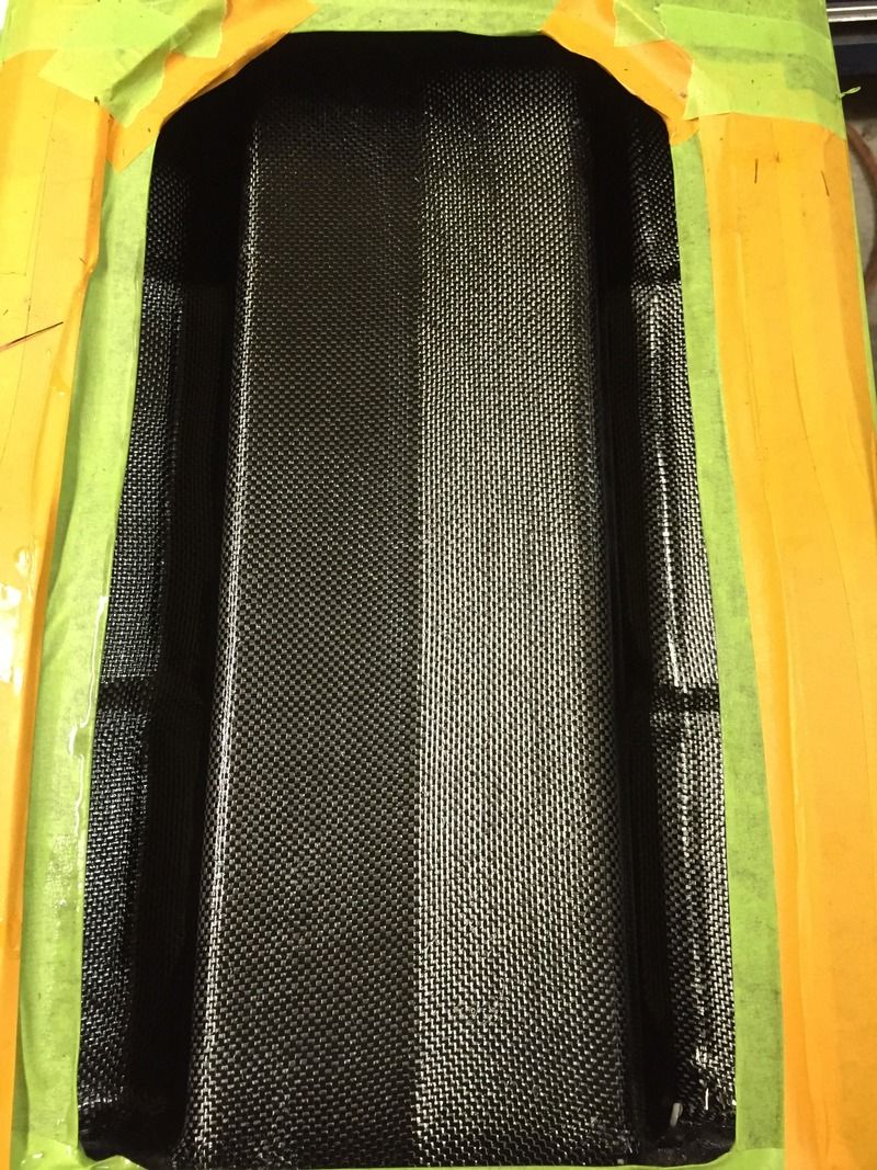

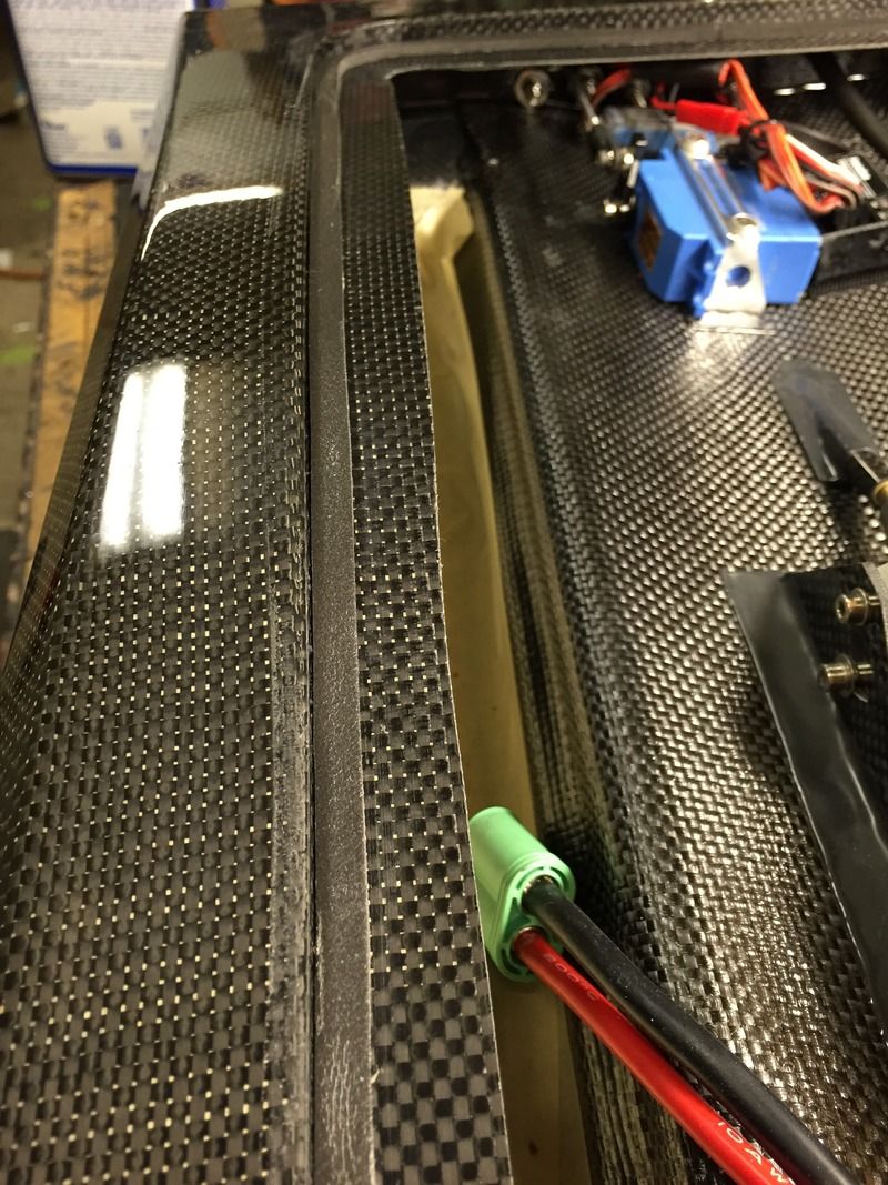

              I sanded the inside down real good and it got some west system epoxy with long stand chopped carbon. There was no flexing or creaking sounds afterwards when I grabbed the boat by the rails.
              Cracked hatch

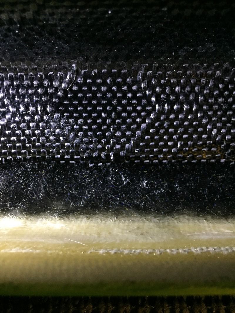

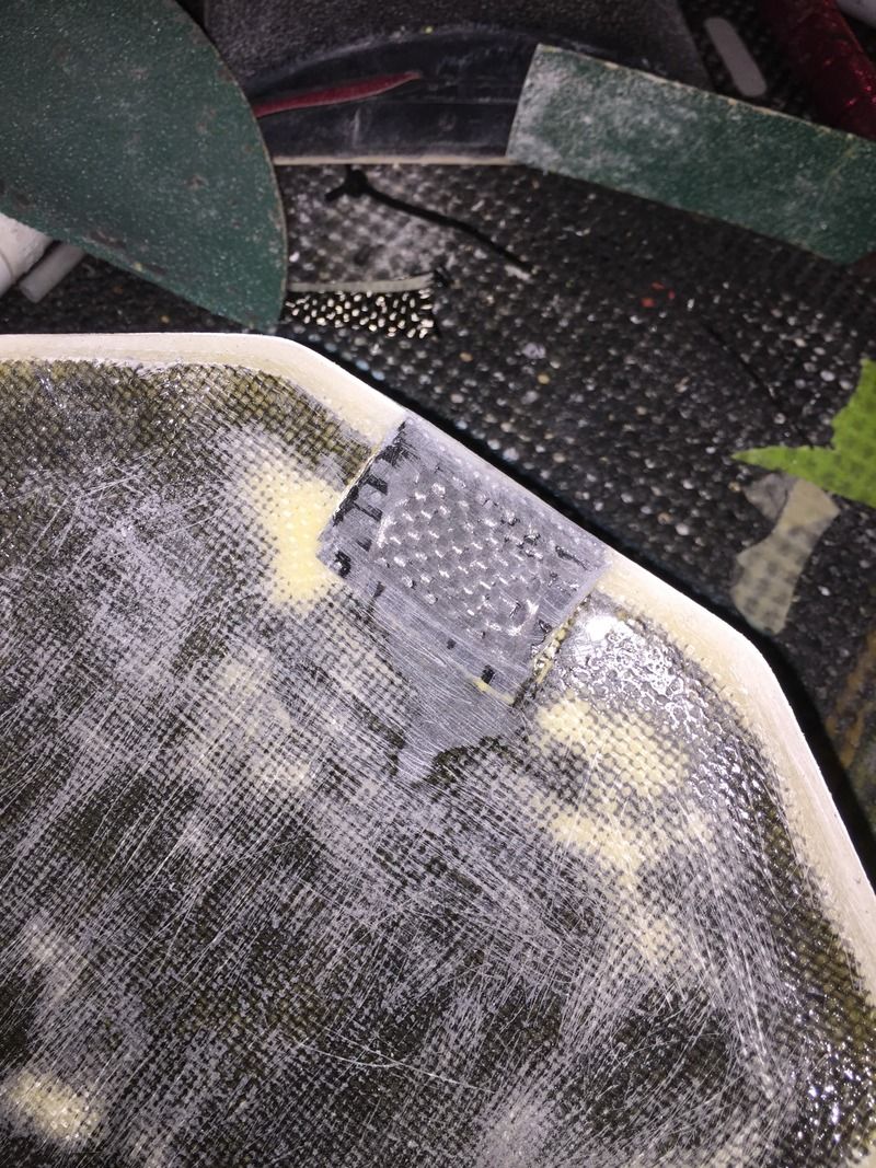

              Here's where I joined it back. I milled a square divot and put three layers of carbon.
              Then I did an inlay.

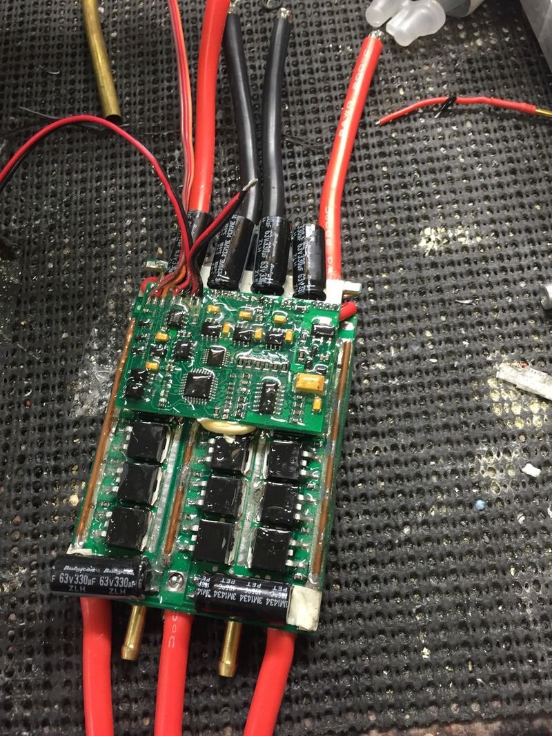

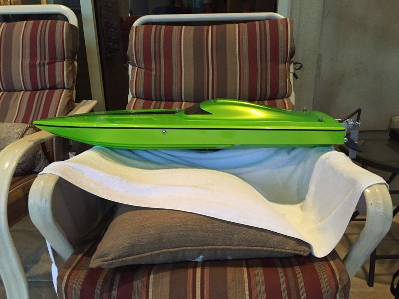

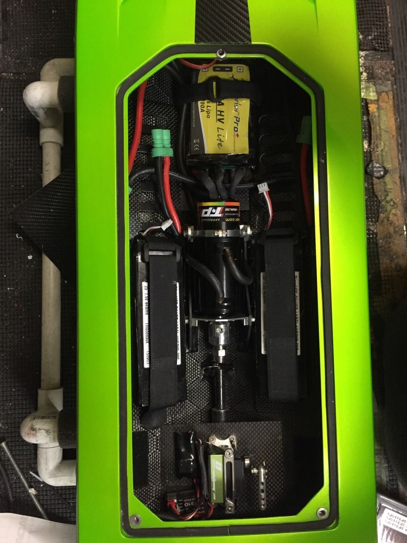

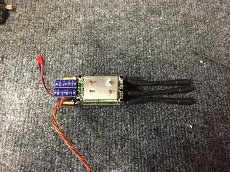

                My buddy sent me his esc and a motor to try in this green boat not knowing he was getting the boat. So first thing I did was cut the shrink off the esc and check for epoxy breaches in the circuit. Yep. Spots missing just like all the others so I lightly recoated it.
                Put it back together with a tp 4070 1770kv motor for some 6s action

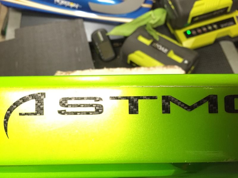

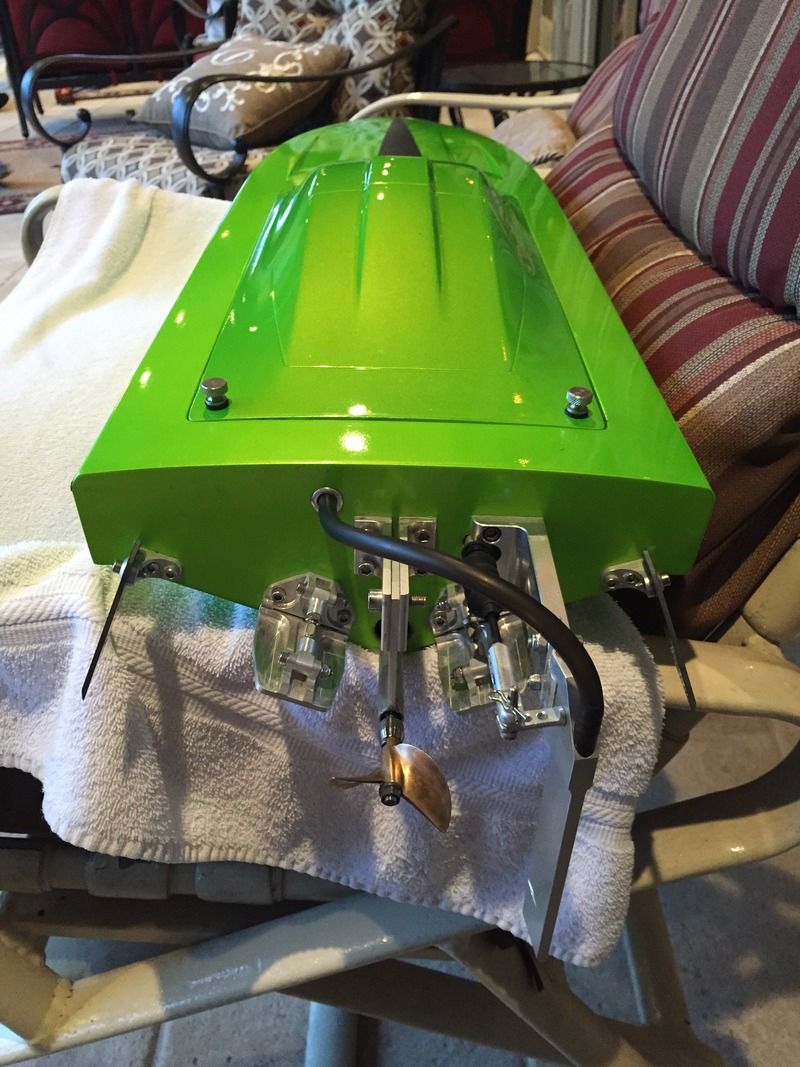

                  And seeing the cracks bothered me so I had to come up with something. Not to mention it was just to plain being all green (although the paint job and color is stunning!) and he couldn't have my beast mode decals (beastmode v2 coming soon). So I cut these decals by hand. Here it is upon delivery.

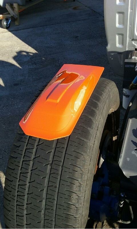

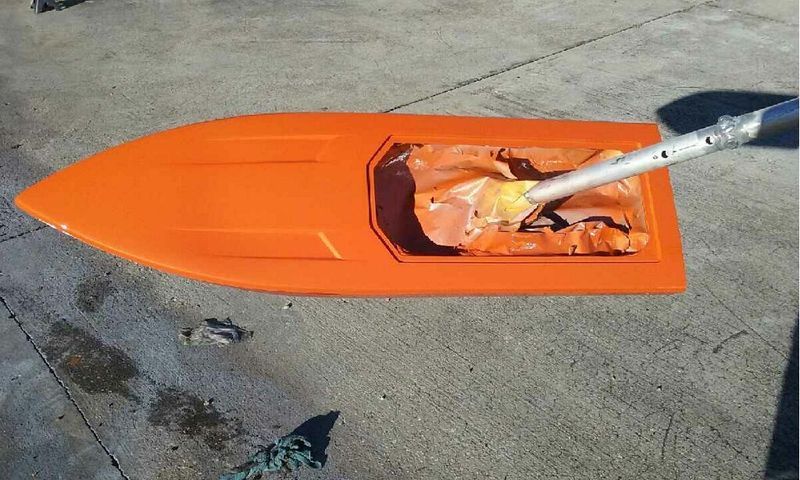

                    I won't bore you guys with another almost identical kbb34 build but, this one I just sent off for paint a couple weeks ago (I don't have time to paint much myself). I'll post more about it when it comes back but it's going to have a neu 1530 1500kv motor with a sf300 lite. Servo....not sure yet but I think radio post. Here's a pic I was sent today of it with the first coat of clear on it. That's tangelo pearl, house of kolor base coat

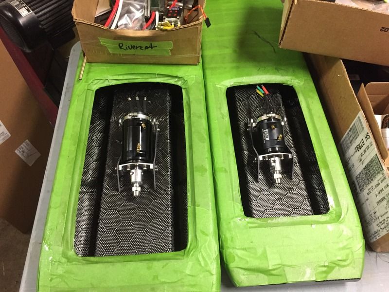

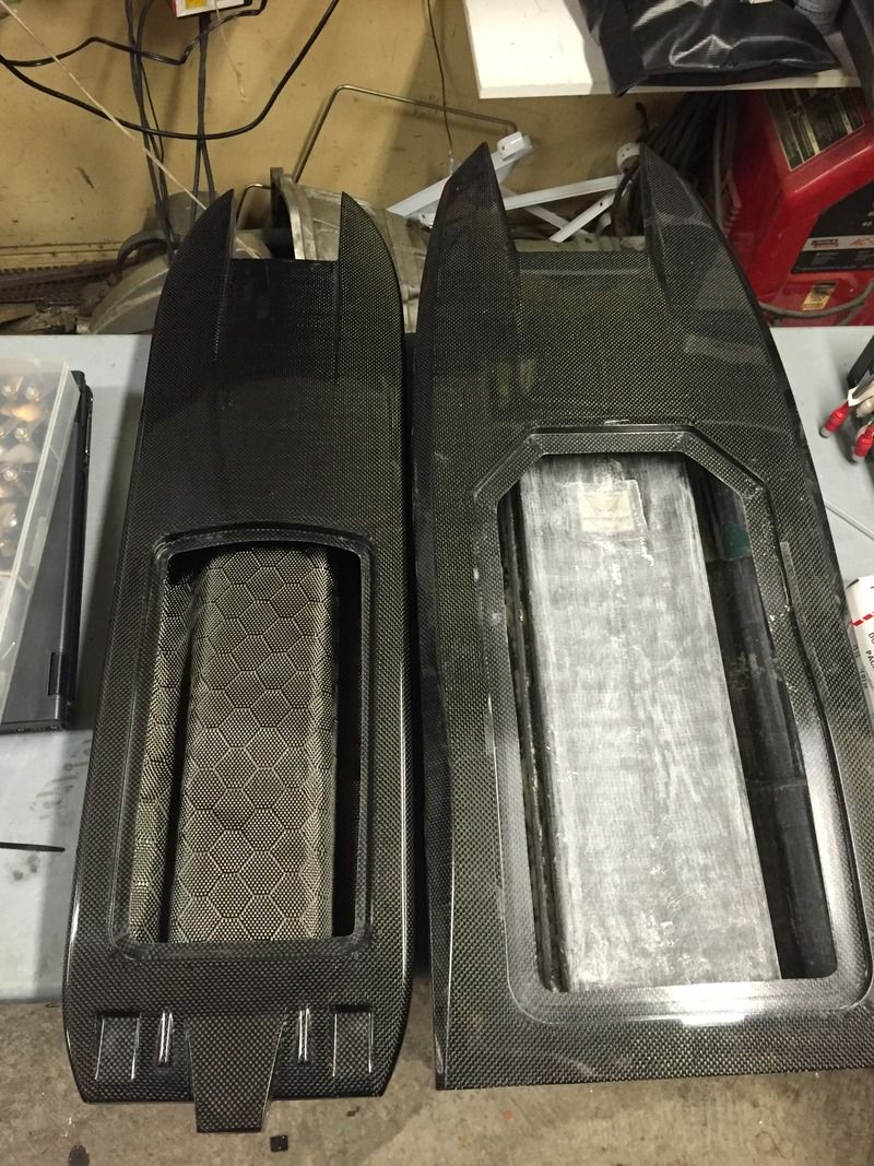

                        Ok. Now it's on to boats that are currently being built. Maybe I can log them better. This is a pair of siblings. My favorite little boats. 32" Rivercat and a 27" Rivercat. (Mini zonda whatever you wanna call it). I sank the 32" I had and sold my 27" to fund building a pair of these again. They will be build dang near identical except for electronics. I actually have two motors and escs for the 32" Rivercat. I plan on making some changes after my objective with it is done. So...

                        Here there are as I just started.
                          Oh, I like that color! Orange is my favorite, pearl is even nicer!
                          Thanks. I do really like that color. I had a quart of it so I talked my customer into it. Glad I did. It's gonna be a killer looking boat. We have some carbon decals planned. The carbon shoukd look really good on the orange.

                            Neu motor. Something like a 1521, I have a couple custom winds for it.
                            Mgm 25035 esc and a castle xl2 that's been water proofed and converted to water cooling much better than the ice series controllers
                            Kintec motor mount

                            Left handed hardware, speedmaster but modified. Any little effort to make the boat go straighter, the better. I know it may not make much difference but every little thing I do will count. Got some other ideas.
                            Motor mounts mocked up
                            Mocking for castle esc
                            Getting it all lined out

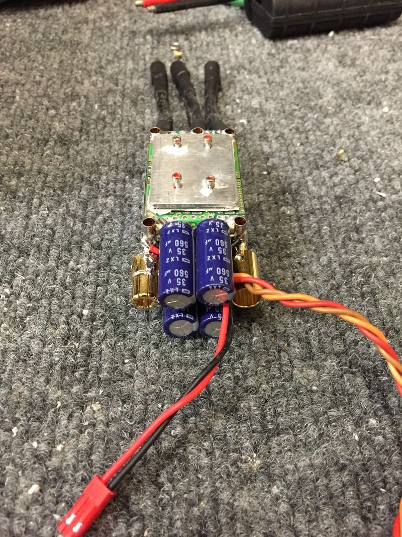

                              The wires looked raggedy on this mgm I have. Plus the shrink was messed up looking too. Never took one of these escs apart so in an effort to not screw up a $400 controller I had a burnt one that I kept as a paper weight and took it apart first. I learned that's there's nothing to it really to replace the shrink. I also want flexibility later on with the wiring in case I want to use it on something else. So I cut the wires off and left little nubs. Soldered on a male and female castle 8mm bullet. There are rated to 300 amps so I should be good. While its apart I added my little pig tail for a bec unit and I'm adding two smaller bullets so I can add a cap bank. I just like things clean and no wiring mess.
