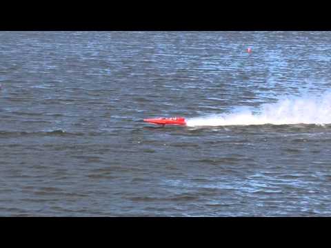

      Mike.
      Here's a bit more inspiration for you.
      We had another round of 1/8 scale racing on the weekend & here's Johns' Bud in its first race. The other boats have had a year of racing & tuning behind them already, so for the first race it showed that it is a good boat to drive. And I think he was being a bit conservative with it too. It only had a single test session, 2 weeks ago, before this race

        That was one of my kits? I would guess the 108 kit maybe? Looks like a lot of fun!

          You are spot on there Mike. It's the 108. If you go back to post #59 you will see some nice photos of it.
          And yes it is a lot of fun. I managed to take top honours for the day with your Lauterbach kit of the Miss America IV U-36.

            That is really impressive....and that boat looks great on the water. I think those 1/8 scales in the video have got a bit more speed than my Miss Elam that's for sure. At least it looks like it. Didn't really have the opportunity to be around the guys at the club much for testing and tuning. Hoping I get the chance this summer and see if I can get some good speed and performance out of her. It needs something, otherwise those other 1/8 scales are going to blow me out of the water. But maybe with a 20lb boat I can't expect much more...idk.
            Be really interesting to get some specifics on John's setup.....motor, ESC, batteries, prop info, approx. weight. Also info on the canopy parts, mock motor etc. Did John do all the main art work via painting or are those graphic inlays...like the gold etc. If they were all painted that is amazing work....This painting thing is an art that's for sure. But I'm learning...LOL Will have to do some major inquisitions on how he did that work.
            Mike...How is that 108 kit to build? We talking about Jigs etc. in order to build a nice straight boat? Dang...Looks like I'll have the 108 and the 310 to plan on this fall....LOL The 380 is still in prime only....still waiting on Jeff to send out the 380 graphics. If he doesn't send them out by today for the weekend I'll be looking for something else real quick this week so I can get this project done this weekend for the race coming up on the 24th of this month.

                    I'll tell you what I remember about Johns' Budweiser.
                    Motor is a TP Power 4060, 1030kv I think. Running on 8s1p spinning an X450 prop.
                    ESC is a Swordfish 240A HV
                    Both John & a friend of his painted the hull
                    Graphics are from Thunderboat Graphics.
                    Dummy engine from Classic Hydros.
                    But Hydroscale Creations also sell a resin engine kit.
                    Cowling from R/C Boat Company.
                    But Mike at ML Boatworks also makes a variety of cowlings, so check with him too.
                    Thanks for the congrats on the U-36. But the last race was handed to me when Darryl had trouble with the cowling & then flipped. But I'll take a win any way I can. The water was a bit choppy for a shovel running against a couple of pickles.

                      Your boat actually looked like it handled the rough water pretty well out there. A little bouncing around, but it stayed pretty stable. OF course like you said, sometimes you just take the win anyway you can...lol Happens with the real unlimited too!...lol
                      Thank so much for all the information on the Miss Bud. I'm still scratching my head trying to figure out the paint sequence on the hull and how the curves where painted....LOL If you ever talk to John maybe he wouldn't mind divulging his technique....LOL

                        Yeah. She's a good ol' boat. I ran a smaller prop for that last heat & it kept her a bit more settled than the previous two heats.
                        I'll probably see John this weekend, I'll ask him to email me over a spiel on the painting process, & I'll send it over to you. John doesn't get on these forums much, apart from a bit of reading. He should though. He has a lot to offer. DO YOU HEAR ME JOHN!!!
