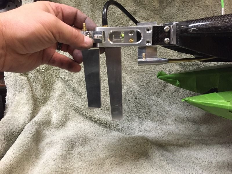

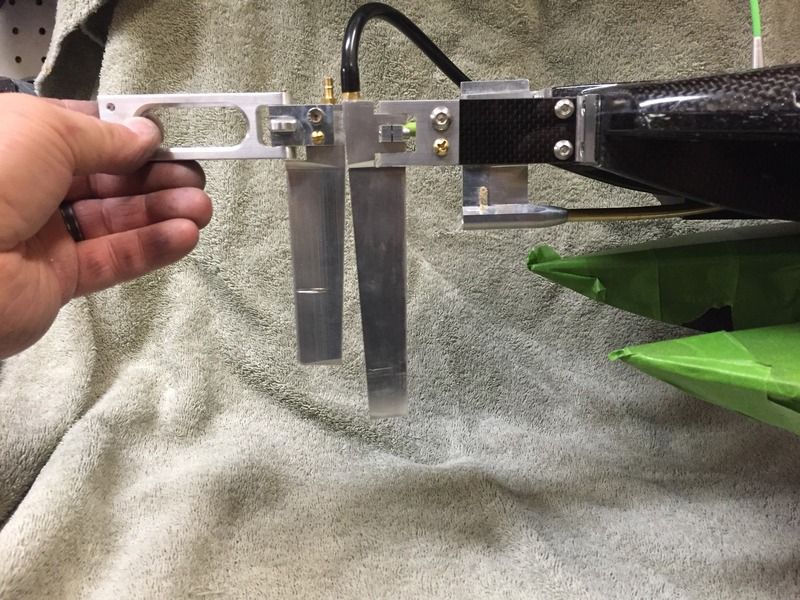

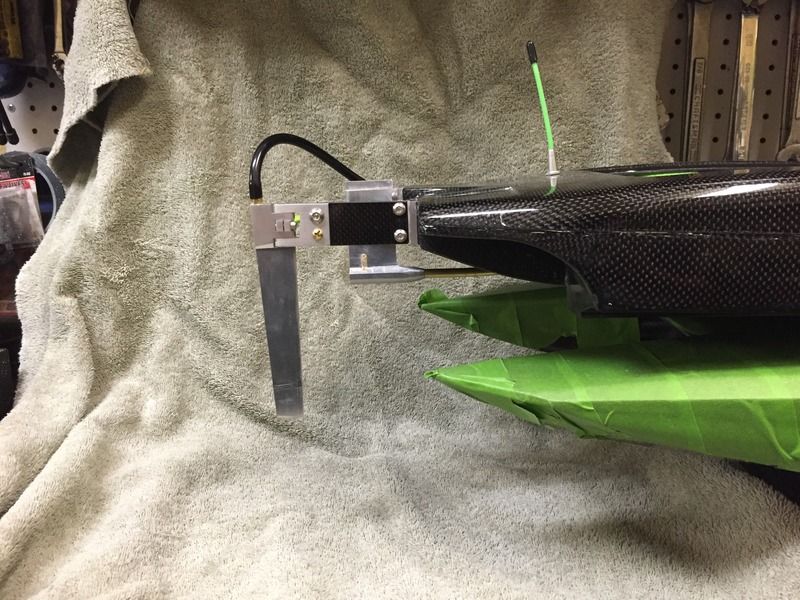

                  Had a busy night last night. Got the new rudder in. Little more work than I thought to make it fit but no problem. Also got some work done on the cheetah and started rewiring an mgm 25035 into a cleaner setup. I'm going to post a massive build thread here shortly on several boats that I haven't mentioned and some other stuff. So check it out when you can. Here's the rudder I put. 1" longer and a tad thicker. Should do what I'm wanting. I cut 3/4" off it too. The thing was loooong. Lol
                  I made a 3mm carbon bracket to join the transom bracket and rudder together. Stiff but a little more flex than what I like so I ended up sandwiching two 3mm pieces together (not shown). Ill test strength tonight. Don't like it, I'll keep at it till I do.
