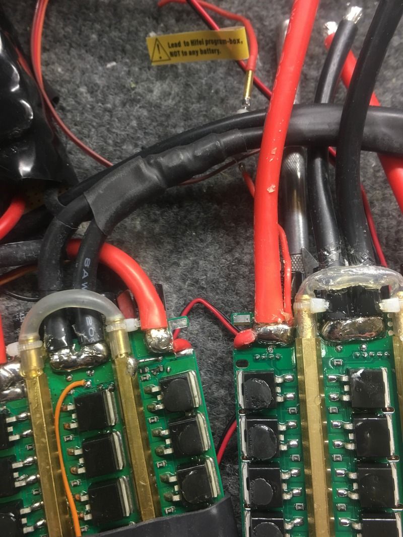

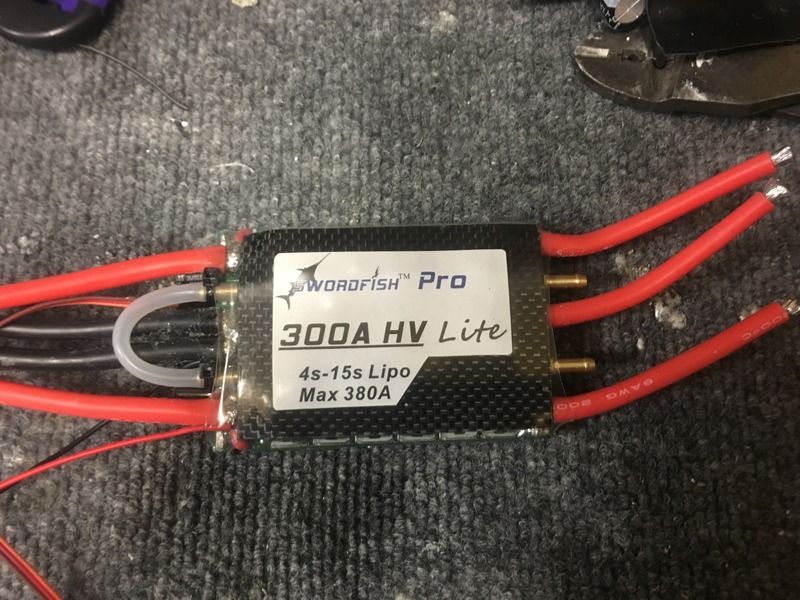

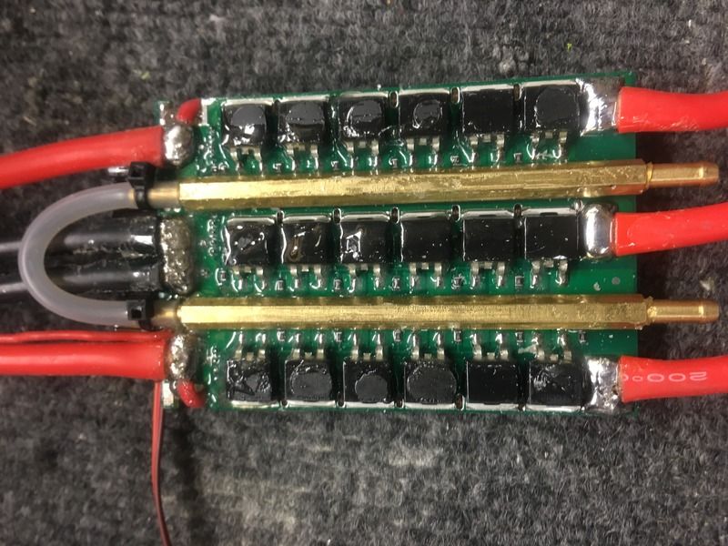

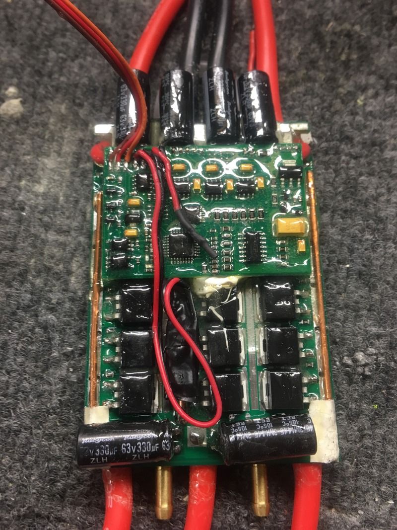

    I also got the esc almost done. I epoxy coated it because the last one got wet and (may) have caused it to fail. Better safe than sorry. My buddy got his wet yesterday and his went out too. So the coating that comes on then ain't worth a poo.
    Finished with clear shrink, insulated piece of Carbon (I have some very high heat tape that I made a layer between the carbon and esc just to be sure there's no short)
    Check this out tho. Had I not cut the shrink off, think thing would have failed in short order! It was kinked badly.
    Btw this was before I added the epoxy I did to it
    And here's a comparison to another normal one

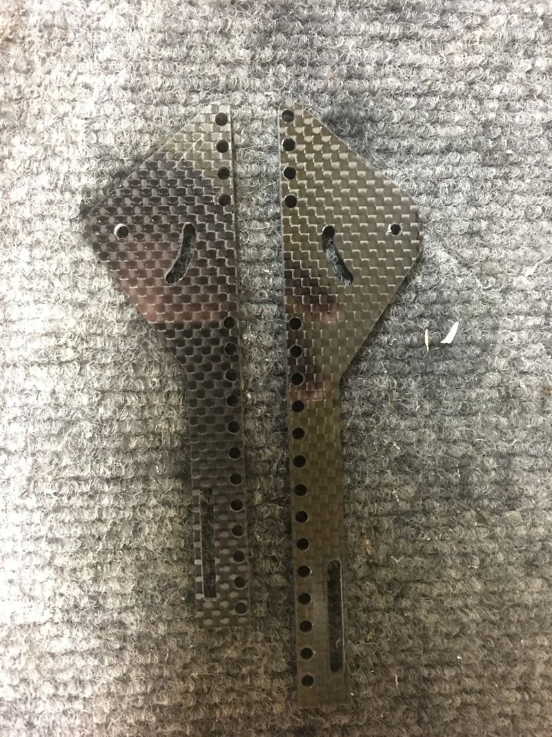

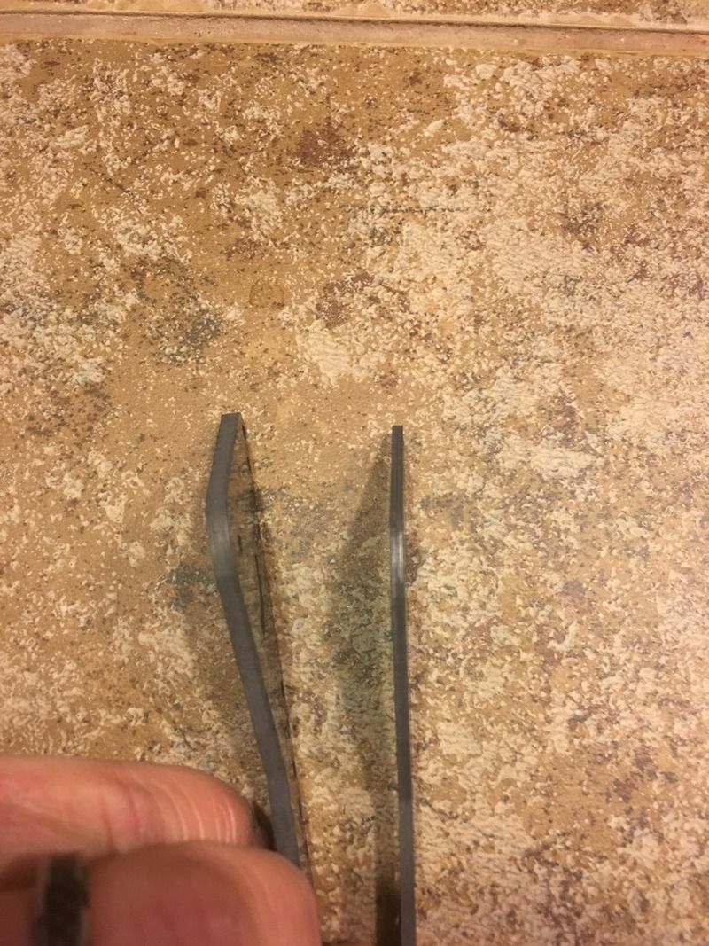

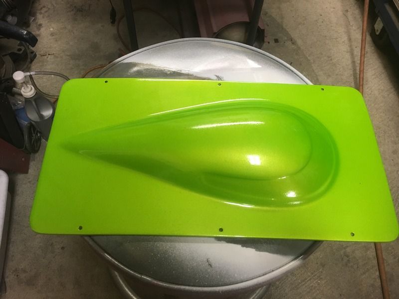

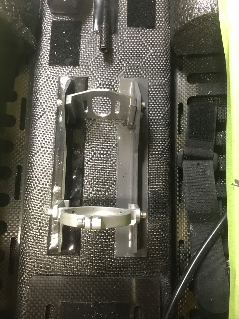

                    Well finally time to get this thing back together. My buddy Monojeff cut me some more side plates. For those of you that didn't read the whole thread, I had him make me some custom longer side plates for longer motors so they would be supported properly. With me doing that and I broke one on my last crash, I couldn't just order more from kintec. I did end up going one step further tho. They are normally cut out of 2mm plate but after seeing what can happen I decided to step it up to 3mm plate. Going to be a slow process if it's going to be done correctly but that's the only way I fly. I also rep are the top and repainted it. I had my buddy order some upol uv resistant clear in a spray can. Bout $22 for a can so I hope it's good......you tell me...
                    So here's the new mount compared to a regular one.
                    Here's the length difference

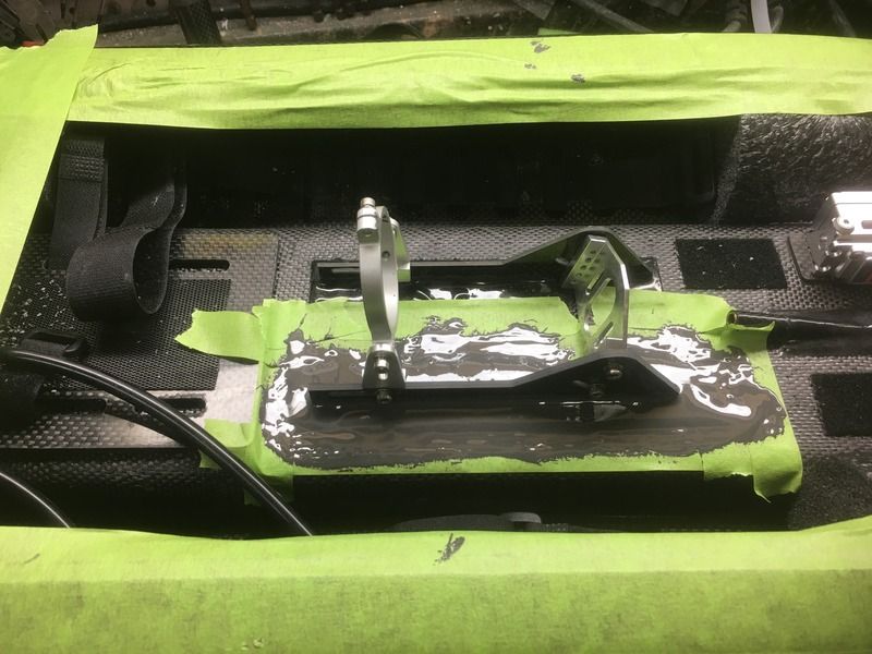

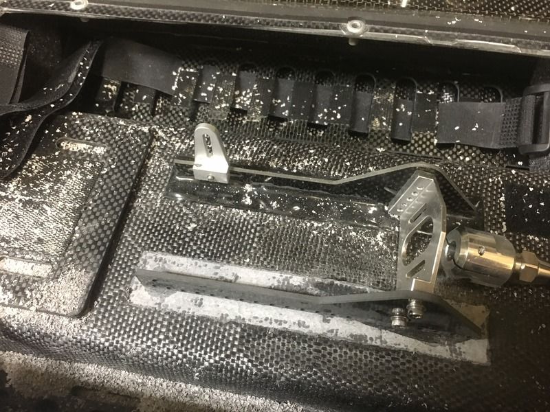

                    Time to get started. Gotta get the epoxy grinded out. Stray hand, air die grinder and a 5/16 ball burr
                    Mocking up

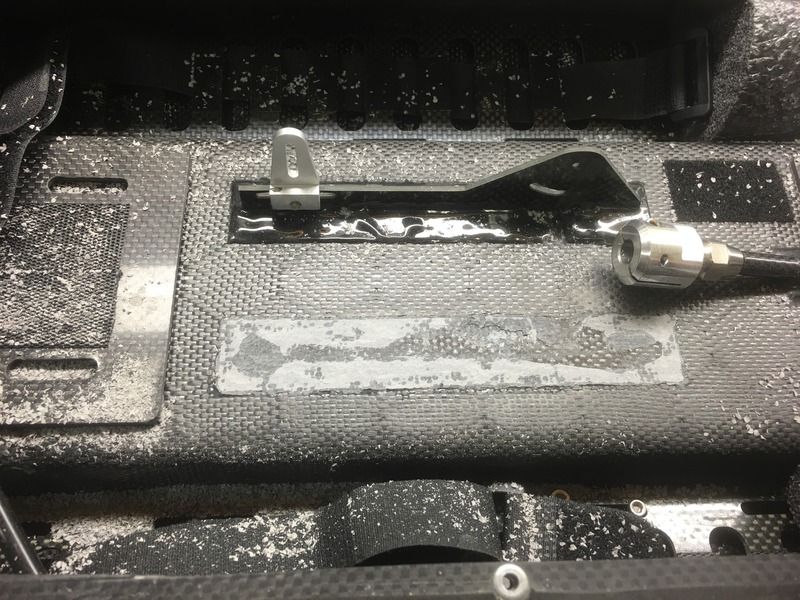

                    Here's the hatch after clear. It probably looks a tad better in the pic because it has a slightly dry spot but I'm going to wet sand and buff it. A dang insect flew in it too. Ugh.
                    But you cannot tell where it was broke!

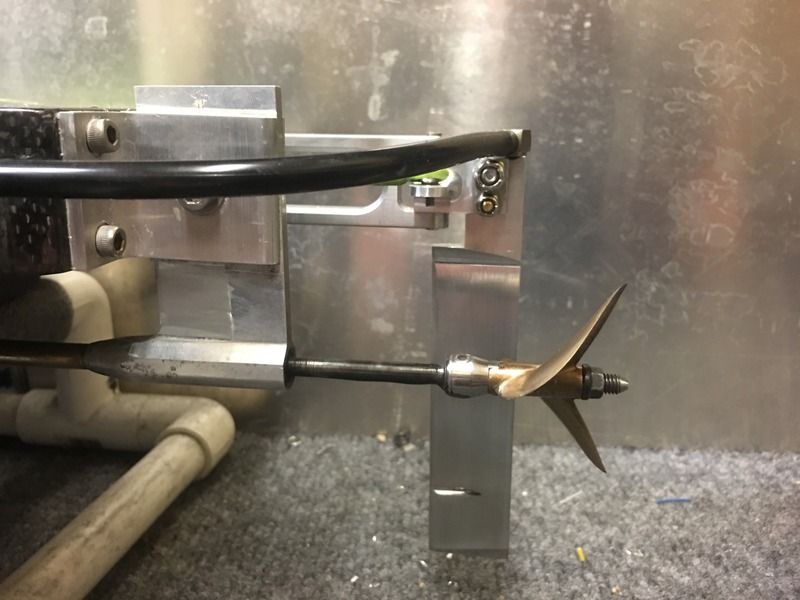

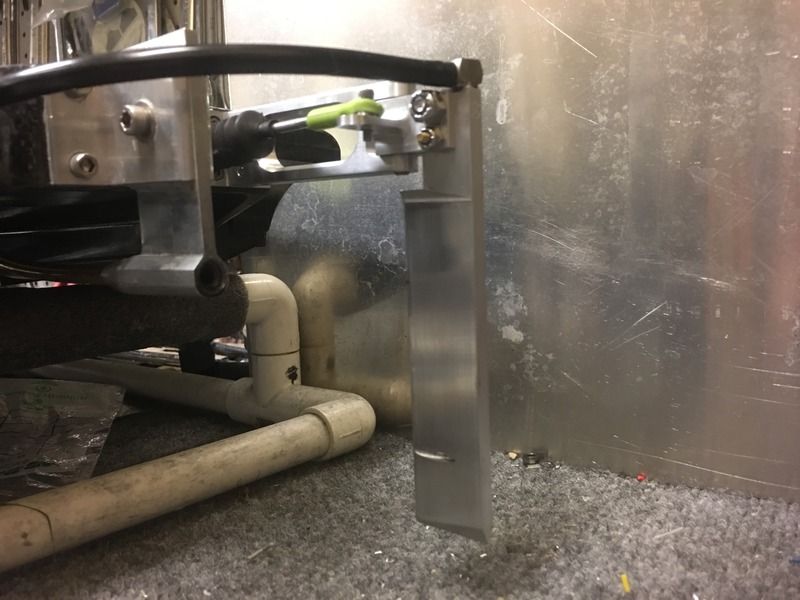

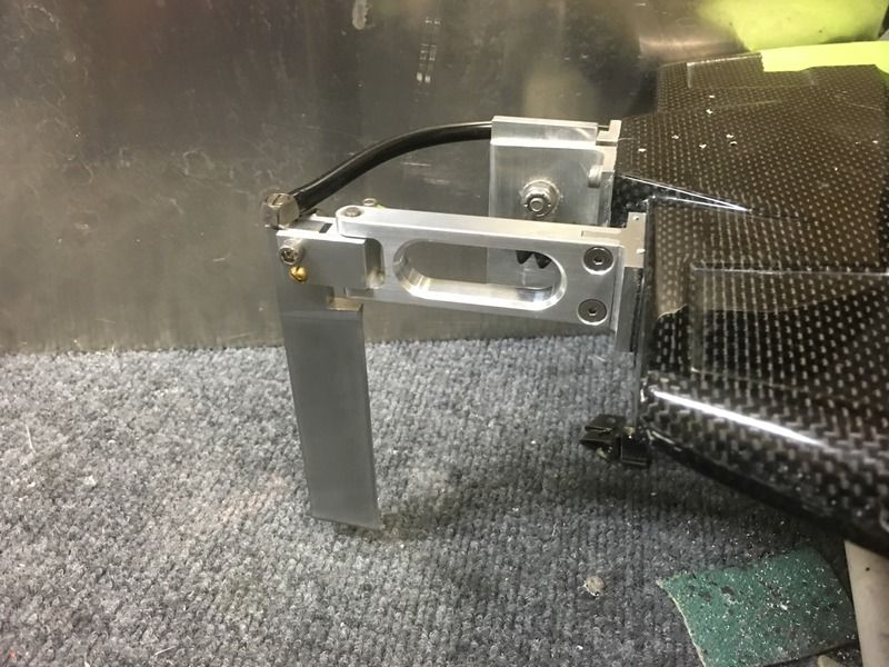

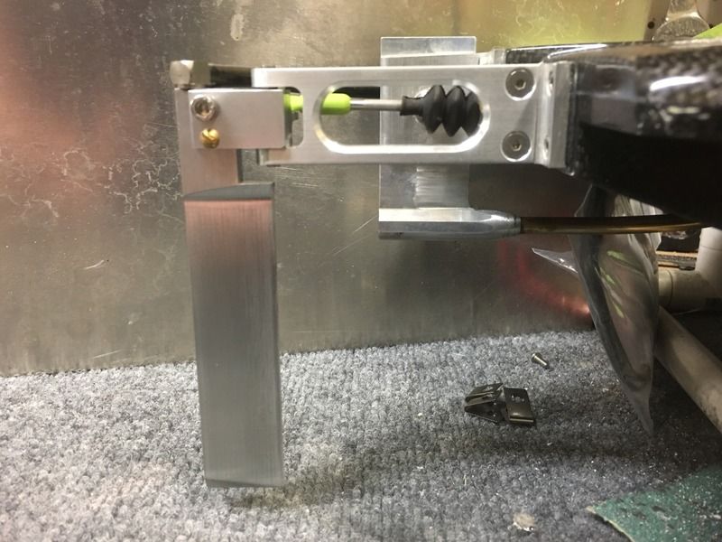

                        I almost forgot. I changed the rudder setup to a much nicer and better looking one. I had to put this together with the help of Harry at Speedmaster. I had to bush the control horn and ream the bushings a little. For now on he's gonna offer it to me put together for future builds. Sweet! Check it

                            Nice, I like the 90 on the rudder. I wonder if I can sneak that onto the dual feed on the BlownAway?
                            I have had the odd issue myself with the 2mm motor mount rails. That should be the cure Travis.

                              I'm sure they will fit. How close are the holes together on the rudder?
                              Yea I think I like this setup in 3mm a lot more and for now on they will all be 3mm. I've got a 34" mono I'll be building soon that will have them.

                                They are close, threading both in is just not gonna happen. I think it is fine how I have it .
                                So what do you think of the U-Pol? It is better when warm. Guess that doesn't matter much in Louisiana ;-)
