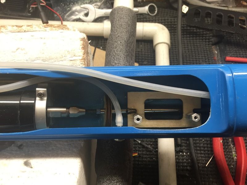

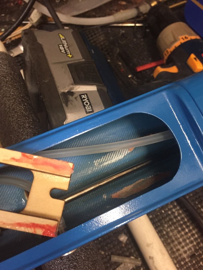

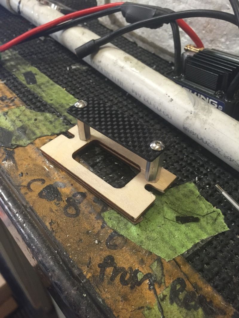

    Well sort of. My first time fooling with a rigger. I know this thing has been out for a couple years now but I never see anything on it. My impressions are it looks cool and is built pretty decent for an rtr. Pretty much genesis style with wood and stuff. The wiring and water hoses were a little bit of a mess. I couldn't get a battery in it. So I put it for sale last night. Then today I decided I'm not going to give up on it that easy. Figure id rearrange things and clean it up, "Travis" style haha. Anyway, servo didn't line up., with what I had anyways. Ugh. Ripped the mount out because I'm not a fan of a zip tie to hold a servo in. Then I opened up the opening a little in a couple areas so I can get a battery in and the servo. Bench tested it and after a couple throttle blips the motor mount detached. Lol Guess it wasn't glued in well. Lol. No problem. I expect these sort of things in an rtr anyway. I didn't like the slack that a "z" bend in the steering rod gives so I made my own steering rod with a ball end. The rudder had more slack than anything I've seen before. I have some titanium rod just the rod size. Cut a piece and slack gone. Also the hatch had no floatation so I glued a piece of foam to it.

    Ripped out mount
    New one. Well modified what I had.
    Glued in
      Motor mount detached

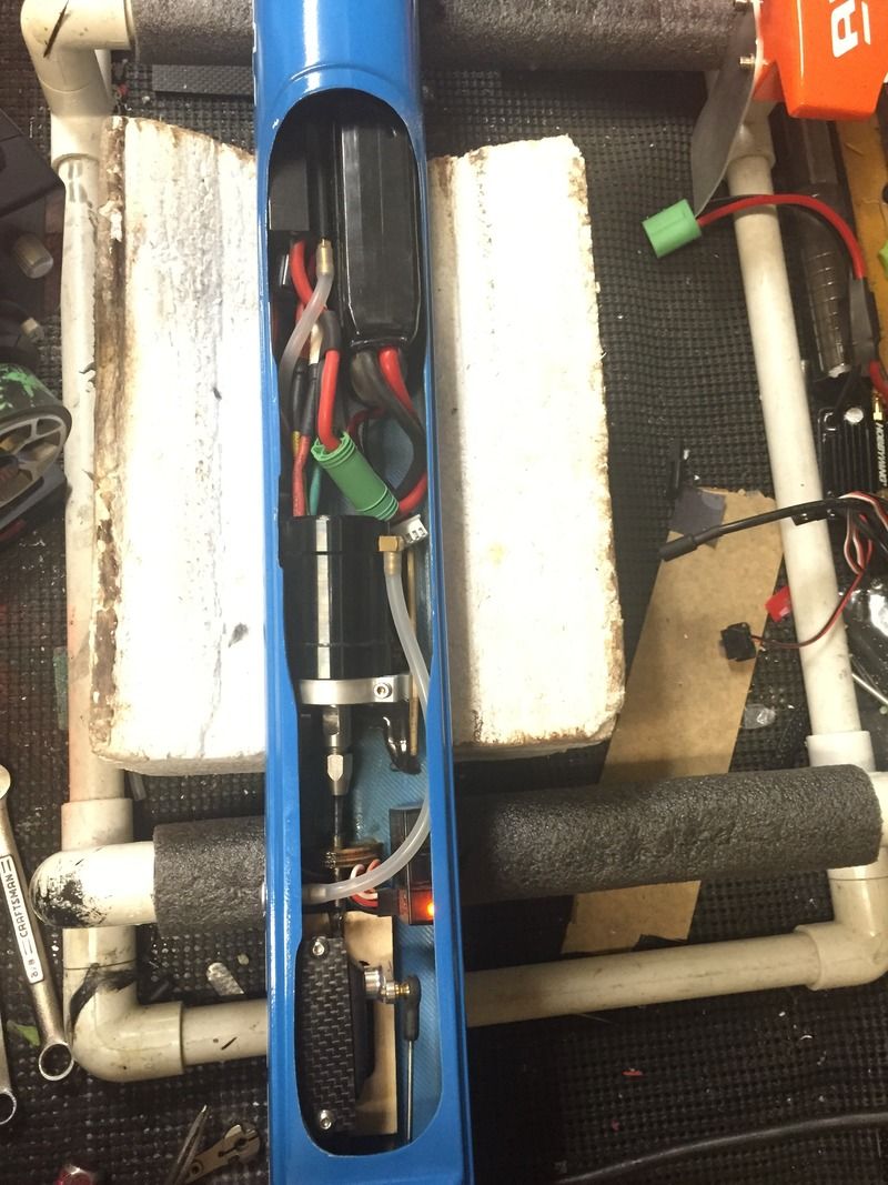

      Glued it back in with jb quick but forgot a pic of it. Here's the completed layout.
      And with battery. Yes that's a 3s 5500mah lmao
        I also would like any pointers with tuning this thing. I've got the mechanical part taken care of now. I feel the boat is solid and put together well. No slack in rudder or linkage. I hope to get some decent speed out of it. This came with a x435 prop which I just finished s/b. I plan on ordering a abc 38mm for it. I'm not sure if I should start on 2s or 3s.
