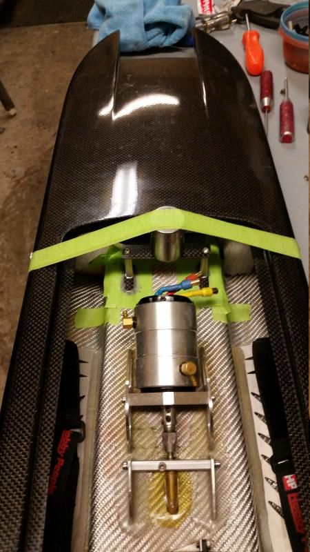

    Okay, stripped the boat of all the wood mounts other than the motor mounts. I will have to install my new motor mount back a little so the canopy doesnt hit the top of the motor. I think the esc will then fit in front....I think. That was just sitting on the bare hull to.

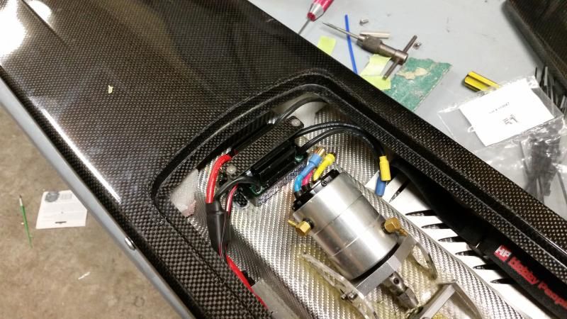

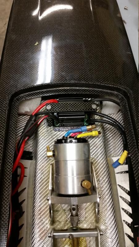

          if the 180 doesn't fit, your options are to go with the swordfish 220A which is now smaller than the old version, about half the height of the seaking 180. Or you can shave off a bit from your 180 plastic base to gain a few mm of clearance (not really worth it). Your carbon will add around 1mm overall (use a foam roller too).
            Make yourself a mount like this. This is a carbon apparition

              Alright, thanks alot kfxguy. So I got the Apparition stock mounts cleaned up a little more and did a little staging. With the configuration below the canopy will close and I will fabricate a esc mount like yours. Going to have to move the stuff tube hole back to. Not sure how im going to do that. I took a picture so you guys could see what im working with. Thanks for your help. IMG_20150829_000034.jpg

                Not sure why the picture is side ways, couldnt get it to ulload correctly.
                  Good deal. Just slot it and cover it with epoxy. Masking tape on one side to keep it from falling through
