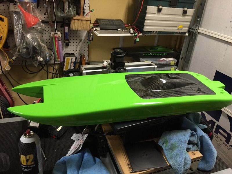

        Here's a pic of the hull. The whole idea was to use carbon sticker that say Rivercat and a Fightercat head to match the carbon top. I have the stickers that will be included
