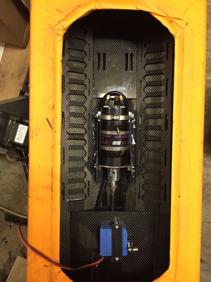

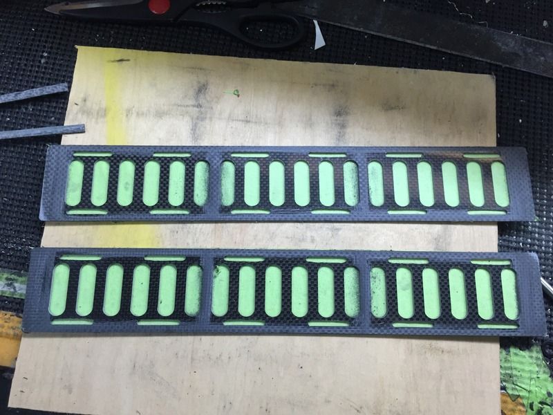

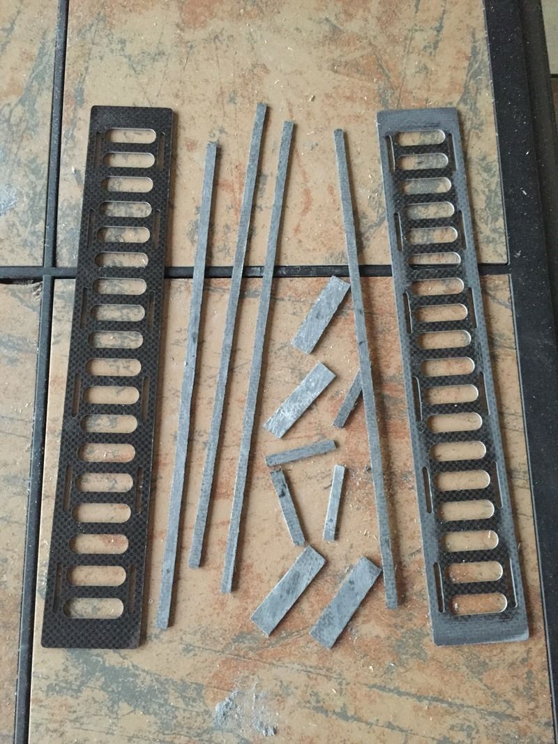

            Got the slots cut in the battery trays. I was going to just use the little tabs that come with the trays and loop the straps around the tray like it was meant to be......but me being myself I just couldn't do that. I had to do it my way of course. Lol. I cut carbon strips that go the full perimeter around the tray and two center points. May be a little overboard but I'd rather them not come out.
            And a pic how it sits right now. Waiting on the epoxy to dry on the rear deck plate and the battery tray tabs.

                Got the battery trays in. What a pita! To do it nearly I had to epoxy the spacers to the trays, let them cure. Then with the bleed out I got epoxy on the front of the trays. I masked them off on the front but the epoxy still bled through. I used west systems there. I also had to re-mill the slots from the bleed out and also trim excess epoxy. That was two days gone there. I ordered some faster hardener so next time I don't have to wait as long. Had to put a light coat on the face of the trays because I had to sand the epoxy that got on them. Not too happy that happened but live and learn I suppose. Then I had to sand thin lines (bout 1/4" wide) in all areas of contact, wasn't easy gettin in there. I then used some 30 minute hobby shop epoxy (I use this on all my trays and never let me down yet) mixed with some black epoxy dye and some epoxy thickener made by west systems also. Almost like a peanut butter consistency. When I stuck the trays, they didn't move. Good stuff. Tomorrow I'll pour the foam. I haven't decided on a color yet. I was thinking about a pearl white. I also have a very good looking orange. I'm no painter so it'll have to be simple. Ideas?

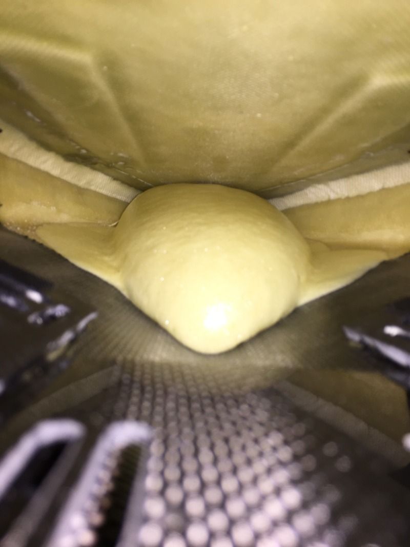

                      Foam is done. Soldered in the cap bank. Block sanded the transom so the bottom edge is sharp as can be. Had to add another short "shelf" made of carbon to Velcro the cap bank to do it doesn't flop around. Trim tab holes are drilled but I came to a snafu I didn't think about. You see cats don't have trim tabs so I forgot about them up to this point. The receiver/servo plate gets in the way of me getting to the nuts to screw the tabs on. So now I have to get creative.

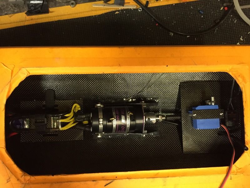

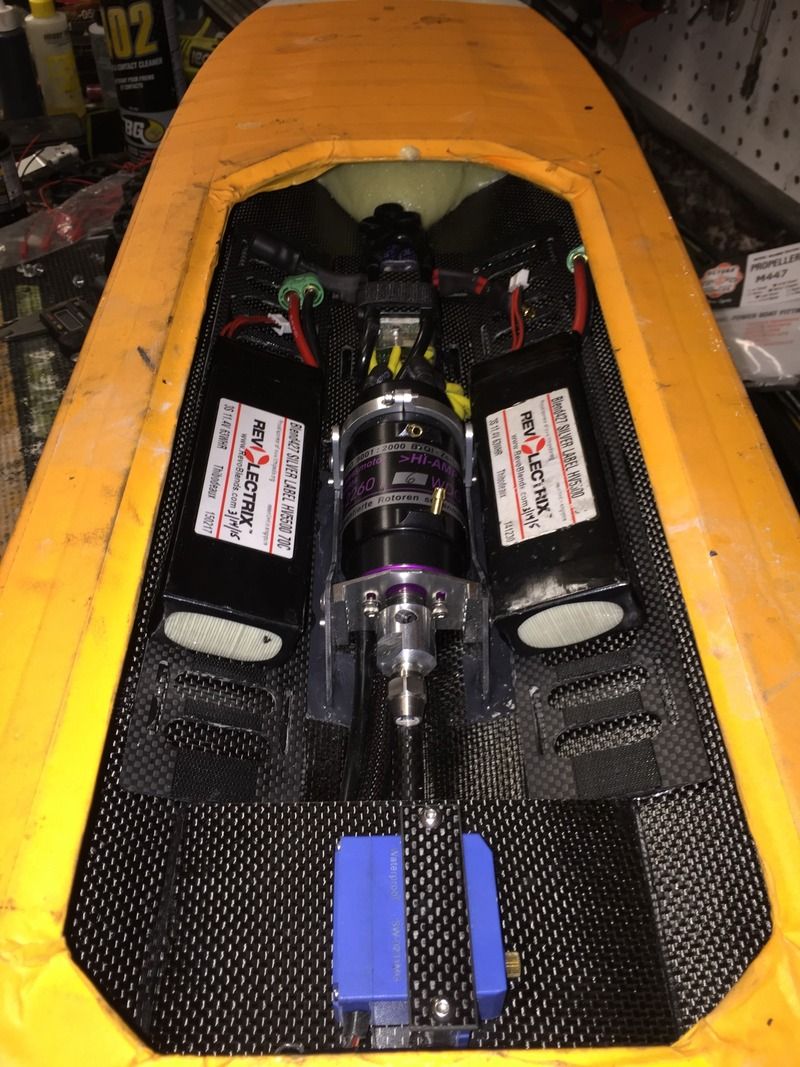

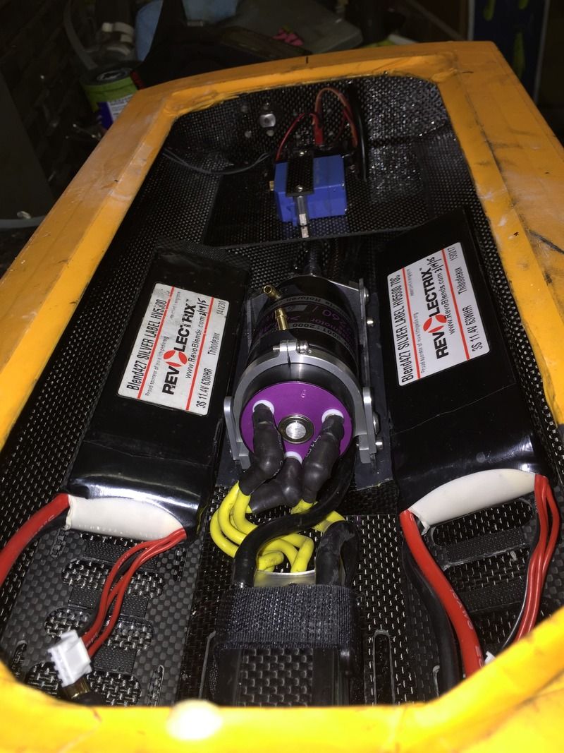

                              Because I am impatient and a night owl I decided to go back out in the shop and make up my wire harness for the bec and the esc extension and put the esc, receiver and Bec in.

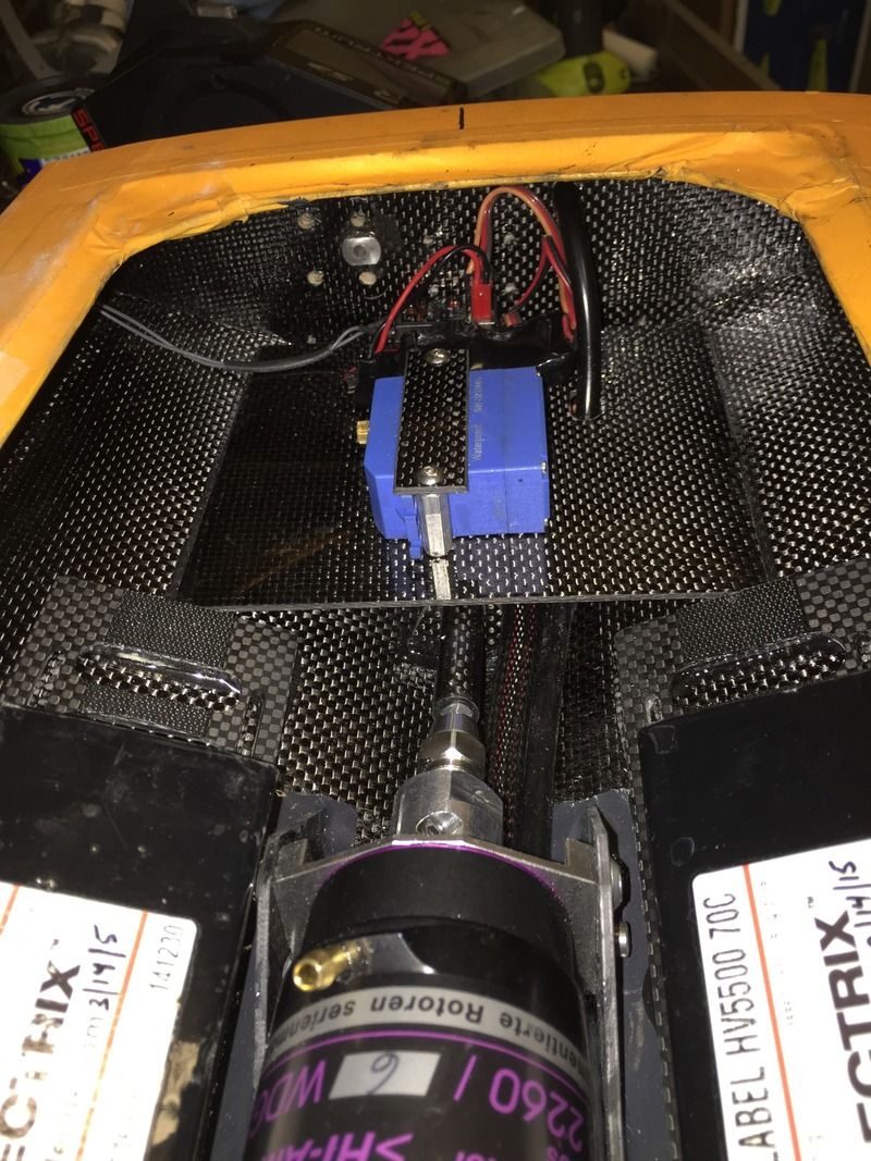

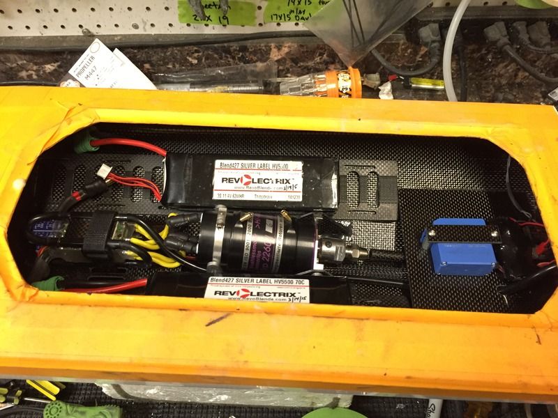

                                And one more
