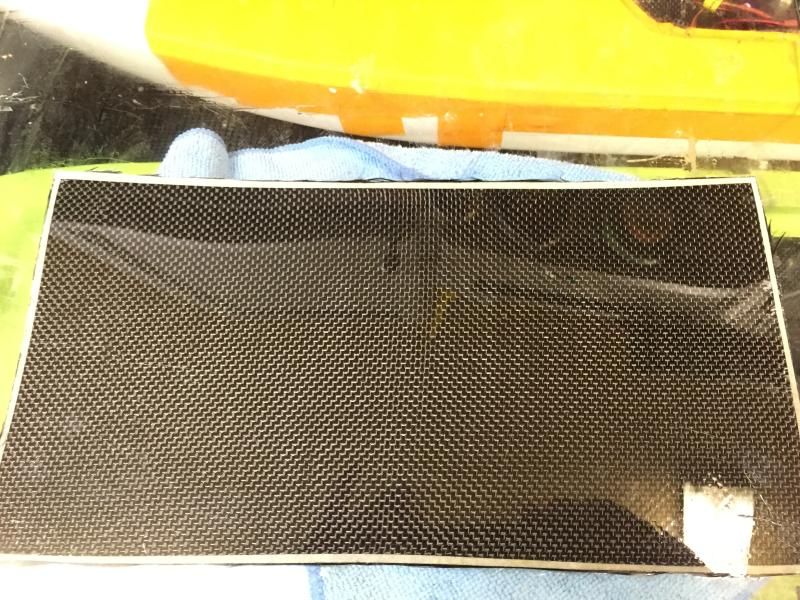

    -overall I'm pretty pleased with the results. I layed up a single layer last night and with no bagging or pressure on it, I was able to squeegee the excess epoxy out and make a nice piece. I'll post a pic of it later.

        Here's a single layer I made. Very flexible. .013 thick. I'll use this for motor coolers.
        Here's the side that wasn't againt the glass. Still looks good tho.

            All I know is I was never able to make a sheet of carbon that looked so good so easily. I'm hooked lol. I can't wait to try a multi later piece. I have to get a new piece of glass first. The one I used has scratches on it and my good piece got broken last night.
