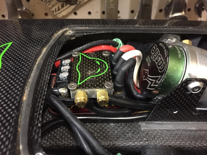

    Wires. Messy and all over the place. The cooling lines are right in the way.

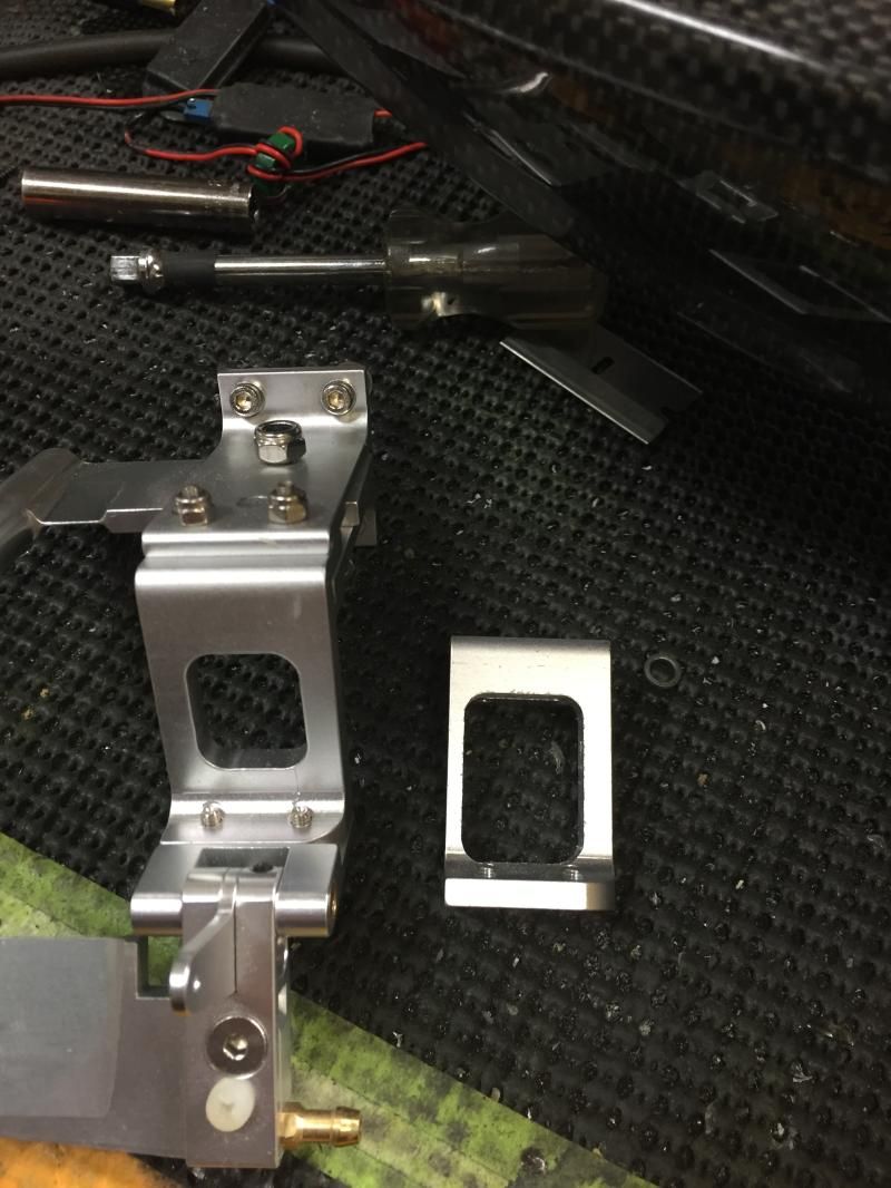

    Rudder offset. It's originally a inline setup. The bracket is too long and just didn't look right. I'm going to replace it with the right stuff. While I'm at it I'll mill out the linkage pass through hole in it to cut down drag at low speeds.
    Cooling lines. Like I said they are I the way. I'm going to replace them with nicer but thinner lines and reroute for a cleaner look. I also got rid of the through transom fitting in favour of a through hull ring that the hose slides through. It eliminates two house connections. I also moved the exit fitting to the middle side of the boat instead of the rear. I used a ul1 drain plug to fill the hole that was in the transom. Also makes it to where I don't have two hoses going to the rear.
    Motor. It's a finned version castle. I don't like the look of it off the cooling jacket. I'll shave the fins off, polish and put a nicer jacket on.
    Receiver. It's right in the way where I'd like to have a gps. I'll move it and figure something on hiding the wires.

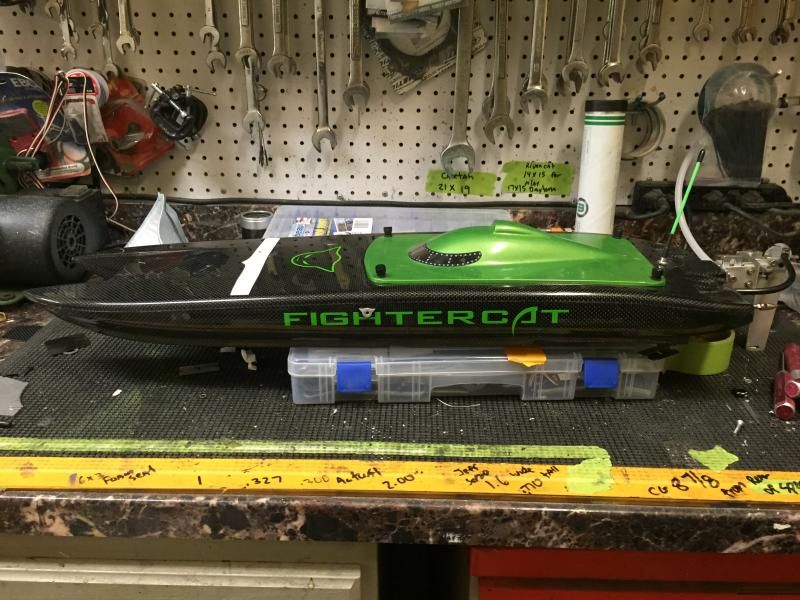

    Hers some before pictures. I'll post some after pictures one I start putting it back together.
    And another rear pic.

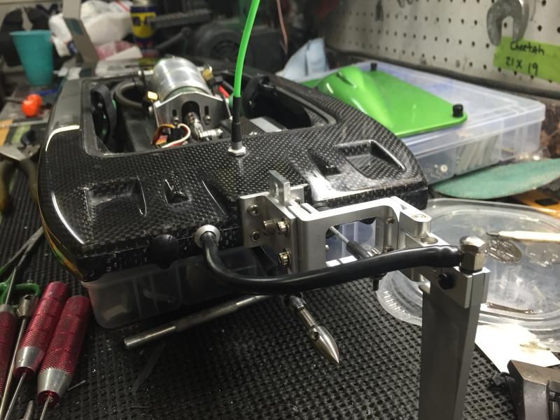

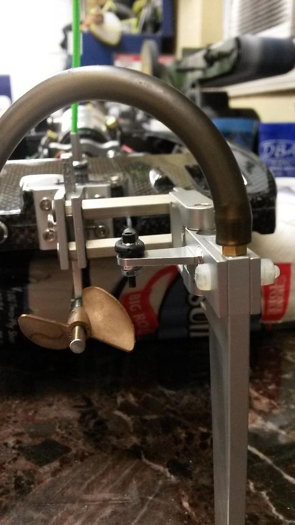

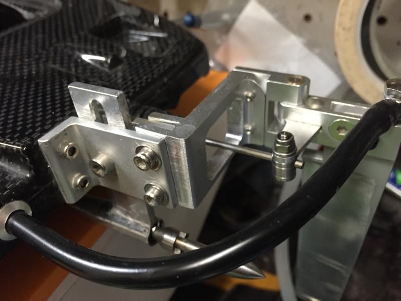

      Got a few things done and need some opinions. Here's the rudder offset I changed to.
      And notice the through hull ring now. Muuuuuuuch easier to run hose though this than to try and fit it on a nipple and put a wire tie on it so it don't pop off. Makes me agitated just thinking about it!
      And notice the little 90 degree swivel for the rudder hose. Did the same on my 32" Rivercat. Like that little touch. Guess it looks sleeker.

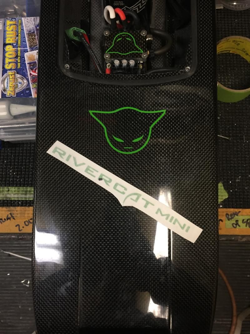

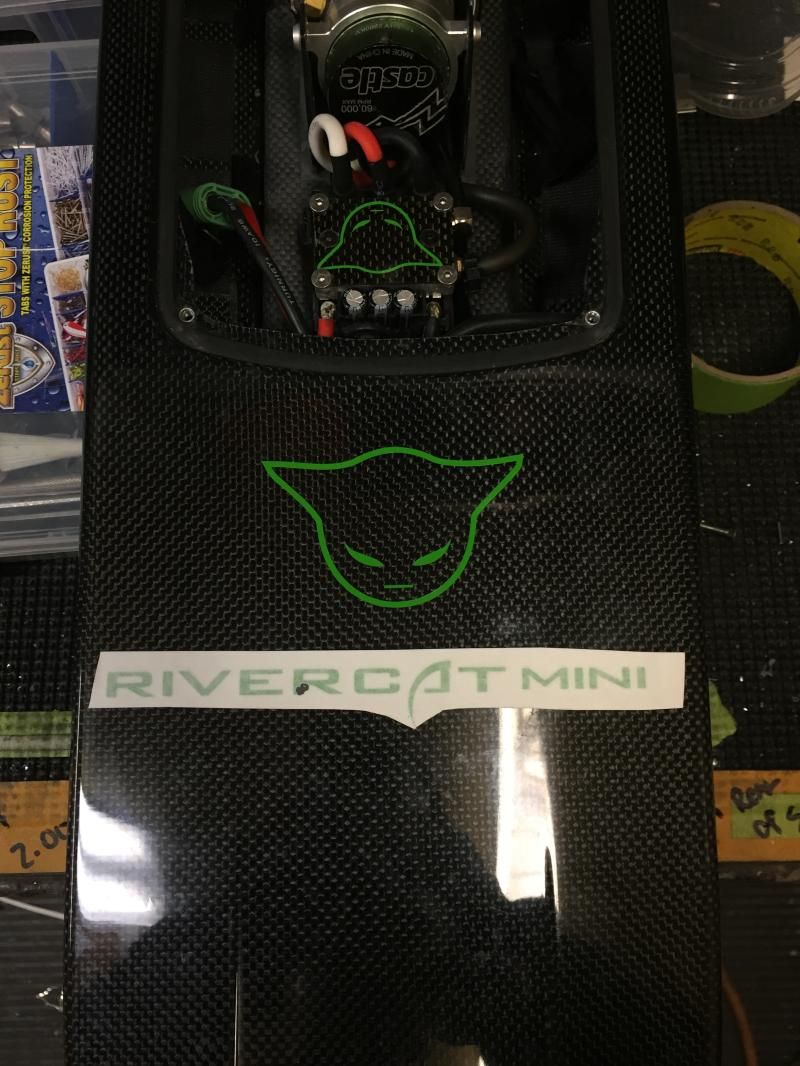

        Now here's where I need some feedback. I'm not too much for painting a carbon hull. Call me boring, I just like the carbon look. I like to put a little color on it I guess, so it gets some simple decals. Should I put the "Rivercat mini" obit straight, at an angle or none at all?

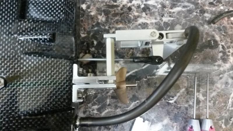

          I milled out the offset bracket to cut down drag while it's not on plane. Seems to pull a little one way because of it. Untouched one for comparison.

            The rivercat sticker looks strange diagonal unless the cat decal were placed diagonal too
            Go straight

              On the offset, it looks like there isn't much meat left? No concerns?
                Go straight
                Gotcha. Thx
                  It's a thick version. I didn't really take any from the top, widened it and thinned the bottom a good bit.

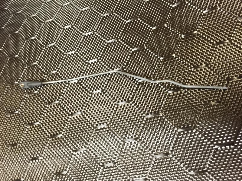

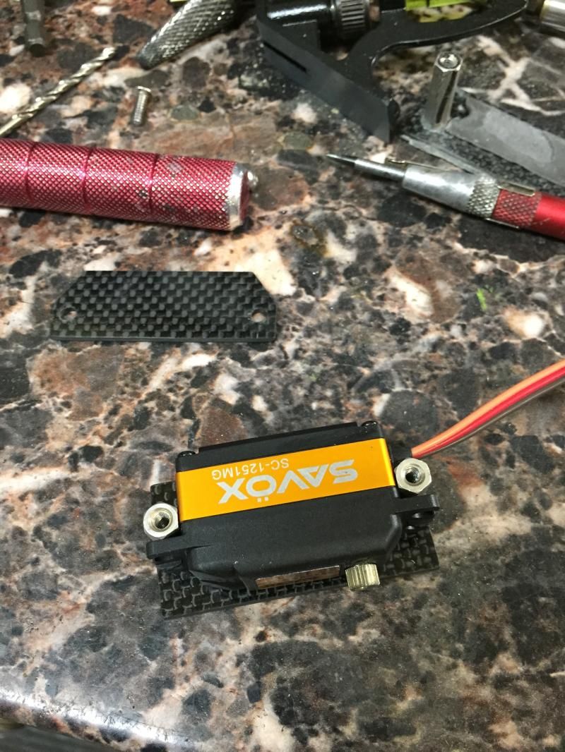

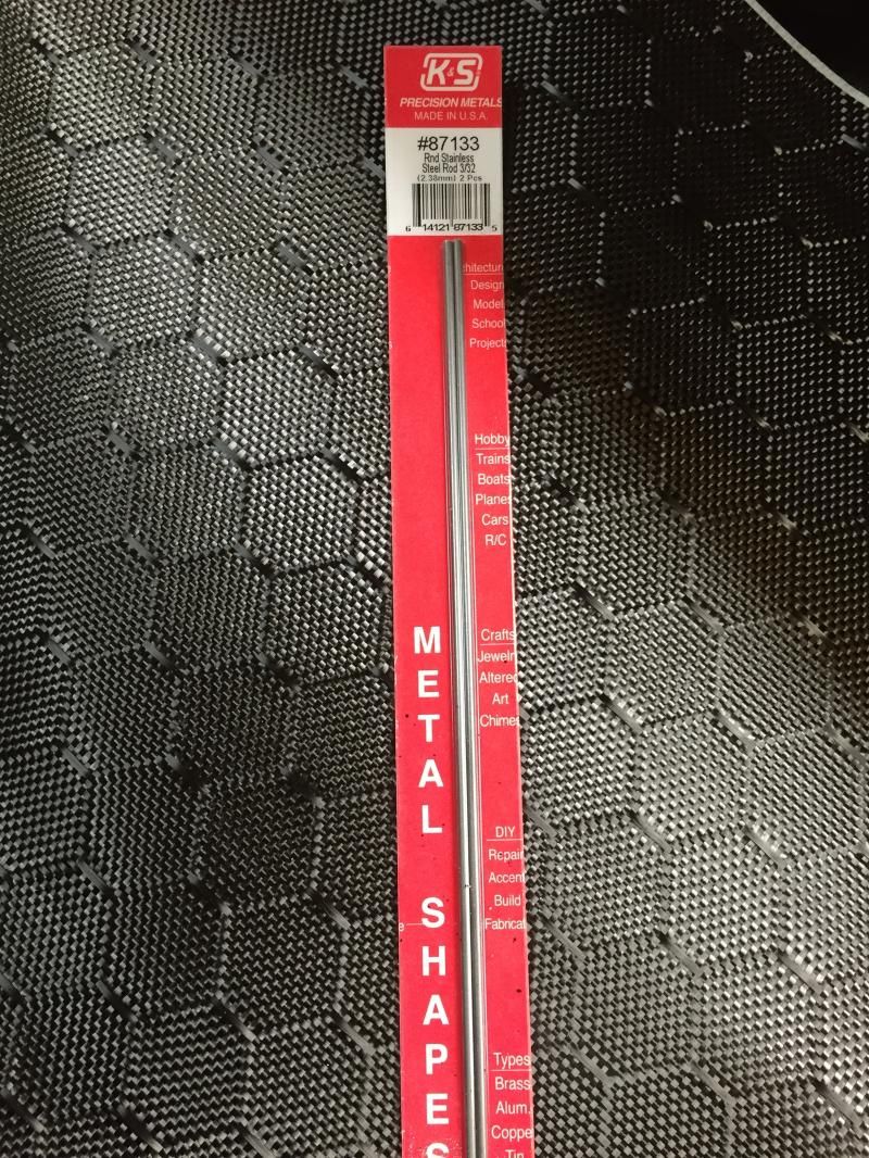

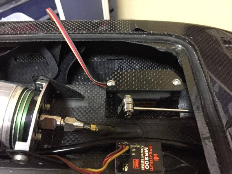

                      I received some more items in today (finally!) to get more of this rebuild done. The servo, steering rods and water fittings came in. I chose a strong little short savox servo to replace the spectrum miss geico servo it had. It was slow, and wasn't quite strong enough. I went up put the savox it and it was a tab wider. Dang. So I pulled the mount out and made another one, nicer this time. I also decided the spaghetti sterring rod just wasn't gonna cut it. It was corroded and starting to rust anyway so I replaced it with a muuuuuuch stronger stainless rod. Very hard to bend. I'll be using these rods in future builds for sure. I repositioned the servo and remade the rod with much less bends. Turned out much better. Boat should drive Better now with no slack.
                      Junk steering rod I had:
                      New servo and mount
                      Stainless rod I used.
                        Installed. Look how much better and stronger the steering rod looks

                        Next I'm gonna shave the fins off the motor and put a lighter, better looking cooling jacket on. This will take some higher locted weight off. I always try to make things light up high and heavier down low. Helps to keep the boat planted (my theory anyway) and helps the boat live up to the name "cat" so when it flips it lands right side up. Sounded good anyway lol.

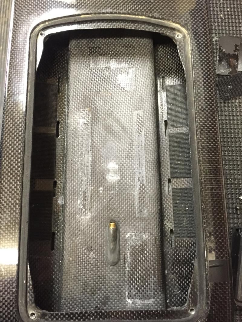

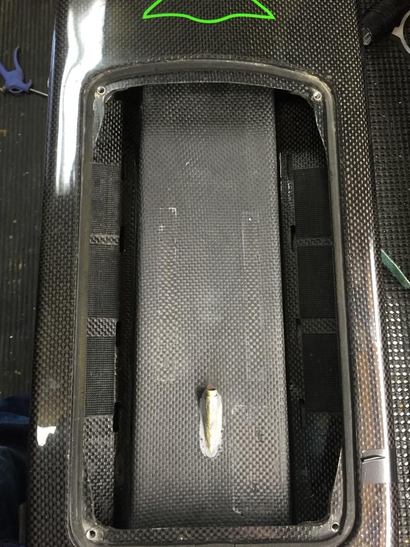

                          Well I decided to rip it all out and start over. Omg it was a pain to get the motor mounts out. At least I know they were in good! I'm basically gonna sand it and revolt the carbon. It seems like it was done too dry. Figured I might as well fix it right.
                          And after sanded and cleaned. I already did the epoxy too. It's setting up right now.

                              I know I know. I've got quite a few irons in the fire right now. I really wanted to run an mbp collet and the way things were, it wasn't going to fit no matter what. I'm changing the motor mount to a kintec slider mount also. It's definately going to be nicer, it really deserves it. This is a sweet little boat. The stuffing tube epoxy will be redone too. Stay tuned, letting epoxy cure.
