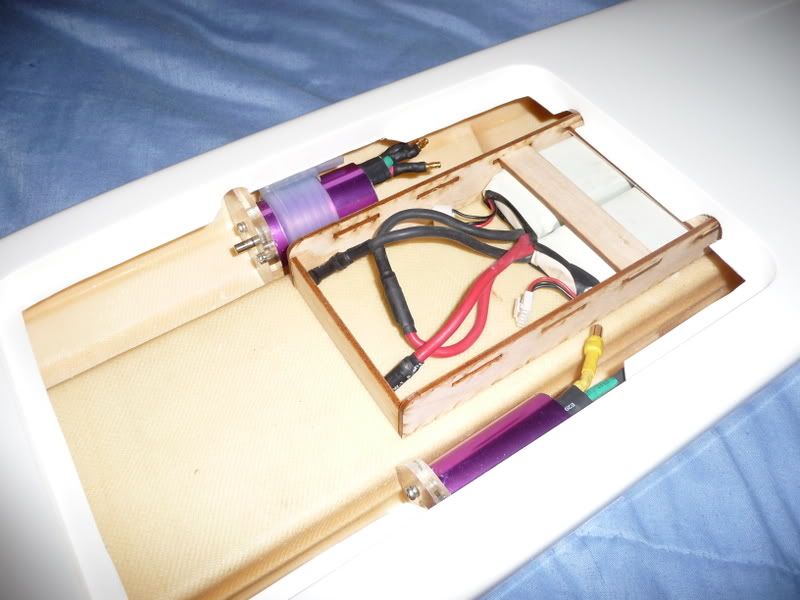

    think i got enough?
    1512 1D for my 26 inch whiplash no idea on the prop... Darin can you tell me what u ran?
    and twin 6L's for my kitty.

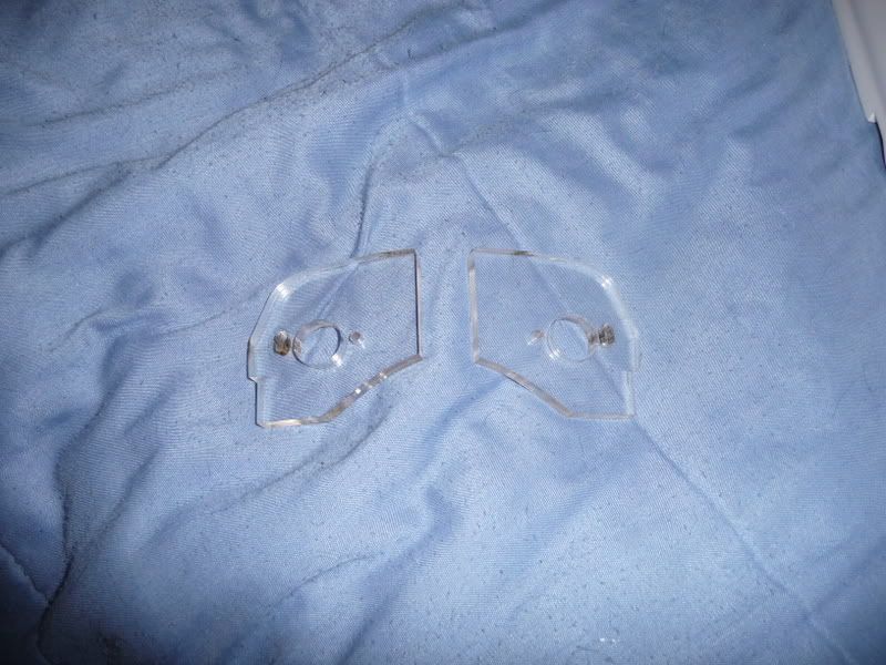

    Taylor do you think the Plexi mounts will hold up to the heat of the motors?
    Team Liquid Dash
    • lonewolf
      • Jul 2007
      • 658
      They should hold up to the heat. Acrylic will start mishaping at about 180 200 degrees. I would worry more about cracking. Acrylic is Vac u formed at about 275 degrees... If it gets that hot dont worry about the mounts lol... Taylor do a pretest of some scraps if you have any. test the epoxy and add some heat to it say about 180 degrees in the oven. If you see crazing (lil cracks ) in the plastic I wouldnt use it. Crazing frequently happens with acrylic after it has been glued/epoxied... and more so if it is heated.

        quote-your words, Have you thought about putting the packs in the sponsons i know from experience that the boat will have a high cg especially with a twin setup. might want to chew on that idea! lol

          thanks for my advice
          this is my 8th cat boat i have built and setup.
          this is actually the second hull i have gone through and set up this boat one time before.
          C of G is not a issue with this hull it is much wider then a matinimo and can hold its tun better.
          you might want to keep you snarky and most definitely unwanted comments to your self and out of my threads until you get some further building, racing and setup experience.
          Ray. this was cut with a 100 watt lazer at 100 watts! LOL. the curf line is only.0003 of a inch with that being said the melting of the acrylic is very hi as David said.
          i have done full carbon fiber jobs with the lazer and could of done but but i likes this stuff better. sometimes carbon fiber is a tad overrated. i mean ifyou crash your boat let it blow into a million pieces. its better to see explode and enjoy it !!!
          i have used this before with hi temp setups. I made a whole stringer and frame setup for my 34 inch M1 supercat about 3 years ago with it and it held up and looked beautiful.
