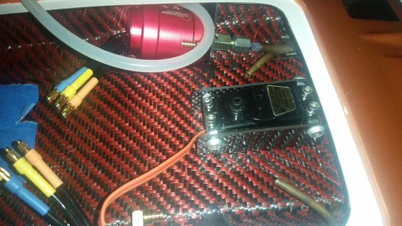

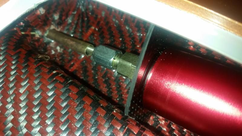

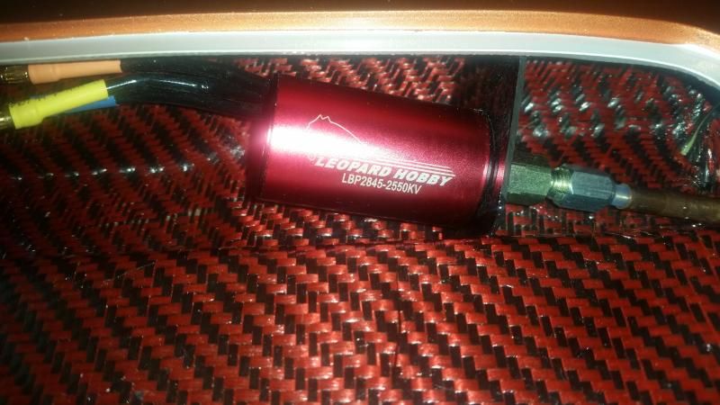

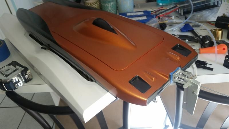

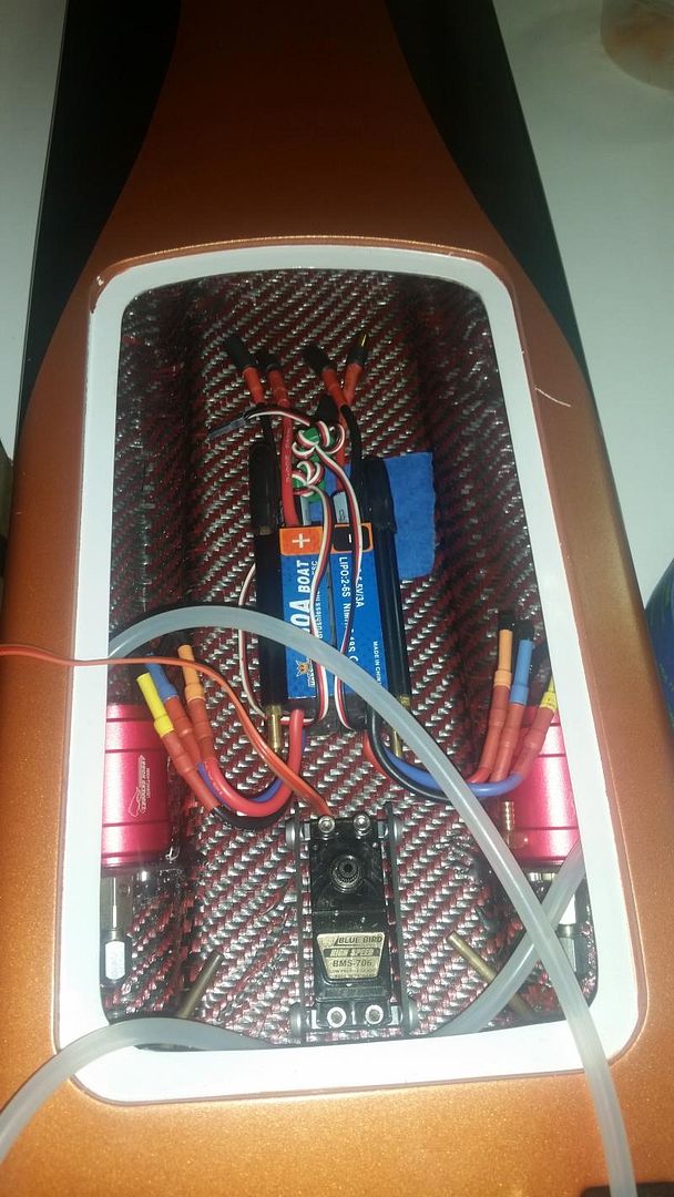

    Here's my latest build. Started it a while back, never really completed it much past making a template for the motor mount and painting it. Did it backwards but hey.
    It's got leopard 28mm 2550 kv motors
    Now all that's left is mounting esc's, cutting the flexs, and getting props n cooling lines run.

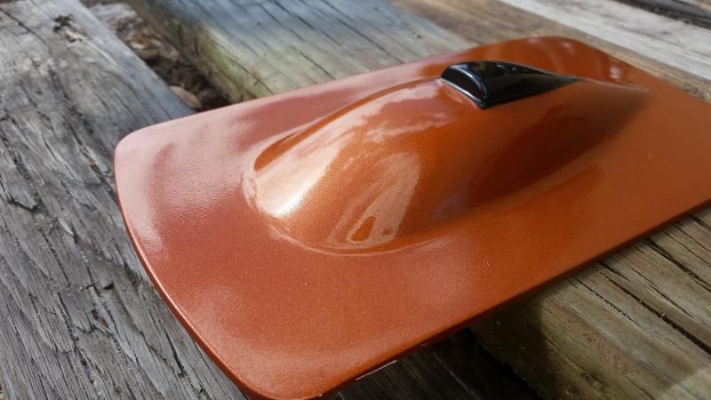

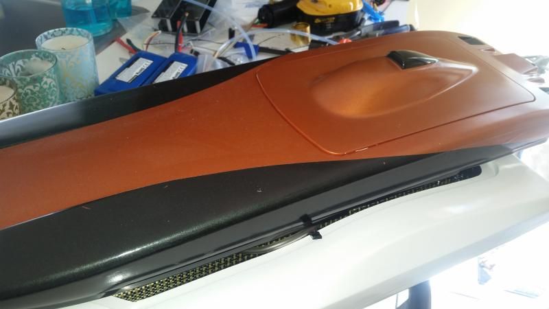

    Layer some clear to see how the color really looks

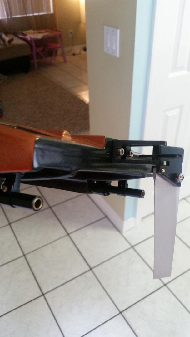

      Shot of the a $$ end. Lol

        Very , very nice, love how the motors are positioned!
        Hey, those stingers look trick, did you cut them down? Like the braces.
        waiting to see more!
        • ls1fst98
          • 859
          No they are 4mm tfl stingers, drilled out to use speed master 3/16 bushing. I had to grind the tops to clear the overhang. I dint snap a pic of that

                              Yea I've had most the parts laying here for almost a year. Scott did the inlay for me, was orange but we all know how that goes. Once it's wet it turns red. But oh well it still works. I got it about the same time the mini mystic came out and wanted to do something similar but far less money.
