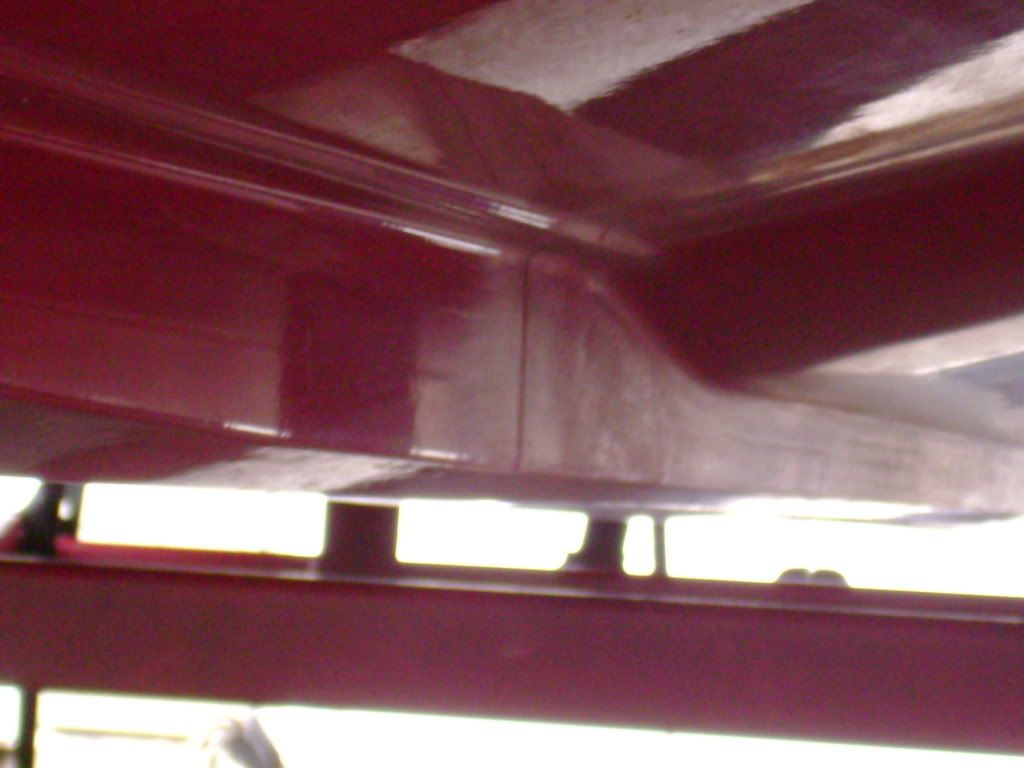

    I'm gonna have to thicken up that transom, you can see where it is thin by the corners, maybe I lay some fiberglass cloth on the inside.

        I just can not believe how bad photos make the hardware look, GUYS that hardware has a see yourself shine to it it has been highly polished and photos do not do it justice (I just thought I would share that) so if you guys like it in the pictures in person would be awesome!!! Wait until you see my next build (twins)

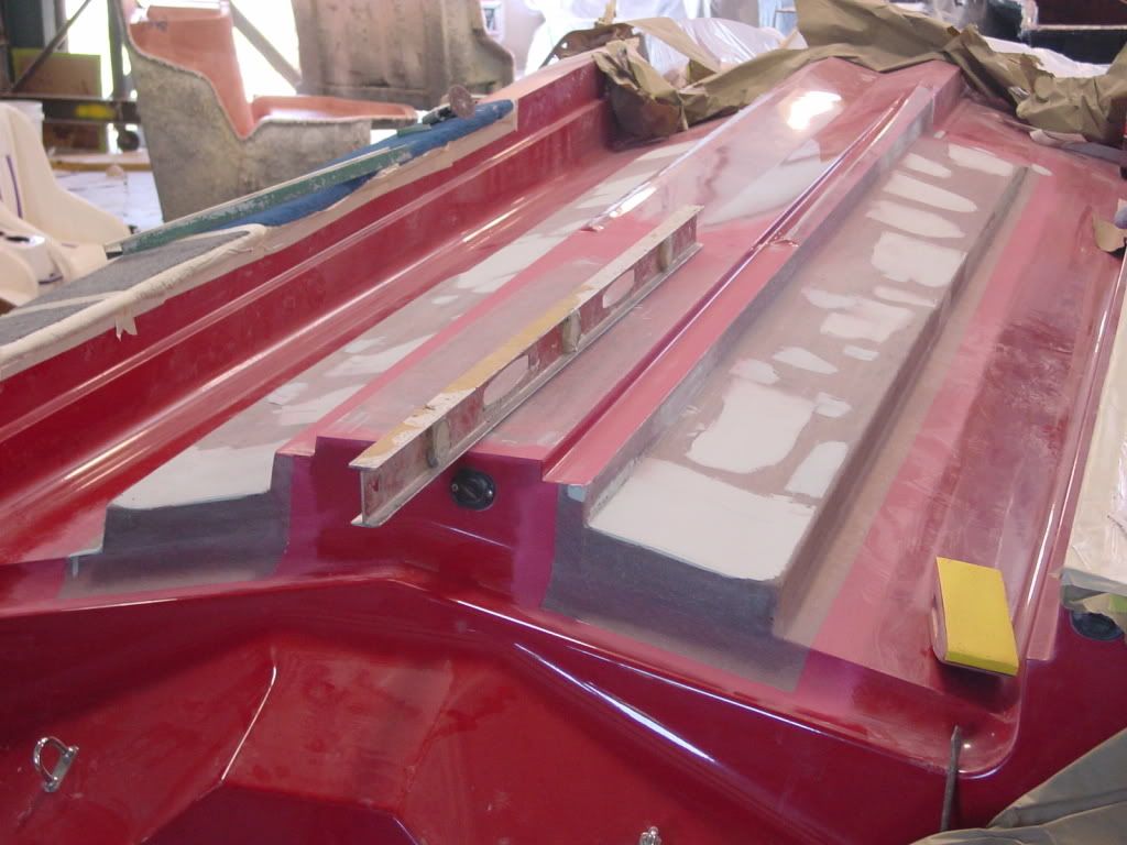

                I forgot to ask, would it be a good idea to add material to the rear steps, making them sit "deeper in the water so to speak? Like ride pads.

                  you mean make them flat like the majority of the r/c hull out there?
                  I thought about it but I am going to try them sharp like a full scale boat first and see what happens.

                    I mean if you were to put a ruler across the steps on one side, they are all even, but make the last one larger then the rest. I covered all the steps with 1/64 ply, so the last one add 1/16 balsa to the covering to make it larger then the rest if that makes sence.

                      No you would not want to do that it would defeat the purpose of the steps.
                      The steps on this design are more about letting air into the tunnel for lift.
                      If you were to make any of the steps taller it would be the front one then the boat would run like a hydro.

                            Not much progress to report, I am still waiting for my motor/esc's. Hopefully I will see them on monday. But I did rip off the 1/64 ply I had on the center section, and used balsa instead, it will make a better transition to the sides where it curves up level with the top deck/sides. It looks a little better then what the pic shows, still lots of work and sanding to be done, but I can't go much further till I get the motors. I also bought a durbro tube bender, it makes very nice bends, so once I place the motors, I can then start the water cooling plumbing.

                              if u where to make any part of that hull thicker it would be the center(betweebn the sponsons) my dad did that to his bopat and it lifts the boat out of the water more and it will decrease porpois

                                I'm thinking I may lay some fiberglass on the inside of the center. I'm interested on seeing how the center tub trim tab works on advanti's build.
