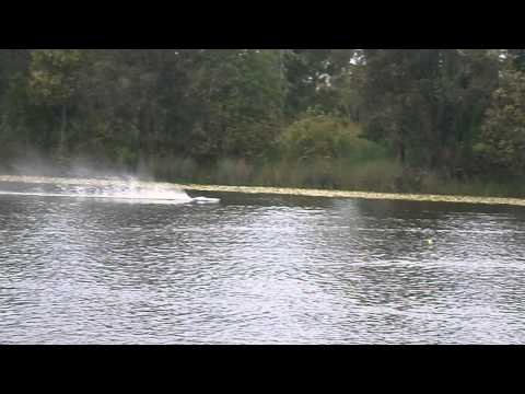

          Well I think it was a successful day at Sippy Downs yesterday.
          After a couple of flips, some strut depth & angle adjustment, and some prop changes, she was running pretty good in a straight line.
          Cornering is a different matter. The turn fin at the heel of the front shoe certainly helps but at fast speed the inside sponson would lift & the boat rolled over. So it definitely needs a fin on the right sponson somewhere.
          In the videos you will see that I had to back out of it in the corners to avoid the rollovers.
          Ended up with an X450/3 prop & everything was just luke warm after a run. So an x452 /3 is next on the list.
          I left the batteries at the front, so Ray, your instincts seem to be right.
          But next time out I'm going to move one pack to the rear section & try that. If the front wants to lift, I'll add a bit of negative strut angle to compensate.
          If that doesn't work then both packs will go back to the forward position & all other adjustments will work around that COG position.
          I'm encouraged enough to go ahead & give it a full paint job now.
          There's definitely more speed in it yet & once the cornering is sorted out it will be a great boat to run.
          Here's some pics & vids of its first 'full' test day.
          I'd like to thank everyone here for your help, insights, knowledge, & words of encouragement on this little experiment. It's all helped to get this thing on the water.

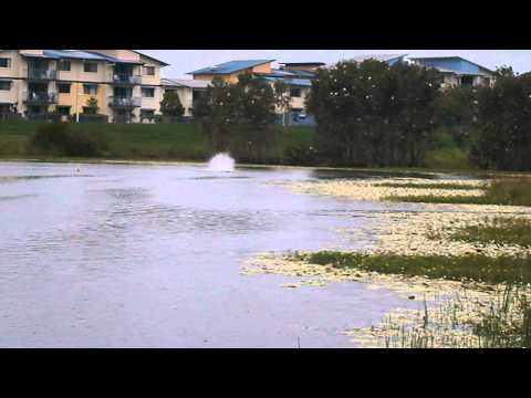

            Another video. This time from the end of the front straight.

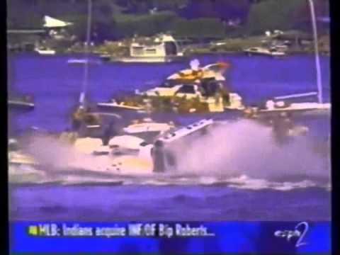

                      Then. By chance. Not half an hour ago. I saw this video.
                      At 2:25 the Miss Elam canard flips. You can see the turn fin on the forward part of the sponson. I would guess that it is just in front of the COG. Good enough for me.
