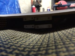

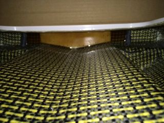

    Spent my vacation building a Cheeta and got my chance to implement some new things
    Transom got re enforced....

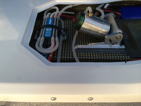

      Gave the side plates a bigger foot print and made the motor plate...

        Made a esc holder and servo mount. 4-40 Hanger 9 Titanium turn buckle and HD ball joints for the servo rod....

            Lexan battery trays and center piece to strengthen the setup. Gave the perfect mounting area for the electrics and strengthening the stuffing tube area. I hung the water lines . Boats RTR weight with 5s 2p is around 10 lbs Lexan is the
