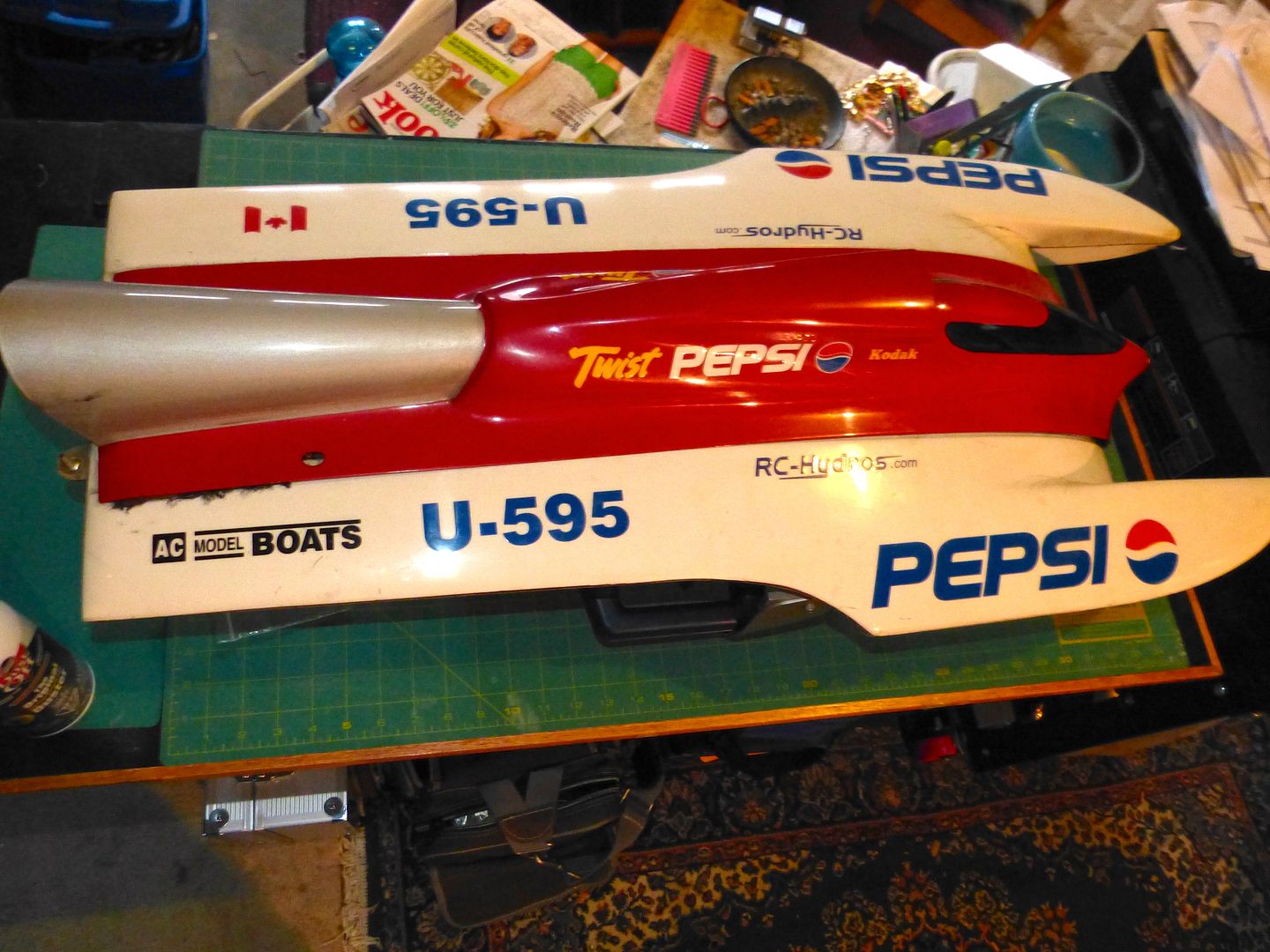

                          I picked up a new Sport 40 nitro boat from a club member to replace my tired old Phil Thomas, it's the twin to my FE with a MAC .45.
                          It will be cool to have both versions for testing setups.
