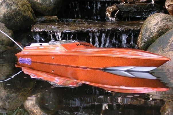

I've had this for awhile and now I have everything I need to start the conversion!

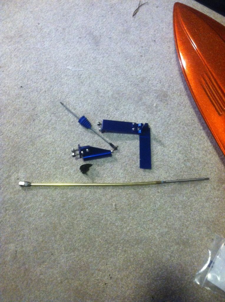

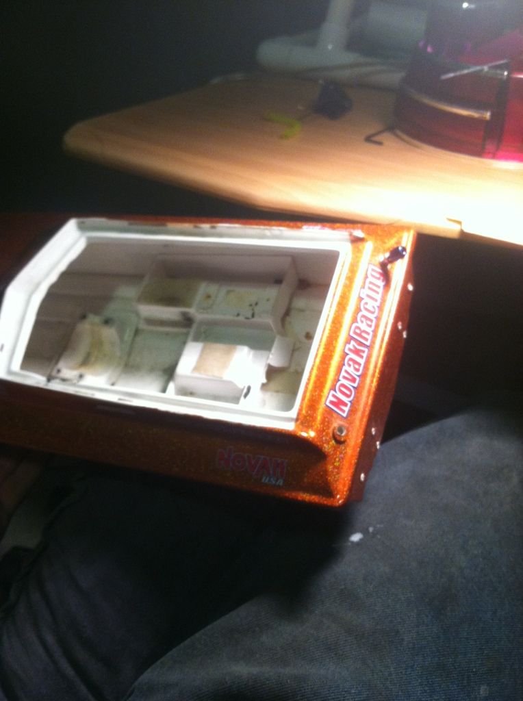

First I gutted the hole thing

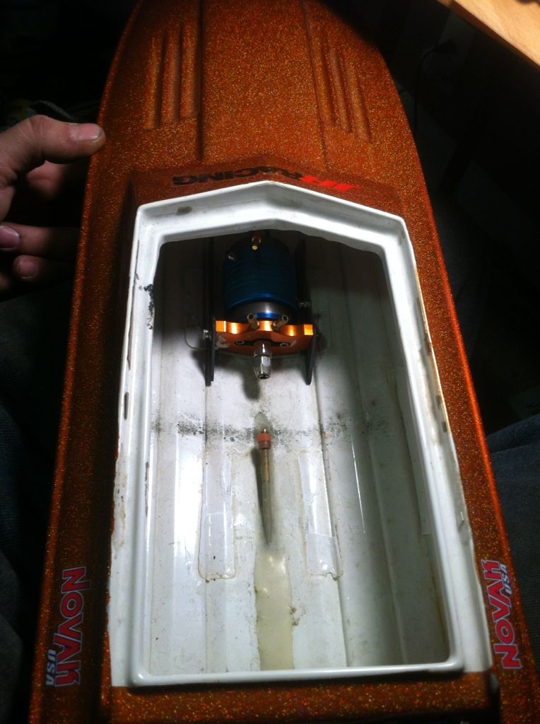

Then I cut out the prop shaft out

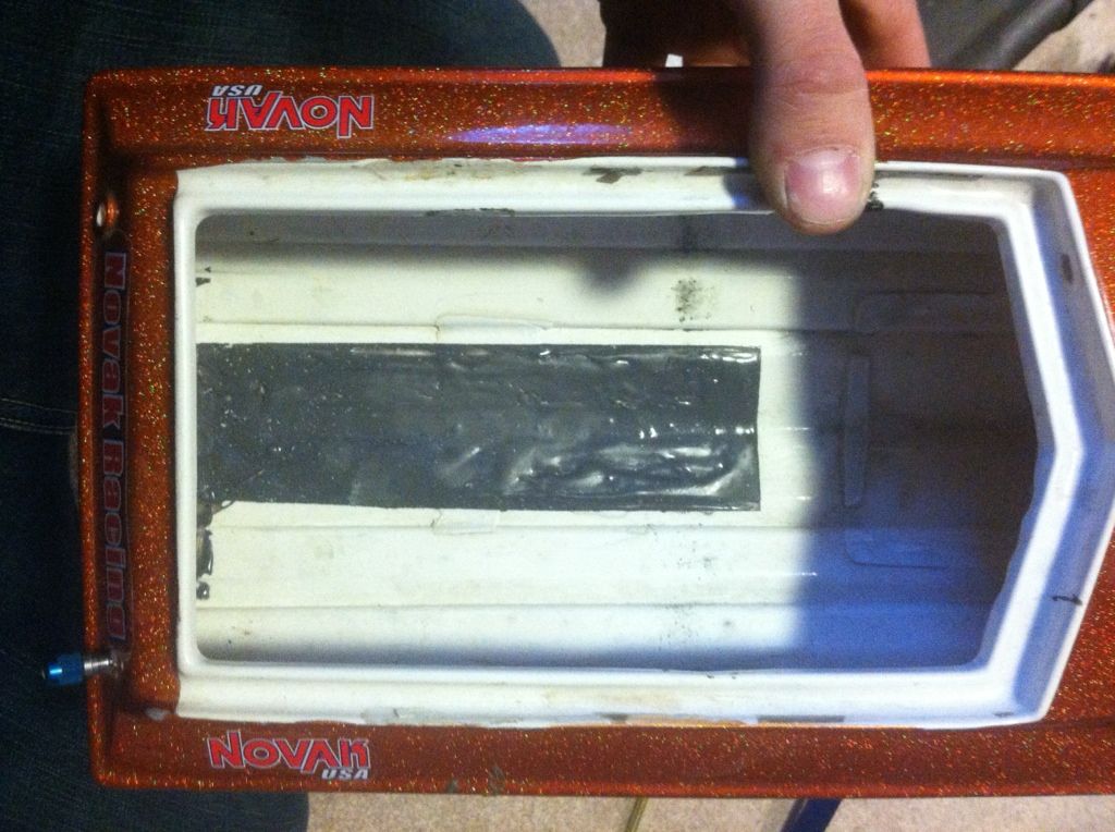

Next I filled the old prop shaft hole I used jb it's alittle flexible and stiffens up the hull I put a layer on the inside first tapped the hole up from the outside and poured in the jb weld, once it firmed up I removed the tape and put a layer on the out side (I still have to sand and block the outside)

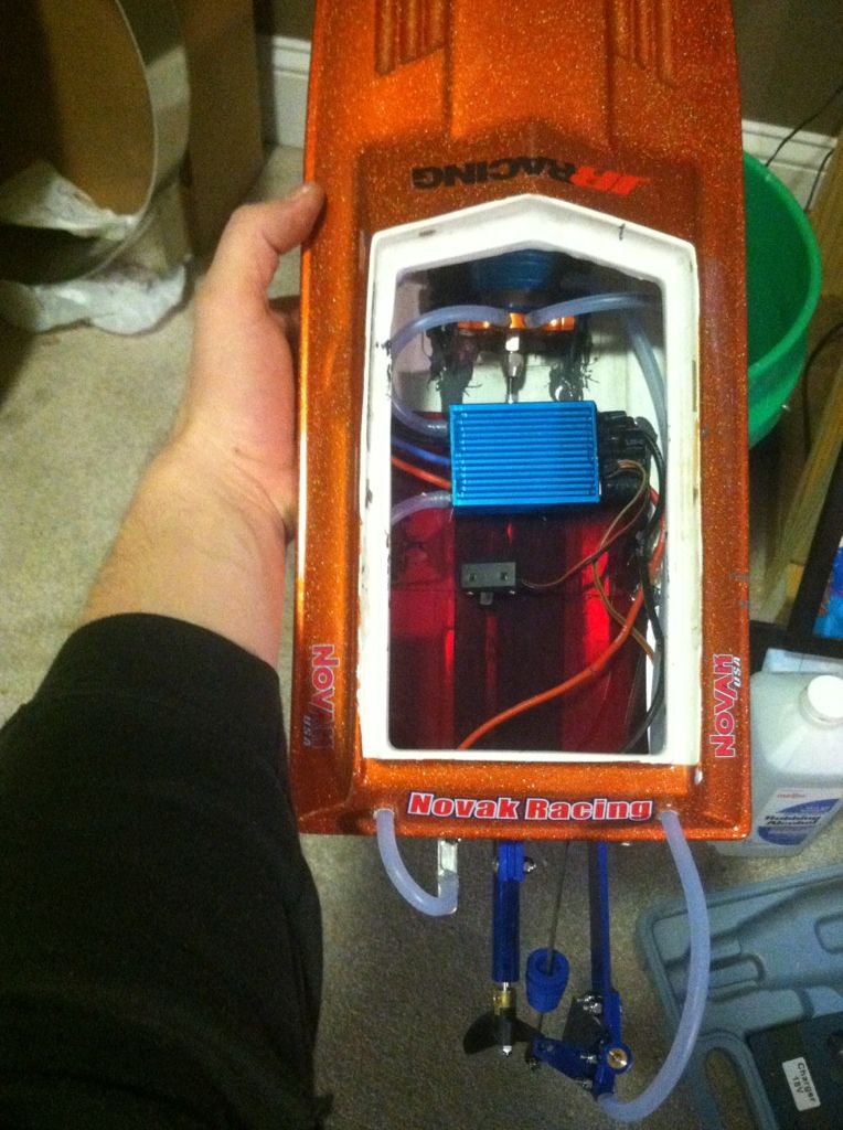

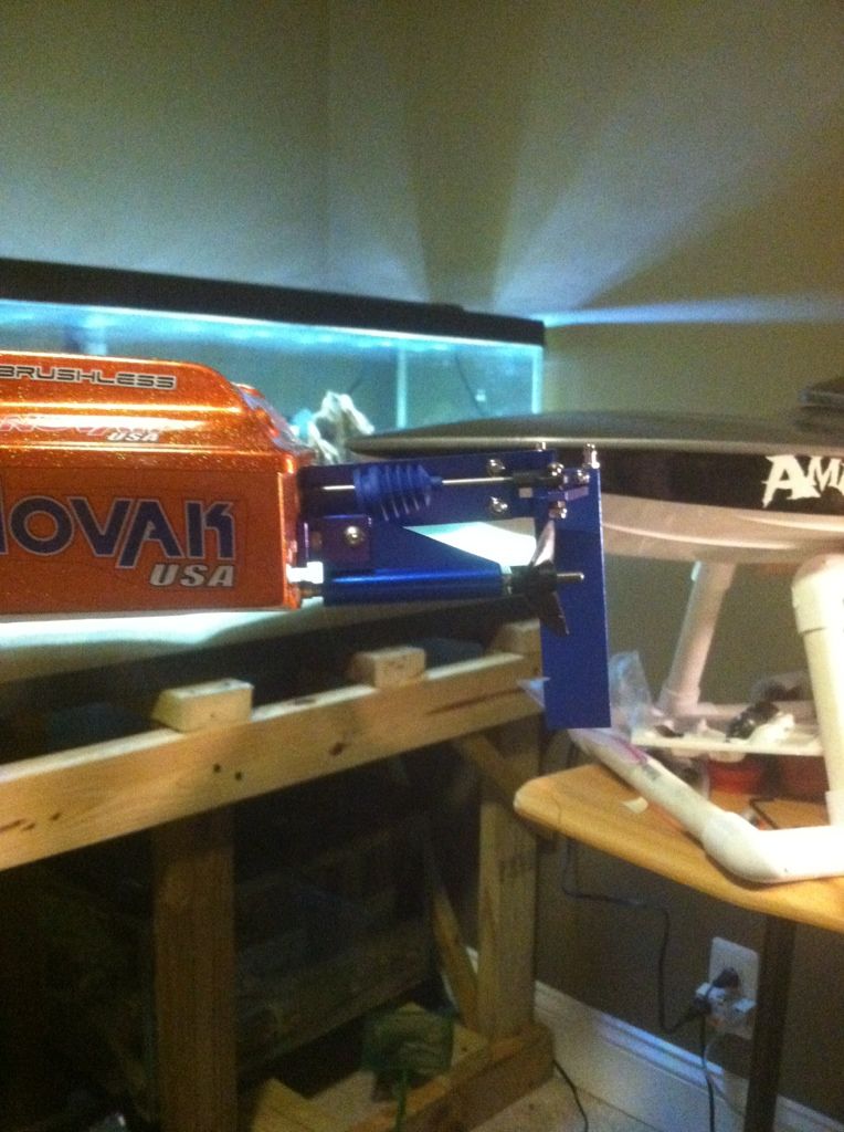

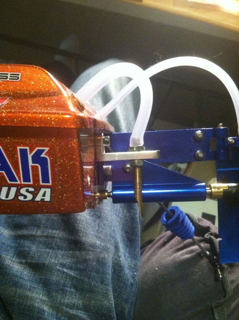

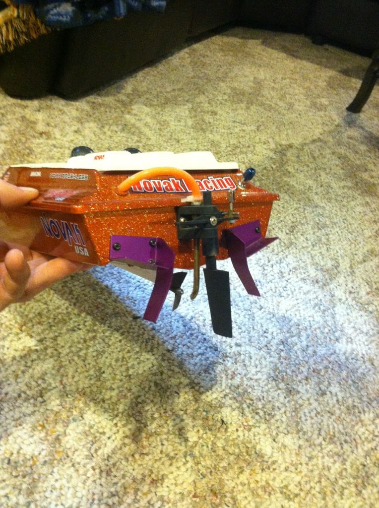

I'm using traxxas spartan strut, rudder, flex cable and stuffing tube witch I'm going to have to cut down motor mount is carbon with water cooling

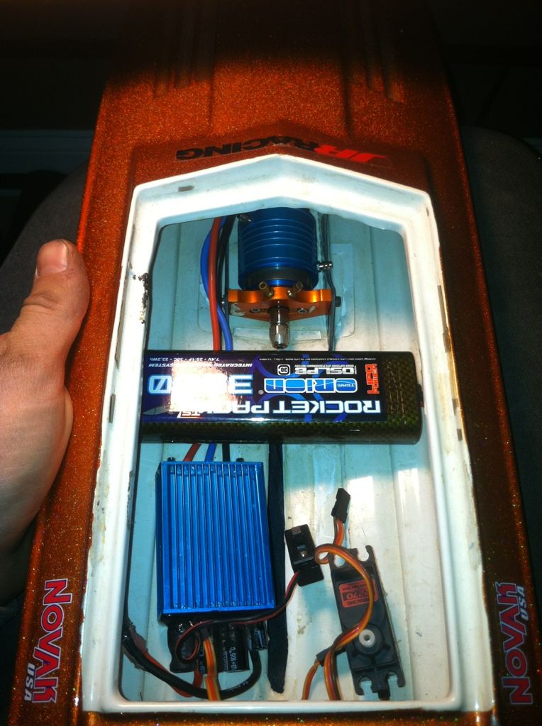

Power plant is proboat 1500kv motor and 45amp esc here's some mock up pics
