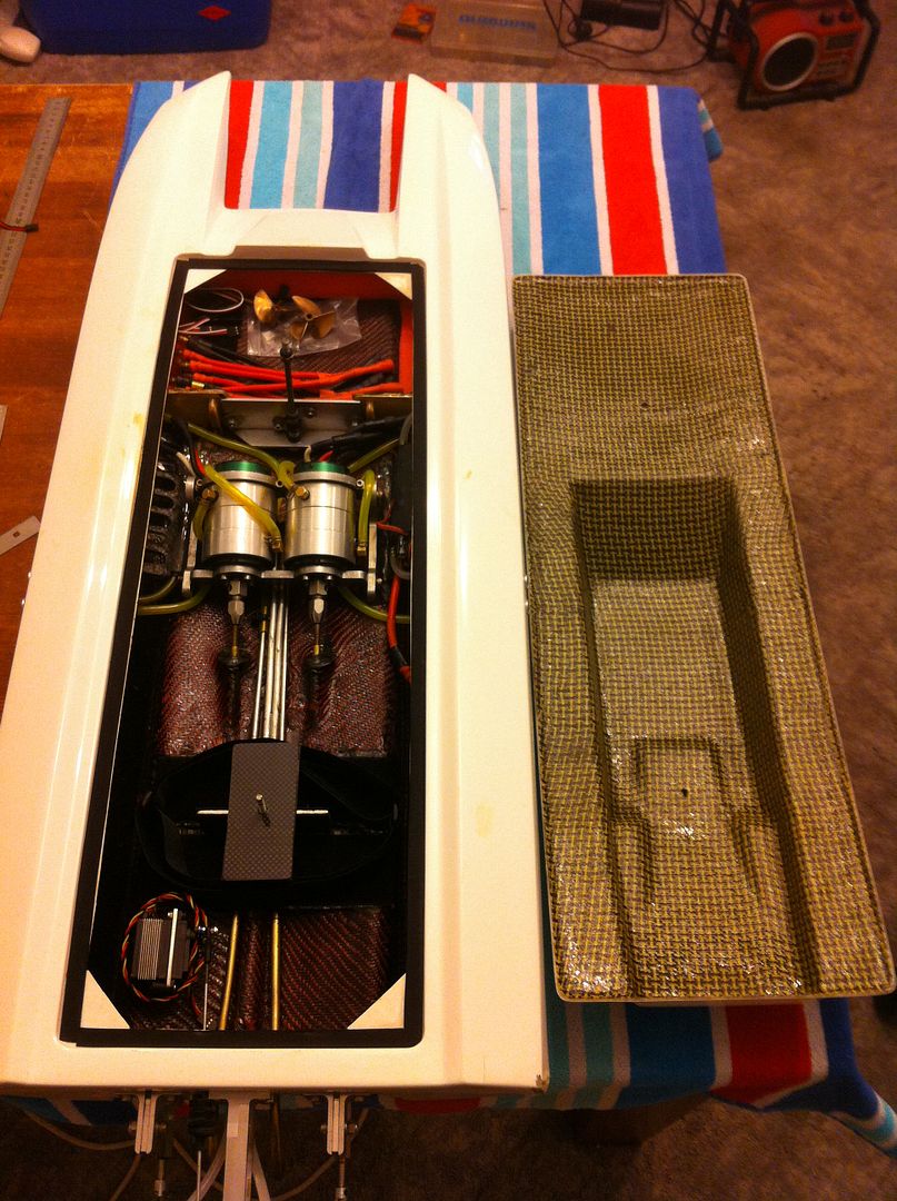

    After a long time building this hull up with twin 1717's, I failed to set it up correctly and burnt out one of the speedo's. I think it had a lot of potential but I simply don't have the time or experience to root around getting it right as a twin so I have decided it'll be rebuilt into a single. My plan of attack is to strip out the hull, fill in the transom holes and start again. I'll leave the servo mount and battery and see how things pan out.

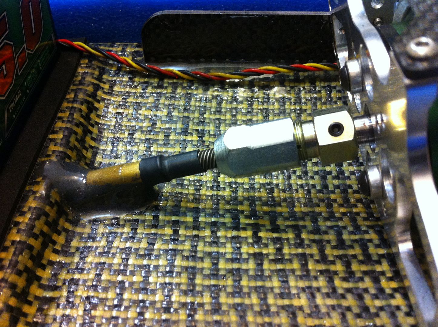

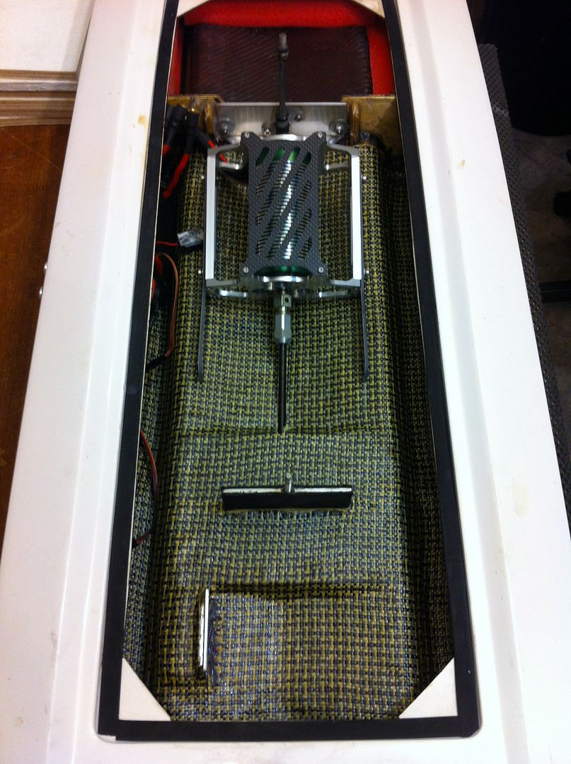

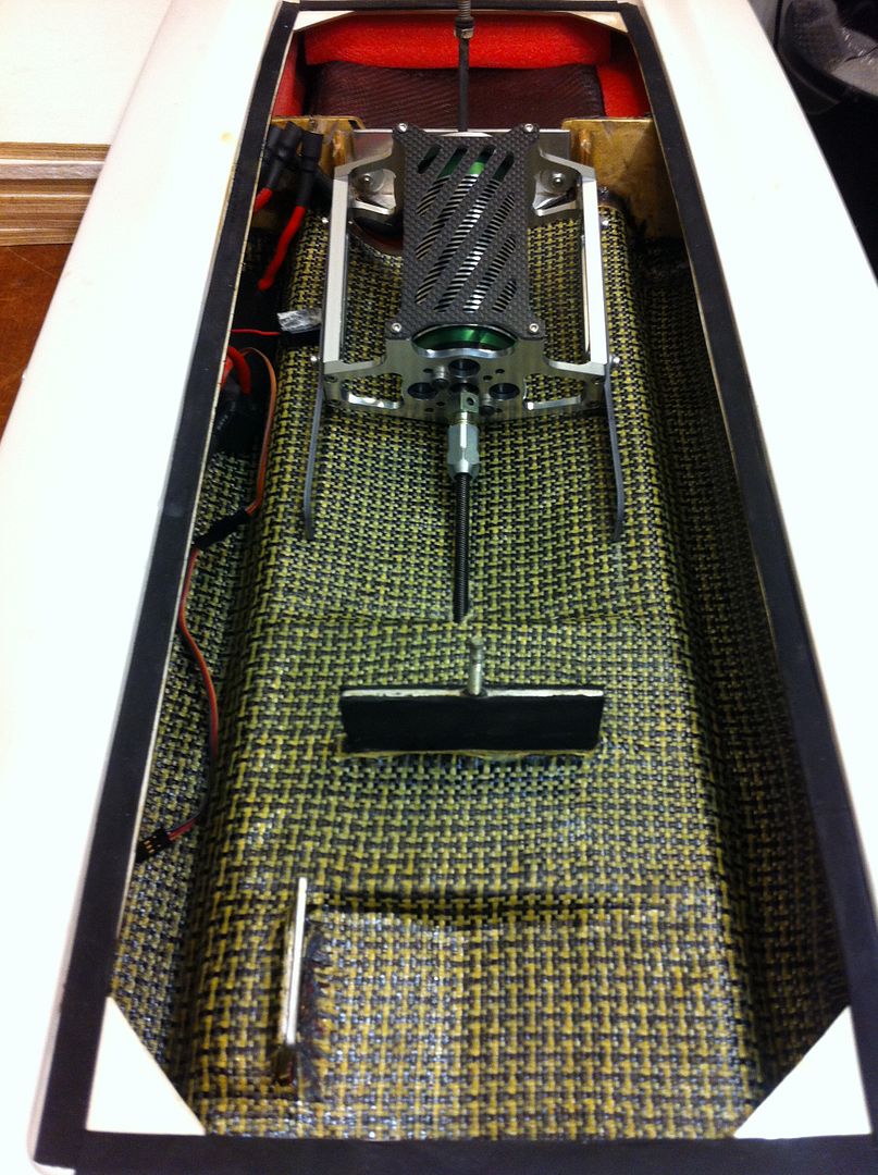

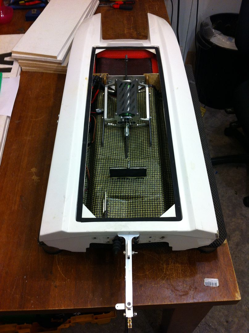

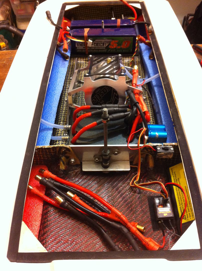

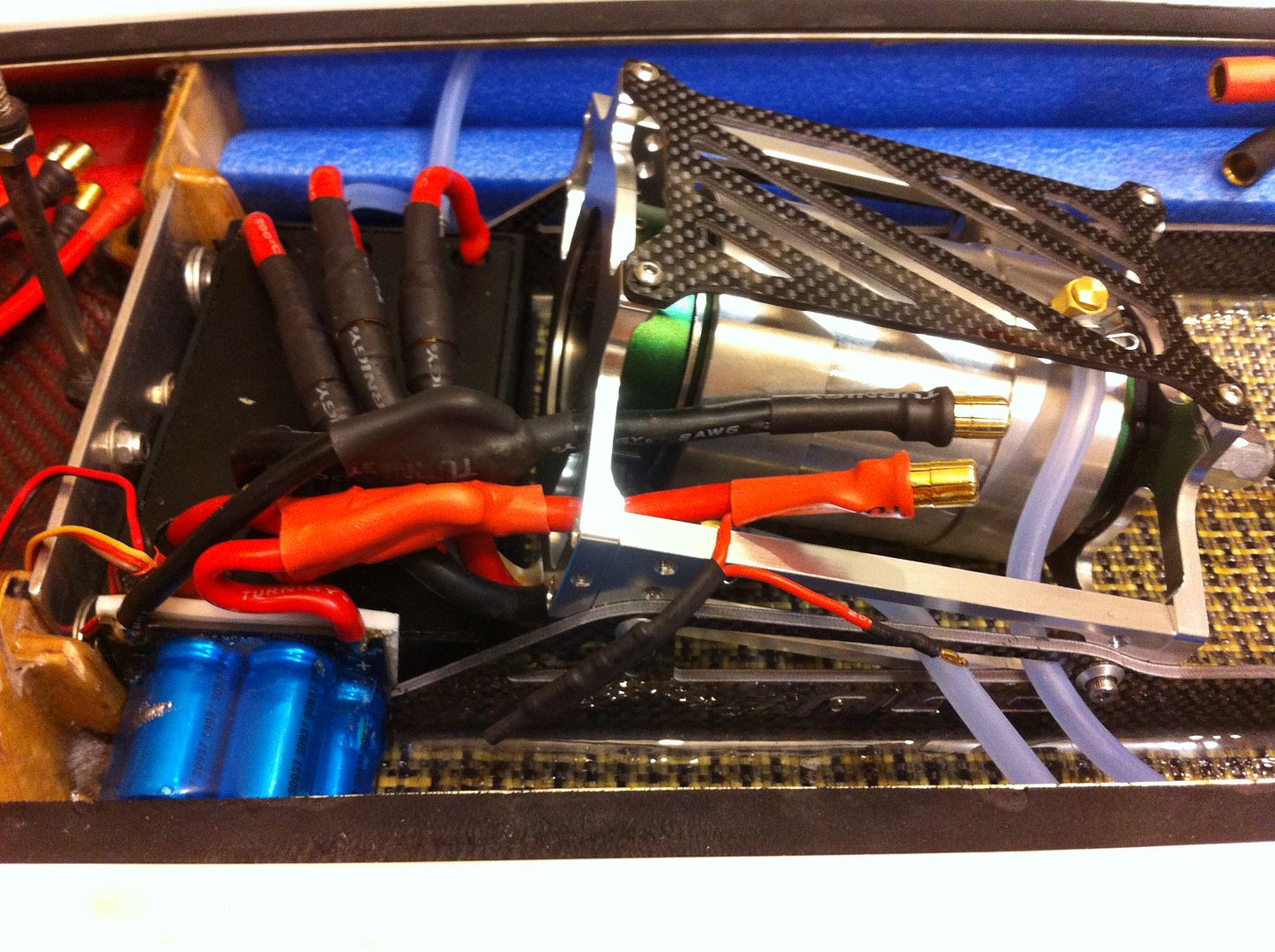

                    Well after a little time I've put it all together, programmed the speedo and she's sitting ready for me to test drive. I had a little self doubt on the cap bank but with a little help I managed to figure it out. There should be plenty of room for me to adjust the COG and I've set it up around 29-30% for it's first test run. I'll run 10s2p and see how the electronics go.

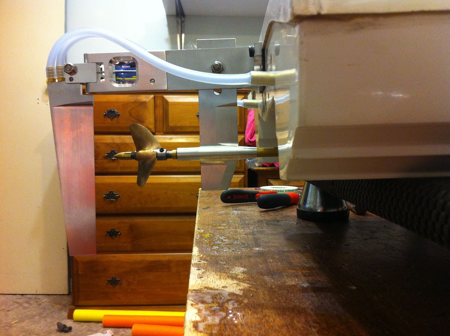

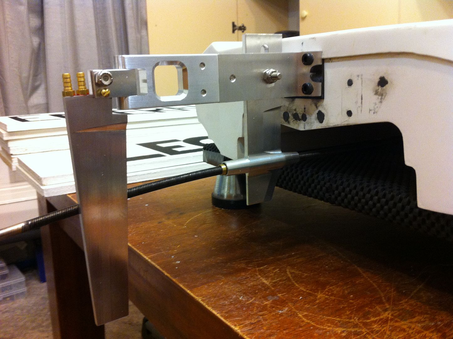

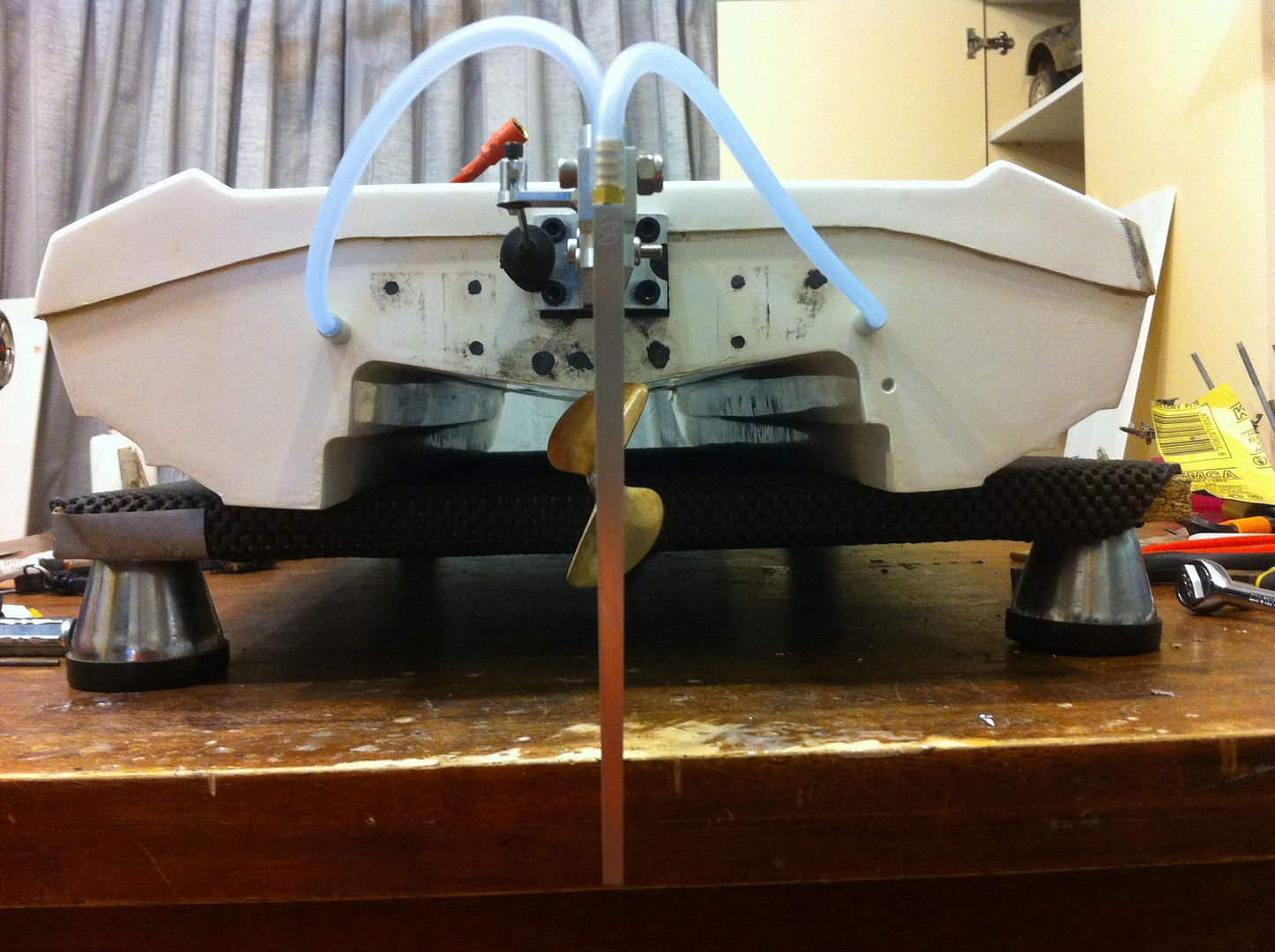

                        Nice boat, I think you would like an offset rudder bracket, and pitch that prop 3 deg. to the right and you can run straight rudder which means less drag... Ask around and you will find most others chime in on this

                          3 degrees up or down?, I'm a little unsure what your saying.
                          "Gimmy Toyz for FUN"
                            • 7673
                            I think he is saying to the side to compensate for propwalk Danny.
                            • high-tech
                              • Sep 2013
                              • 331
                              3 degrees to the right and yes that is compensation for propwalk, to do this either bend the strut brackets that attach to the transom or fabricate a shim that fits between the strut bracket and the boat.
