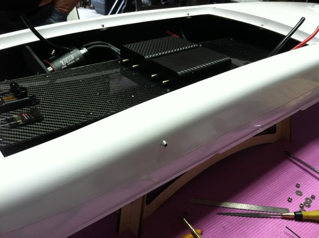

          Well got the boat all put together today. It's ready for some testing (hopefully next weekend) think I'm gonna start out with these 60mm props lol (just kidding). Just painted it white because I'm having it custom wrapped.

            Looks beautiful man! I love the way you cleaned up the escs and mounted them...

              Thanks I appreciate it. Those ESC's are huge and ugly I had to do something to disguise them lol
