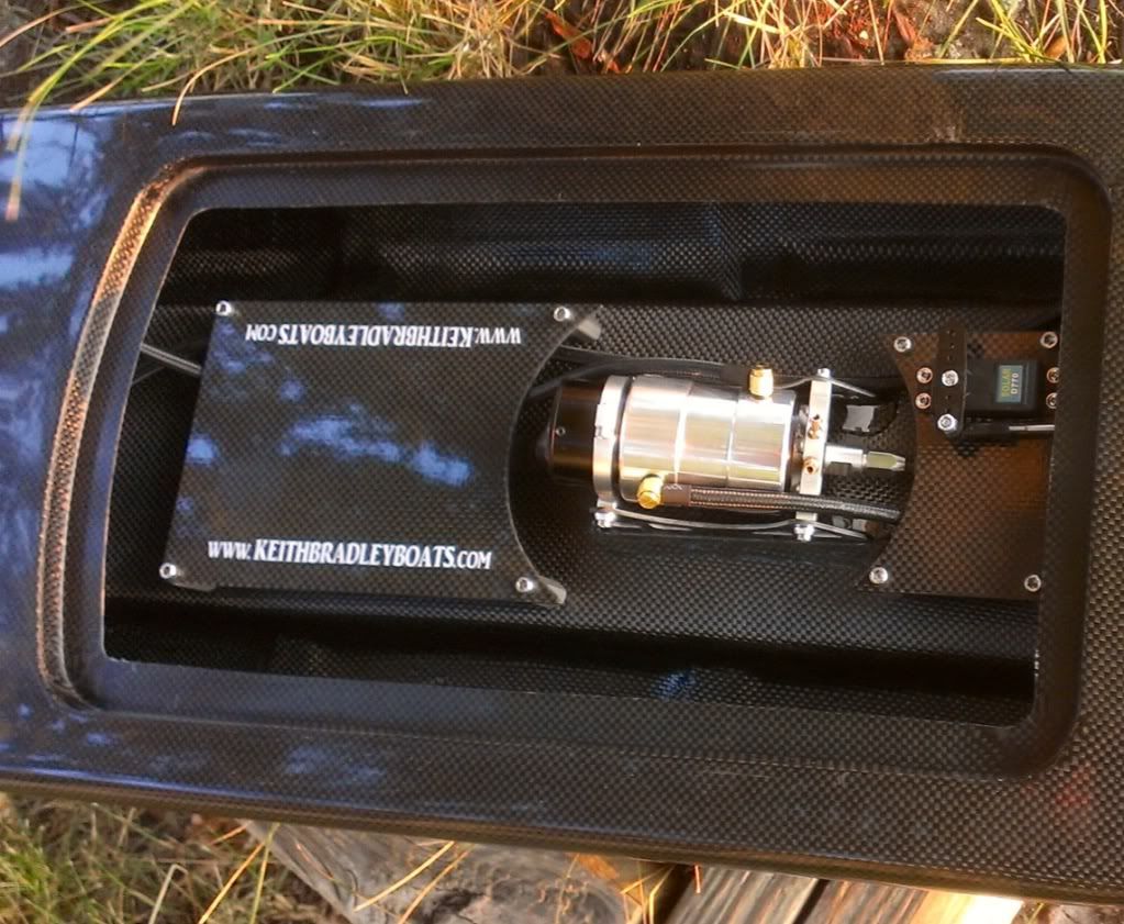

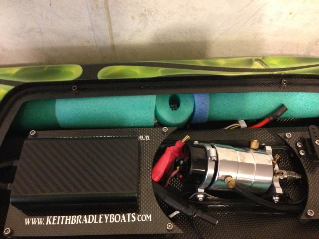

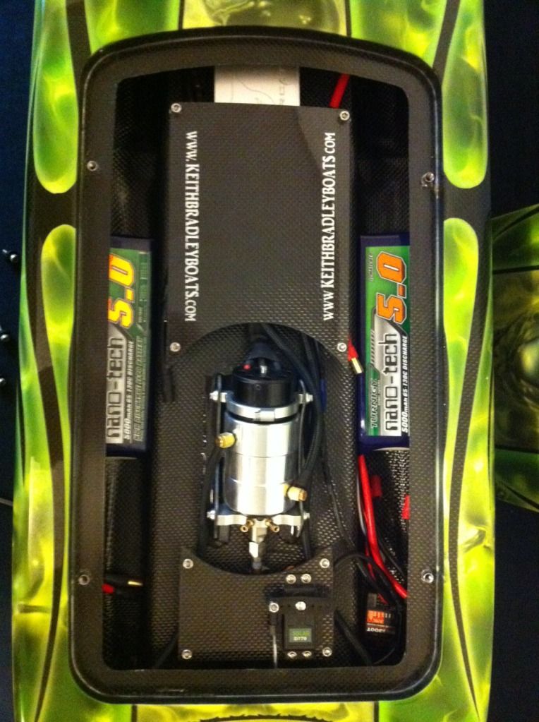

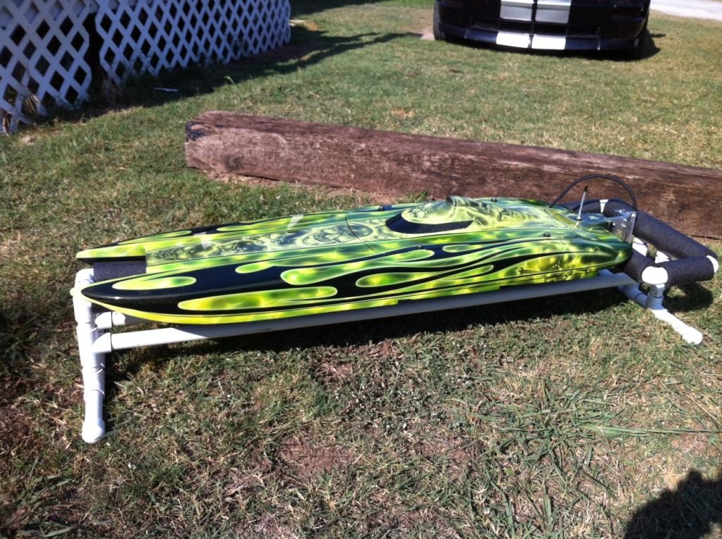

            For your flex, run .187 flex. The motor mount is from FC, don't use the one from OSE. If you do you will need to cut some CF plate in strips to raise the motor. Just make sure you sand anywhere the epoxy is going to touch. I use G-flex epoxy. Here's some pic's of the inside of my Fantasm, Keith did a very nice job on it. And Steve at Airbrish Alley did a hell of a job painting it
            If you need me to take some certian pic's of the inside just let me know
            • Chrisg81983
              • Jul 2011
              • 1556
              Jason that's be he'll of a paint job......genestein the only way I can recommend to secure hatches is to bolt down with countersunk screws then tape.
