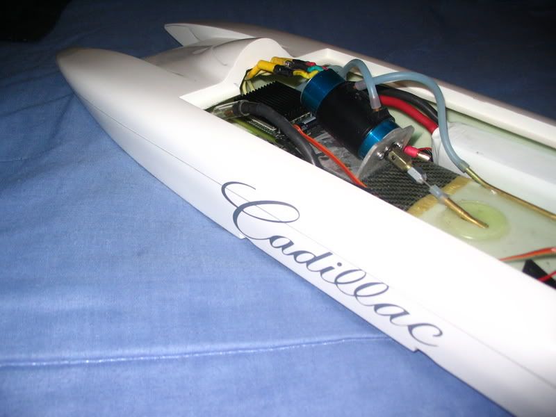

                  okay, i went with a aluminum servo mount.( sorry for the two colors of bolts)
                  and just a L style motor mount for mock up ( have to see how the wire drive will line up if i have to make further changes. as well as this 7XL feigao motor for a toss in for placement as well. I am still waiting on my motor. i thought the package was at the post office but it was something else rather then my motor.

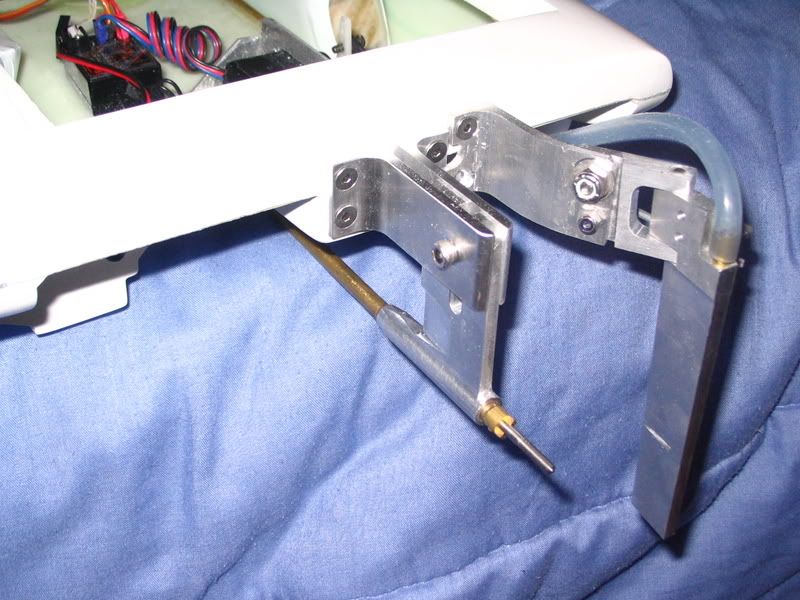

                        • Eyekandyboats
                          • 1921
                          done, other then my NUE which still HAS not arrived yet !!!!!
                          hardware needs some sanding and polishing to get rid of the scuffs

                          • ray schrauwen
                            • 9472
                            Your ruuder mount is bent, LOL...
                            Nortavlag Bulc
                            • Eyekandyboats
                              • 1921
                              ... well tilt you head a bit and it will be all fixed.
