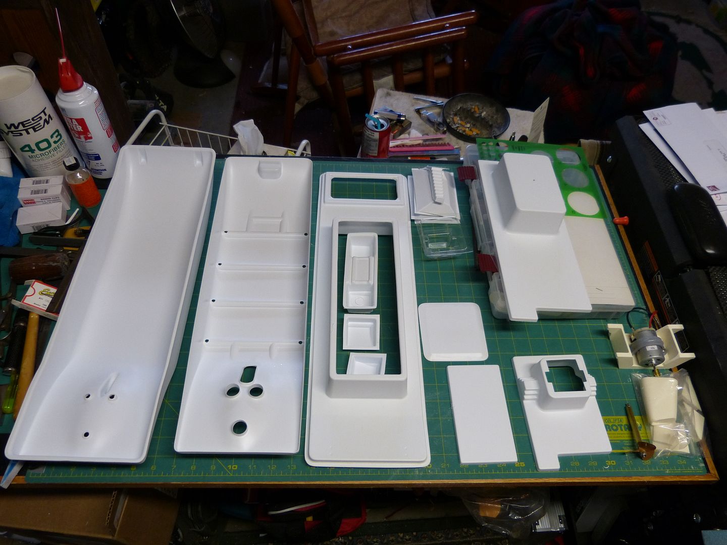

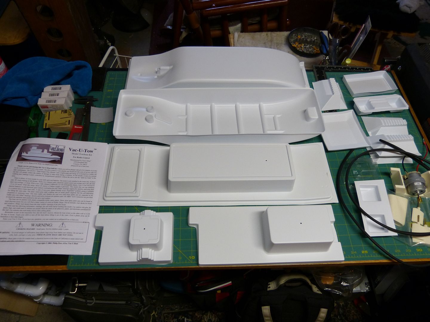

    Here's some pics of my Vac-U-Tow build, it's a little bigger and more powerful than the old Vac-U-Tug it's replacing. Some of the highlights of this one are more scale detail, 3rd channel controlled lights, automatic bilge pump with fire nozzles and a GoPro mount.

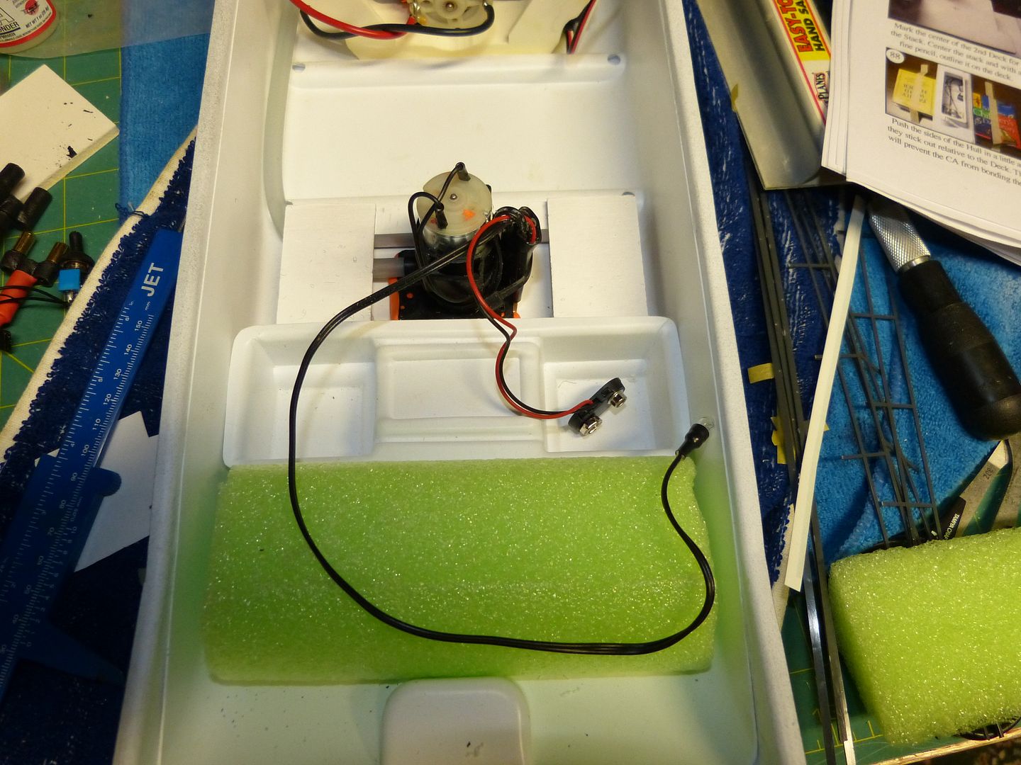

    The bilge pump is mounted with Sugru rubber and uses a 9v battery.
