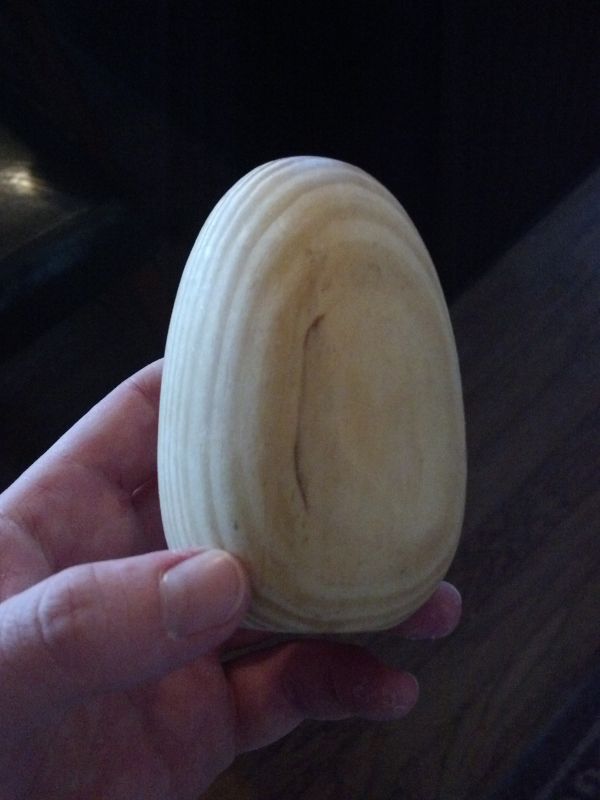

    I have started a pontoon build with some extra parts and an ep1 I had laying around. Pontoons are black ABS 2" pipe, I know they may be a bit heavy to float well, but one 24" holds over 3 pounds, so with two 24" and one 10" it should hold the weight. I found eggs from hobby lobby, cut them in half for the front and back of the toons. Motor mount is 1/2" ply. Here are some pictures so far.
