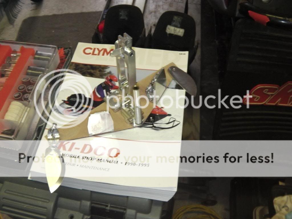

    Hello , gotta say I'm hooked on FE's . Where too start. My 1st kick at it was with a Crappas Spartan , mind you they fixed it almost every time with me footing the return shipping bill (enough said) .......on too bigger and better :) , i have red mostly all of pirate builds , but with different hardware on the a$$ end i don't think it will all fit so any help is very welcome . I have two set-ups both with 180's , 4082 and a 4092 on 2-3s 5000's here are some pic's of the progress
    I laid carbon kevlar inlay with the west systems (luv using there product) , re-enforced the canopy with regular glass . I have some CF left over so i might add it to it for looks also . I bought a strut from ose , not knowing what i wanted for a hull and bought the hardware . is there such a thing as too much rudder on this boat . OSE you ROCK thanks for the speedy shipping .

        Ur rudder is to close to the prop! Ur gonna have to move it over to the right more. You will also have to grind those pretty trim tabs too, to get the rudder installed. Is that the speedmaster 60,4'' offset rudder?

          i'm thinking its too big . its the speed master 013 , i have another one coming , i really like the trim tabs .

                          Savage what is the dimensions of the rudder base that you have? The Speedmaster 60,which i have measures 32x44mm (1.25x 1.75'')
                            Mine is the same here's a picture .

                              The rudder will work but the tabs will prolly be in the way. Speedmaster rudders are beefy! I was going to use those tabs with mine but there was no way to get around grinding them. Too nice for that!! You can also trim that rudder down.
