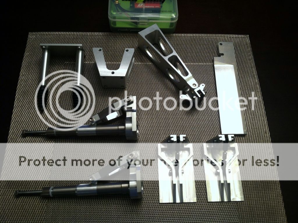

                  Some hardware....
                  • Rocstar
                    Joel Mertz
                    • Jun 2012
                    • 1509
                    Holes drilled and hardware test mounted....
                    • PF3X
                      • Mar 2012
                      • 65
                      Nice, full MTC hardware

                      • Remmie81
                        • Apr 2012
                        • 134
                        Very nice hull and hardware! Looking good man!!
                        From the pictures it looks like the trimtabs are mounted level with the bottom of the hull?
                        If so you could better raise them 1,5-2mm otherwise they will create drag.
                        Keep the pictures coming!!
                        • Rocstar
                          Joel Mertz
                          • Jun 2012
                          • 1509
                          Thanks Remmie, nothing was tightened in the pic, just checking hole alignment. The tabs, when tightened, will set up a bit. Waiting on some misc parts right now.
