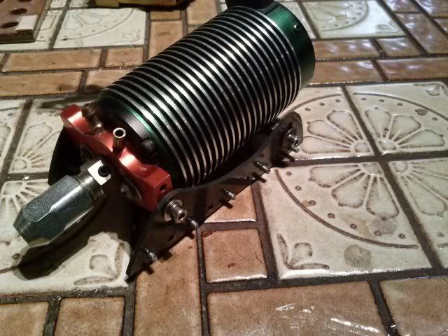

    Basically the whole setup except electronics and motor mount. I had a Castle 1717 1580 KV motor that i think will make this boat go pretty well. I needed a motor mount so i removed the mount from my osprey and made a mount out of 2mm carbon fiber the same as the basic mount.

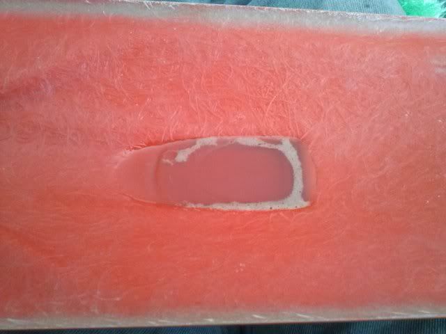

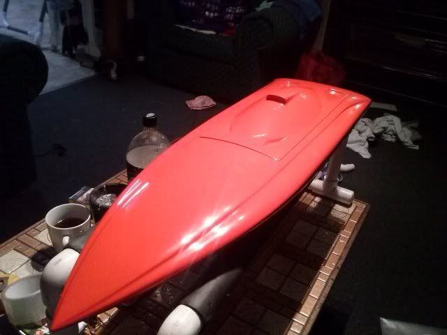

    First step i filled the top part of the hatch will epoxy to strengthen and level it a little to make covering it with carbon fiber a little easier.

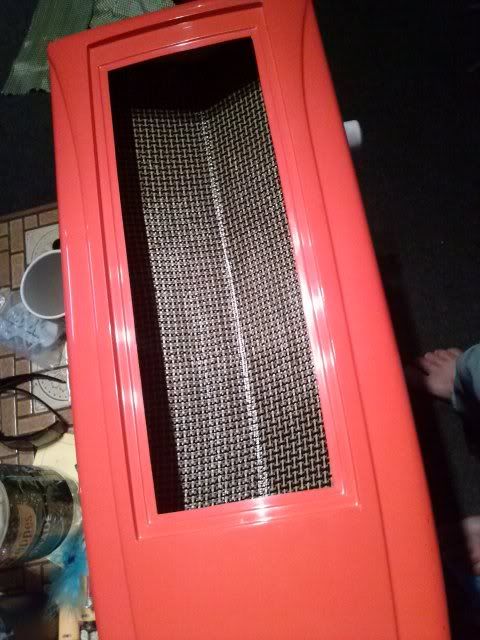

    Then i reenforced the whole hull with carbon/kevlar cloth, i did the hatch as well but am adding flotation at the moment so no pics yet.

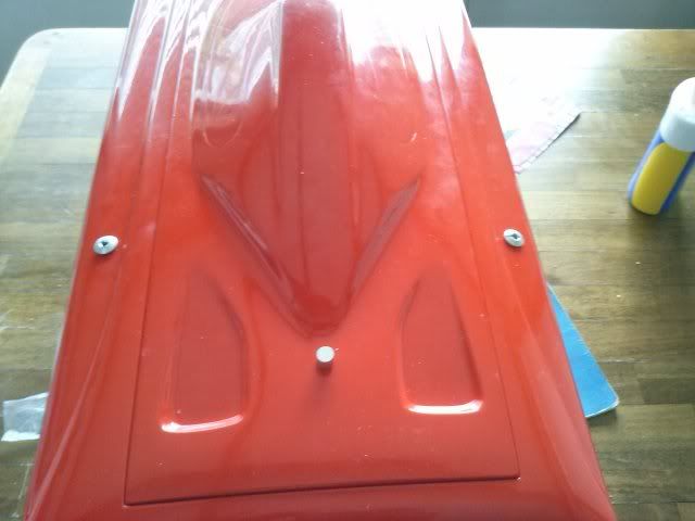

    Then it was time to start fitting the hardware. I dont think i have measured and re-measured something so many times in my life. I started with the hatch lift nut and water outlets

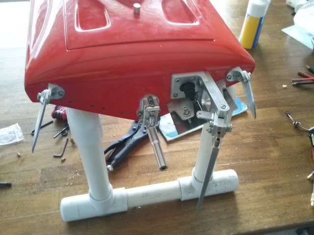

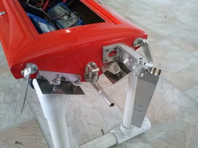

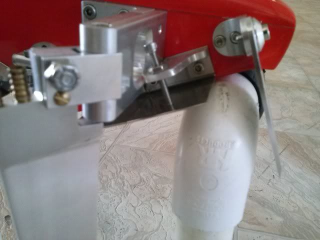

    Then i started with the transom mounted hardware

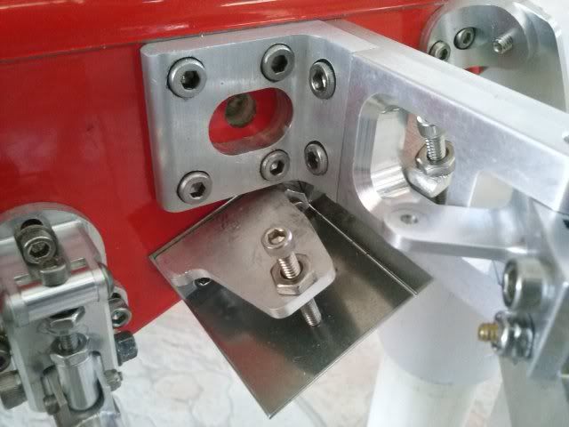

    I made a noob mistake when marking it out, i had the rudder and trim fins to close so i couldnt get either to mount up. By the time i realised it was to late i had already drilled all of the holes...
    So out came the grinder and file and i made it all fit
    Completed Transom

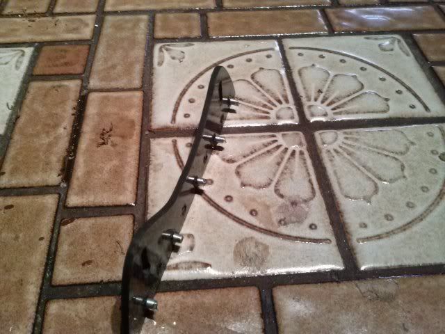

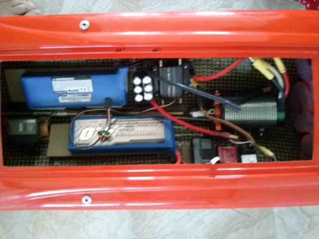

      Next i started on the battery/esc/rx/bec mounts, all made from 2mm carbon fiber. While doing these I also made my motor mount side plates. I put the flow through holes in for the epoxy, but only 4 will be used s flow throughs. The others have hd some 4-40 rod epoxied in place to give the mount a little more strength in the mount.

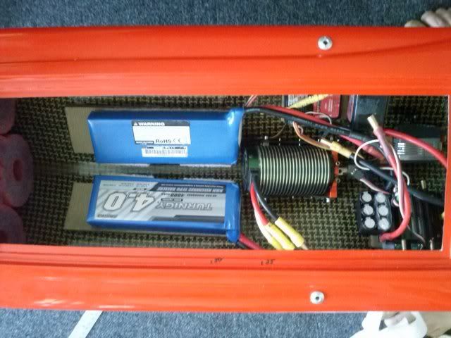

      Now i am down to sorting out the positions of everything to get the COG right, so far this looks like what i will probably go with, its giving me 30% with the packs where they are and can get them back for 24% if i need to. I can get the COG to 32% but thats with everything really squashed up

        It's a little late now,
        But I would put the motor closer to the transom.
        Than you would have a lot less flex shaft to deal with,
        And a lot better CG to work with the cells.
        What cells are you going running with that setup ?
        ? ONLY IF THEY WORK
        • BlackSnakeRacing
          • Sep 2012
          • 59
          It's not to late yet mate, thats why i posted the thread now, everything is still in mock up
          Its mocked up with turnigy 3S 5000mah packs, but will be running with Nano-tech 5000mah 3S in series for the moment, if i want to sport run i will be running Turnigy 6S 5800mah, but that requires me to move my rx/bec/esc, but everything is velcro mounted and trays are inline so it is possible to adjust to both setups.
          My thoughts with the long flex is that it allows me to get the COG but keep the batts low in the hull, i'm setting this up for mostly speed runs.
          I'll take any advice that wants to be given, an feel free to correct me on anything i have done as much research as i can but still know sweet FA bout FE

            have had a bit of a play around, this set up allows me 30-27.5%COG with the 3S packs, 6S packs there is no chance for the COG. The tube is around 4.5" long...

                the build is finished just waiting for a chance to maiden it, but nothing is set in concrete so i can cut things out and move them if needed... Have gone with the layout in the last pic, was planning to update the thread after the maiden.

                    I don't disagree with Milzee. But I found that my hull ran too wet. So running closer to 28 to 30 cog is what I found to be closer. I had to move by 6s 2p up and back to get that. Good luck let see your results.

                      I'm running half the battery weight that you are, a faster and bigger motor which will make alot of difference to the way the hull runs on the water Where i have the packs at the moment i can get 27.5-31% COG. I have done a little testing with the leo 4092 1600kv and the 1717 1580kv in my osprey and need to run the COG way forward with the 1717 to keep it on the water with the same stinger position and prop. I'm trying to keep the weight down, i prefer blowing everyone at the pond away with SAW runs than sport/circuit running.

                        If you really want to make SAW runs, set it up for 2p. Anything near a real SAW setup will easily puff 4000mah lipos, and voltage drop will be an issue.

                          Its not a full on SAW setup, it is conservatively propped and launches when already on a plane. So far i have run the same setup on my osprey without puffing my packs (not saying it wont happen), am just trying to build on a budget with what packs i have available to me. In the osprey the packs come out a little warmer than ambient but no puffage yet. The 4000mah packs were only put in for the pics, i'll be running 5000mah nano's. At the moment there is nothing at the pond that comes close to my osprey, am hoping that i can get this a little faster and encourage a few of the boys to start getting a little more serious.

                            Ok, I think I just took your SAW comment a bit too literal.
                            I actually like the motor forward setup for a boat this size, but both work. Have fun with it and post some vid!

                              Yeah its not a SAW boat, i just like to be faster than everyone else for the moment and on a budget
                              I run motor forward on my osprey and have to have my packs beside the motor to get COG, i wanted to keep my packs as close to the center line as possible to keep a low COG as well.
