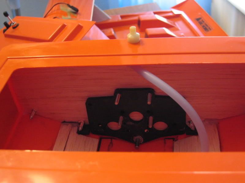

Coat it with epoxy and let it dry, then put a layer of epoxy down on the transom, lay the piece of wood down into the transom and then pour epoxy over the top of the wood, filling in the edges and such.
Why do you have to seal it?
are you serious?
what does water do to untreated wood?
rots it.Z

I got a SV 27 and ran it once, I really dont much like boats that only turn right so I put the boat on my shelf. I thought the interior wood was sealed because it was shiny. Now I have a little green forest living inside my SV 27
Dual Outdrives Rule !!!
only my opinionComment
lol!
a green forest.
bleach it.
and if the wood is to saturated.
replace it.
