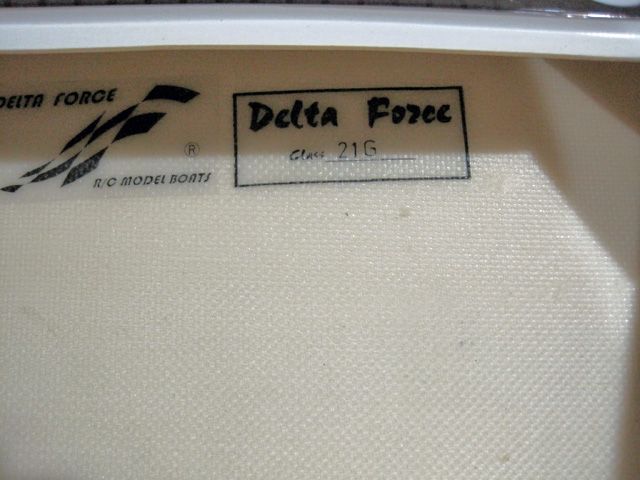

    I found a deal on a DF 33 with uninstalled hardware I couldn't pass up so here is my take on a DF 33. This is my first build so any advice appreciated.
    I already have a T180 so I decided to go with a leopard 4074 2000kv on 4s.
    Going to start with a 442 then 444 if that works out will try an x645
    Will be running 4s 10000mah. 4s 2p.
    Reinforced the hatch.
