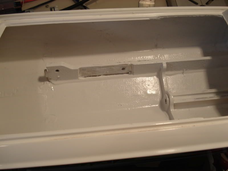

              Clean Up

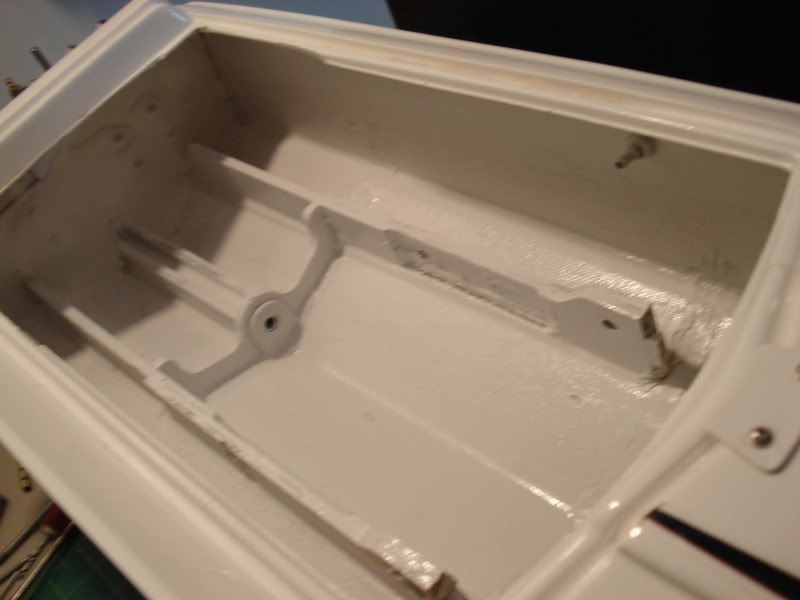

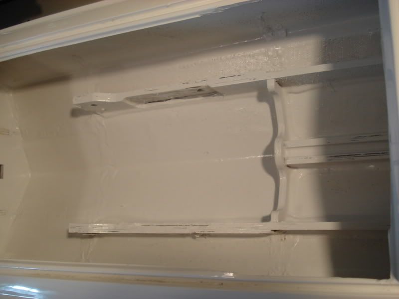

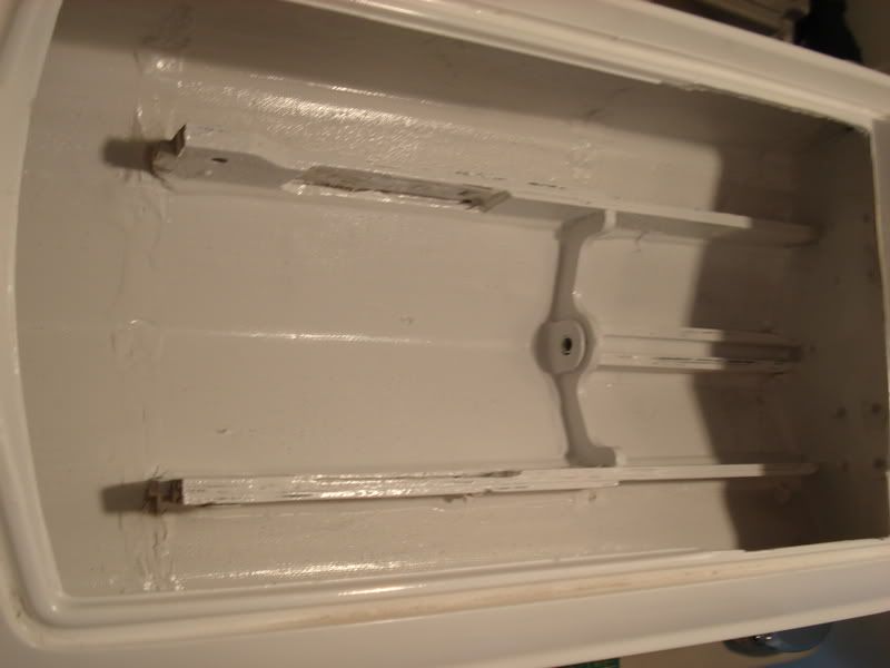

              I had a nice sunny day and some dry air. Perfect conditons for some painting. The nitro stains in this hull where just rubbing me the wrong way.

                    I'm gonna have to place my order this week...i can't take it anymore!!! have you found a 6mm to .187" coupler thats setup like a collet, or are u using the one that they sell here w/ 2 set screws on the motor and 4 set screws on the flex??? Once I mill out my motor mounts I'll have to start posting some pics... I don't think I'm gonna rip out the radio box though...gonna stick with the stock rudder setup for now. Handled well w/ nitro power...

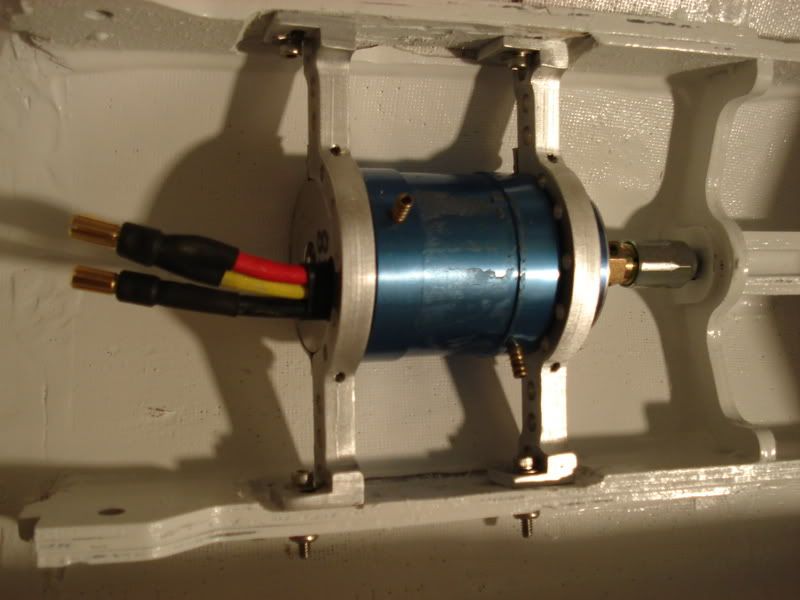

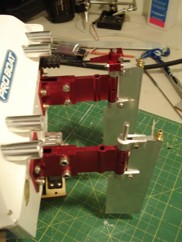

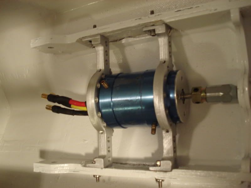

                        #41
                        The motor mount is in an alined perfect. The rudders had to be pulled and mount holes in the blade redrilled. Seems the holes where off and the rudders where binding really bad. I freed them up alot. The order from horizon should be here tomorrow and I'll have the drag link and 2 more control horns. I scored a 144oz cen servo off ebay for 20 bucks. The store I bought it from is 30 minutes south of me and shipping is still cheaper than the gas to run down there...WTF?? Anywho that servo should be plenty. I ran into a road block fabing the radio/battery tray. I'm outa carbon fiber. A quick trip over to my guy in ebay netted me a 5x7 panel of 2x2 twill for 12.50 shipped. It's only .023 thick but it will be braced by the stringers and some of the kevlar composit I have left. I hope to be in the water this weekend.

                                Quick update: My CF plate shipped today. My horizon order arived yesterday. Tonight I'm attempting to rig the steering & drag link. Once that alined the rudders and stinger will be pulled and stern preped for filling and paint. It's going to be damp the next day or so. Paint will probably be saturday.
