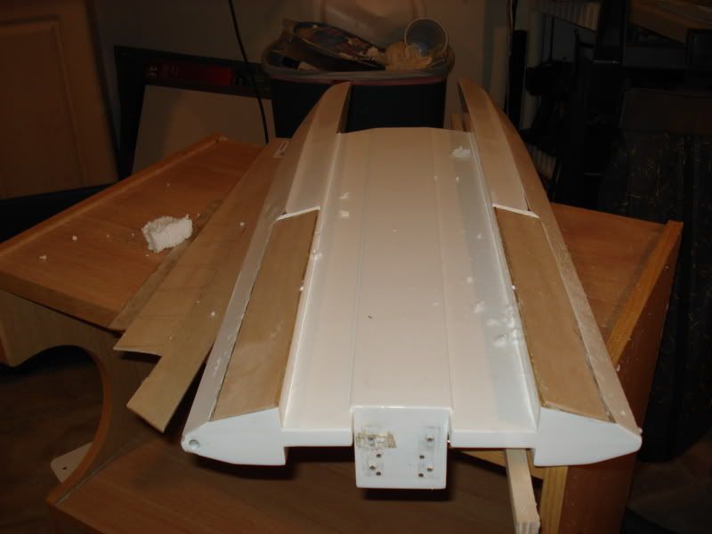

    I am off and waiting...for the first cure.... I have put some backing in the openings in the bottom of the hull and laminated my ridepads. I will cut them to fit tomorrow night. I didnt set them tonight because I dont have big enough clamps . Off to the home depot tomorrow. I paid for the trick motor mount from Vic tonight and have a shopping cart full of angledrive and all the trimmings @ hyper just waitin to be checked out. Got to close the deal on the TC31 and I'll have it in the mail. The pictures arent much to look @ but its all I got tonight.

                        I broke out the new saw blade and completly cut out was was left of the pads. I broke out the angle gage and made up some braces out of 3/32 bass changing the deadrise to 16. I did 3 per side plus the bulkhead that was there. I used the same bass for the pads. I cut them pretty close. I epoxied the under sides and then set it up to dry for the night. I put a layer on the top of them also. I will be sanding most of it offbut I had alot left over. Any suggestions on a filler would be great. Id hate to use up all my DC filling it all in. I hope to have this done by the weekend. Then I can start the radio box. I have decided to use the one I was sent. I am going to build an add on out of the kevlar composit connected but seperate. This way if I blow an esc I wont run the risk of damaging my expensive packs & dss rx. Look @ the mess I made..lol

                          THAT is what I had in mind... I knew you would get it done... I like the step at the front of the pad... It'll be interesting to hear how it handles once you are done...
