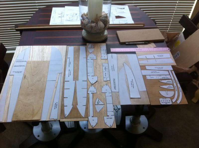

                            #88
                            here is the layout, I'm hoping to get it all cut out later today

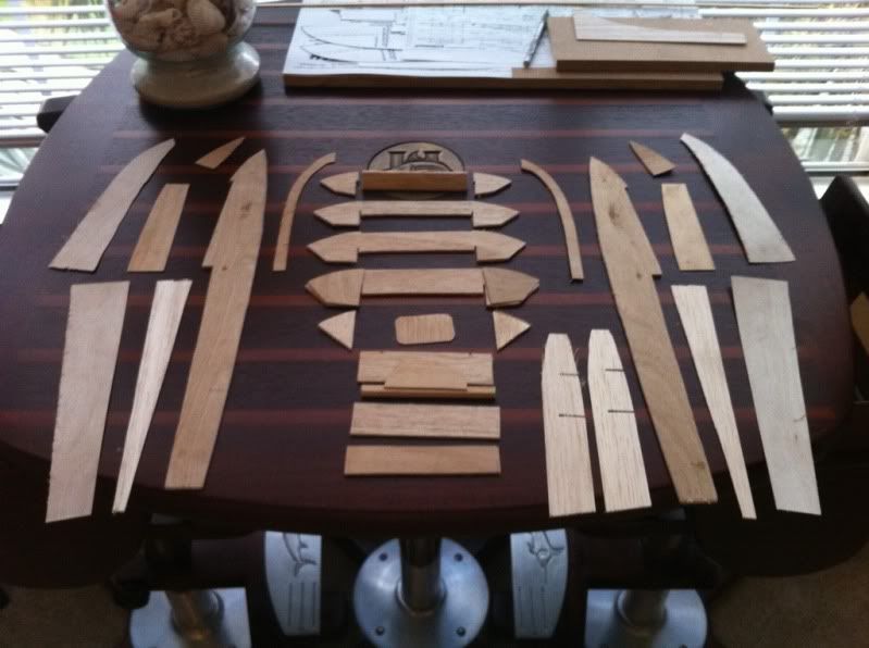

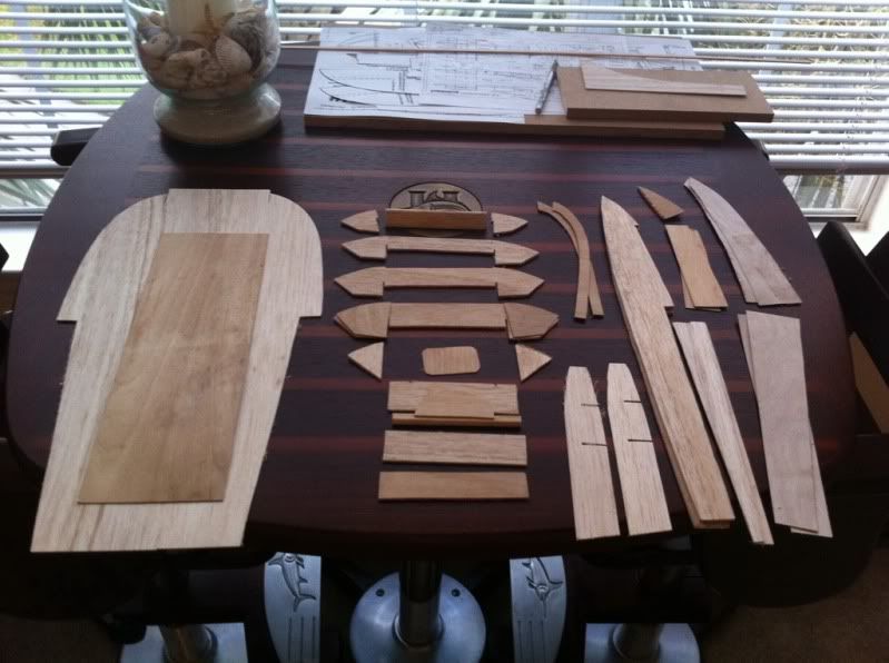

                                #90
                                got all the parts cut out
                                as you can see I glue two sheets of balsa together th make the deck one piece, the bottom sheet for the tunnel is on top of the deck
