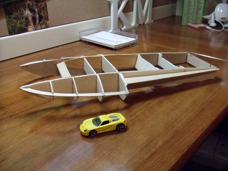

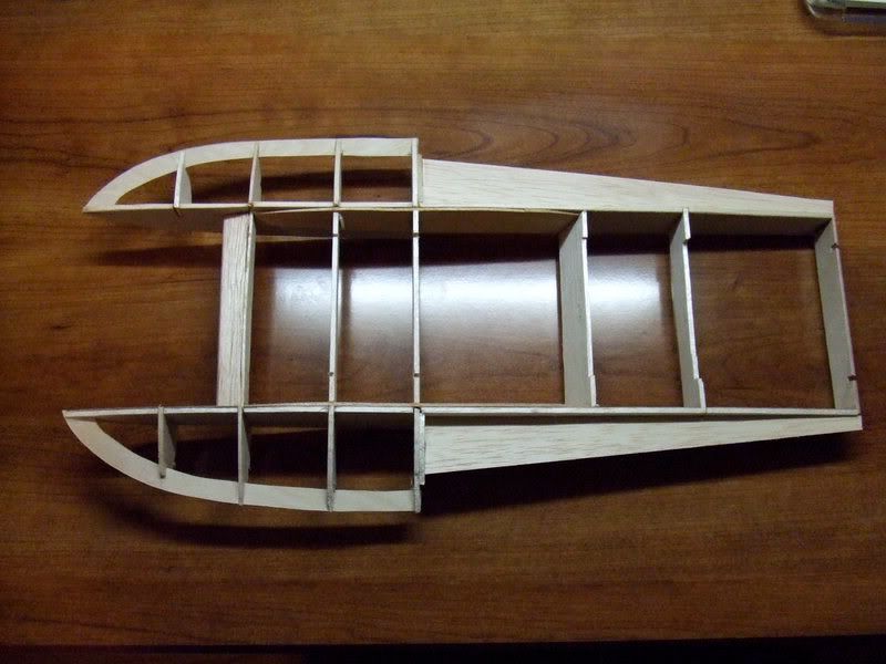

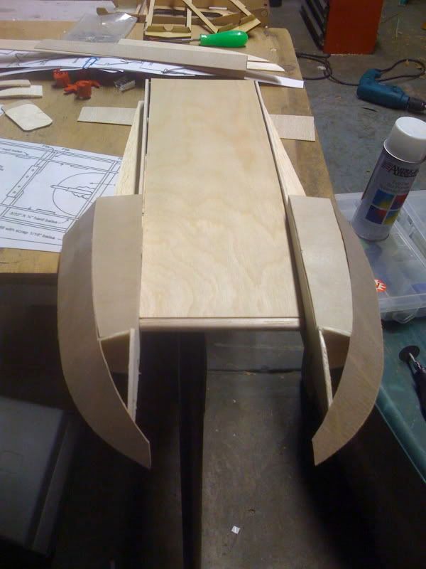

            here's the update I spent some time on the boat tonight and made some great progress. basic framework is almost complete.
            note the hotwheels for scale
            • Avanti
              • Nov 2007
              • 1280
              I used two straight edges and a bunch of t-pins to keep everything square.
              I plan on spraying the frame with poly(something) prior to skinning the boat.
              I will also add some foam to the sponsons.

                Any tips on what to use to spray the frame work before skinning I should be ready for spray this weekend
                a little help.............?? thanks guys
                • ace028
                  • Aug 2007
                  • 952
                  #23
                  we have thinned out fiberglass resin and sprayed it, but you have to get the mixture right for it to work. I think that thinning some epoxy out may be easier and you might have better results, I think that the kind to use is in the OSE store called zpoxy or something.

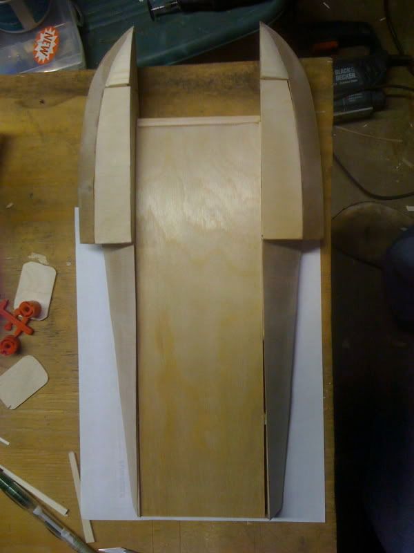

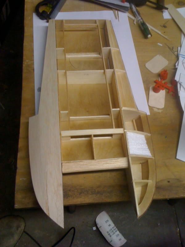

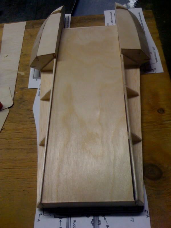

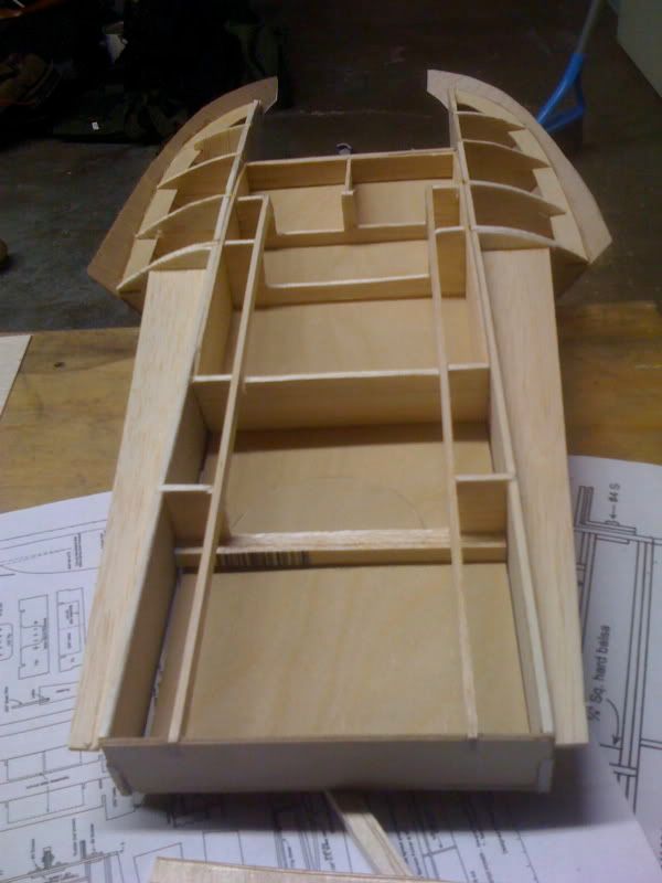

                    I did some more work tonight, tomorrow I will decide what I will use to coat the inside and framing. Has anybody tried just a spray on poly in a aerosol can??
                    any where here are the pics of the frame work and some skin
                    • fastbaltek
                      • Aug 2007
                      • 331
                      #25
                      where did you get the rounded nose piece?

                        #26
                        that looks good!, nice job.

                          #27
                          I got it at a local hobby shop that has a lot of plane stuff. I had to cut it down a bit to make it the right size.
                            wood sealer! High solids sealer Is killer for coating wood especially balsa because, It fills the wood grain and you can sand It smooth. The grain will lift any time you coat It with anything and the sealer will fill It. Spray a few light coats only and sand Inbetween. Then a surfacing epoxy finishes It off nicely.

                              Thanks Stealth I will definitely give the finishing epoxy a try on this boat.
                              I am very please with how it is turning out.
