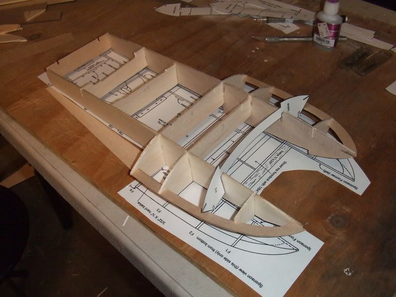

                  Well I got almost all the parts cut out tonight and did a quick mock up. this sucker is small.
                  I definitely need to build a jig before I glue it up she is twisting a bit because of the hand cut parts.

                    thats looks great !!! awesome work.

                      Thanks Taylor I plan on working on a building jig tomorrow sometime. I also need to pick up one more piece of 3/32 balsa.
