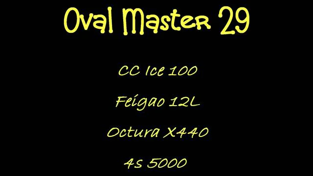

          found a nice video, man there is a lot on this boat, think I should keep the yellow?
          This is the second run with a BBY Oval Master 29. Still trying to get a handle on the setup.

            Originally posted by 785boats
            We've still got a few running at our club.
            One with an 8XL on 4s & this one with the Ammo 2300.
            http://www.youtube.com/watch?v=DHFClOixOWo
            That was a nice run. I would like to see the setup on that boat.
            Wilmer and I had a OM26-N2 running at about 55MPH in oval trim. I have to pry it out of his hands every time I loan it to him.
            With the right setup the OM29 can attain good high speeds. If you push out the strut more it will cause more lift, the one thing it does not need. For Oval speed one rudder and a shorter strut would be better. But this boat was setup for LSO and it takes a bit to change.
            Randy
