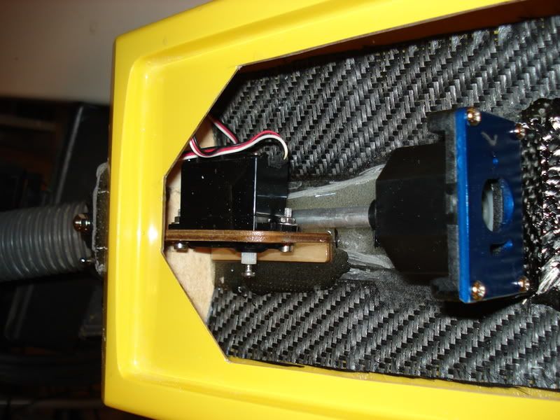

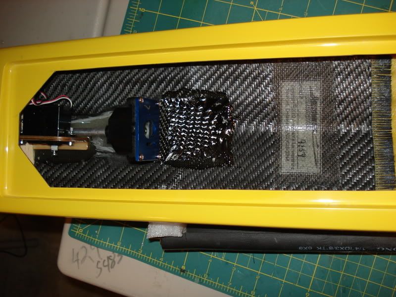

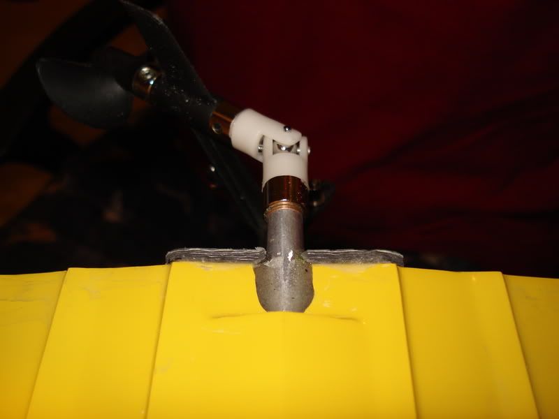

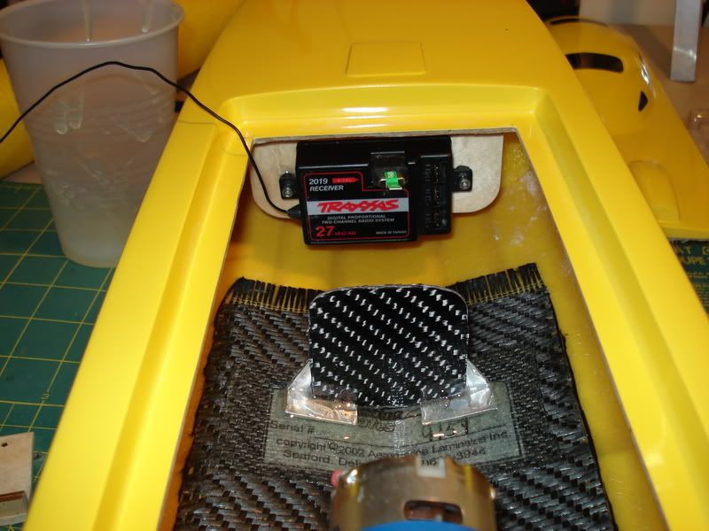

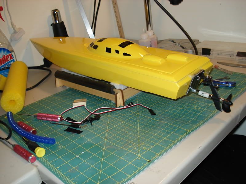

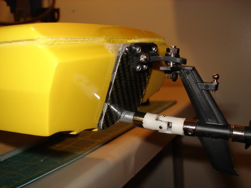

                            95% done
                            I have hit it hard the last 2 nights. I have to pack it early this evening. Weather is on the way and I'm on stand by. So all I have left is steering, water cooling & wiring. First thing was to patch the cf in the botton where I sanded out the DC. Then I decided on a vertical esc mount. I figure it will be easer to run the wires and keep it out of any water. I cut up the wood servo and receiver mount from the blackjack for my other mounts. The tx mount is CA'ed to the hull. The servo is epoxied in. Back in the stern is the carbon kevlar plate. I needed to extend the transom up just a little for some range of movment or ajustment on the outdrive. I used such a big piece of plate in order to cover the mount holes from the stinger. That motors just in there so I had an idea of spaceing. I will have the motor and esc delivered next week. End to end packs fit along side the gear drive fine. Side by side backs have to be put on edge along with 4s packs. I may not get any more done this week due to weather and the Mrs upcoming off week.

                              Last 2 shots
                              • G Doggett
                                • 446
                                #30
                                Aah the old steerable stern drive trick ! - I like it.
                                I'm still sticking with the home made 'stinger' and twin Octura rudders on mine, and even with the fat SS1 it is possible to have the battery packs either side of the motor on their sides.
