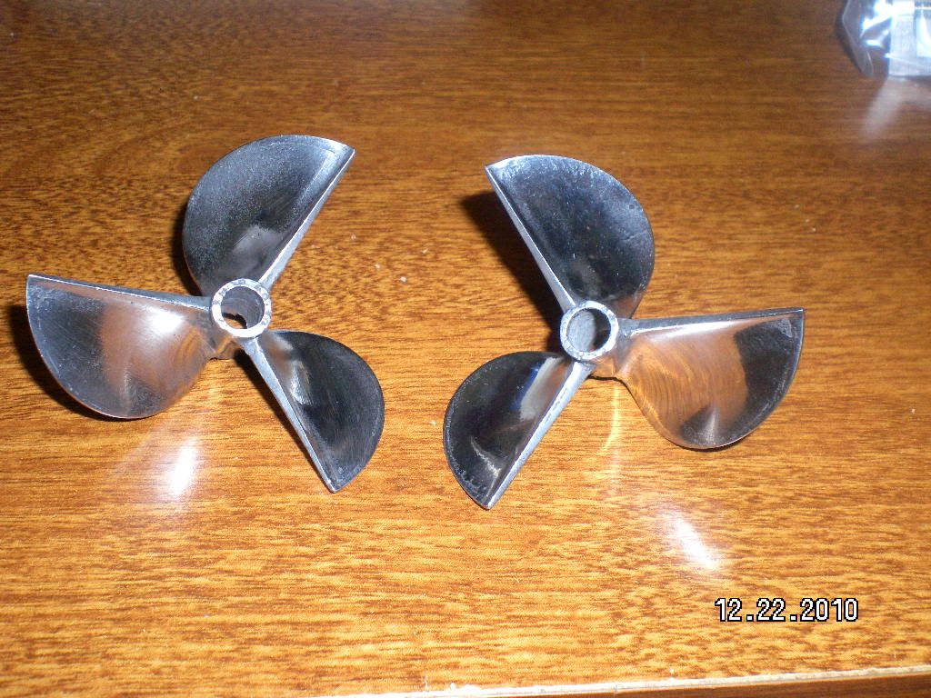

      OK I tracked down some props, they came from DasBoata. What a prompt guy with answering emails. I should have them on Christmas Eve hopefully in time for a test run before we have to go to the family events.
      These are stainless steel 6017/3
