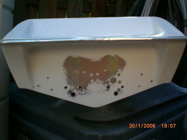

Got a lot done today, I would be ready to run it by Christmas Eve with the MTC surface drives but now I have no props. The props I originally got from Prop Shop UK for these drives are very nice, but they are for a 3/16 shaft. These drives are 1/4" shaft. So now I'm on the hunt for props once again.
LOL......this transom has had more holes filled than a Las Vegas brothel. I think I'll name this boat swiss cheese....LOL
But I'm not bad at small scale fiberglass repairs....

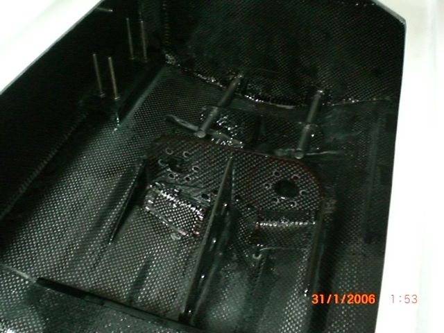

I had to cut the motor mounts out for the z-drive set up and build new mounts out of 3 MM carbon fiber. I thought the inside was going to look like crap but it doesn't look bad considering all this hull has gone through.
