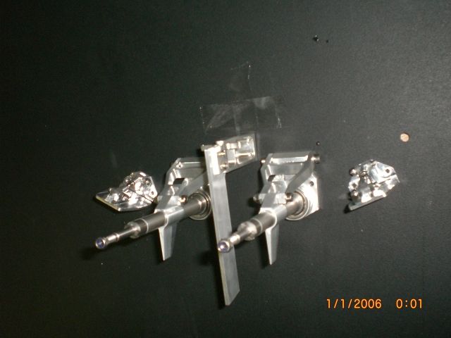

    You're probably going to want to extend the rudder bracket to get the rudder behind the props.
    • ScarabChris
      • Oct 2010
      • 752
      #32
      I hope turning won't be an issue. Those keels on the stingers are gonna want to keep the hull going straight.
      I was thinking about that, but there must be some reason MTC builds them like that.
      Not sure why, my big gas boat is set up just like this except it has one drive instead of two. The rudder is off center and in front of the prop and the boat handles fine.
      I was playing with the drives and I may be able to make them steerable. I'm still looking into that so maybe I can eliminate the rudder all together.

        Skeg
        Skegs will act like turn fins.
          Thats what I was thinking as well.
          Not mounting them yet though, I want to see what those 820 outdrives look like. If I end up not using them on this project I'm sure I will on a future build.

              Originally posted by ScarabChris
              Just got the drives and rudder from MHZ. I must say these are some nice drives. I also got some trim tabs from MHZ but I found these from Redline, they match the drives very nice so I'll use them.
              Here is a transom mock up. The hull will be black so this gives an idea of how it will look.
              Yeah, I think skegs would act like turn fins, as long as the rudder isn't right between them. Is the rudder much behind the skegs or are they side by side?
              Drives look good man.
              Brian
