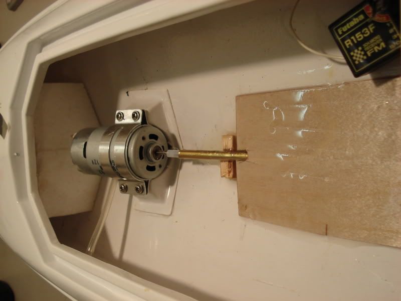

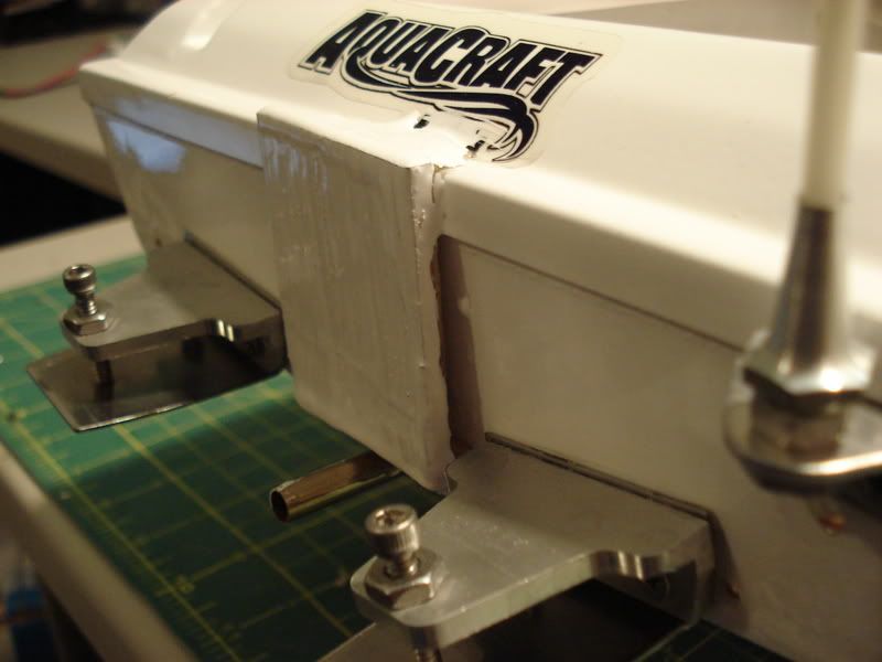

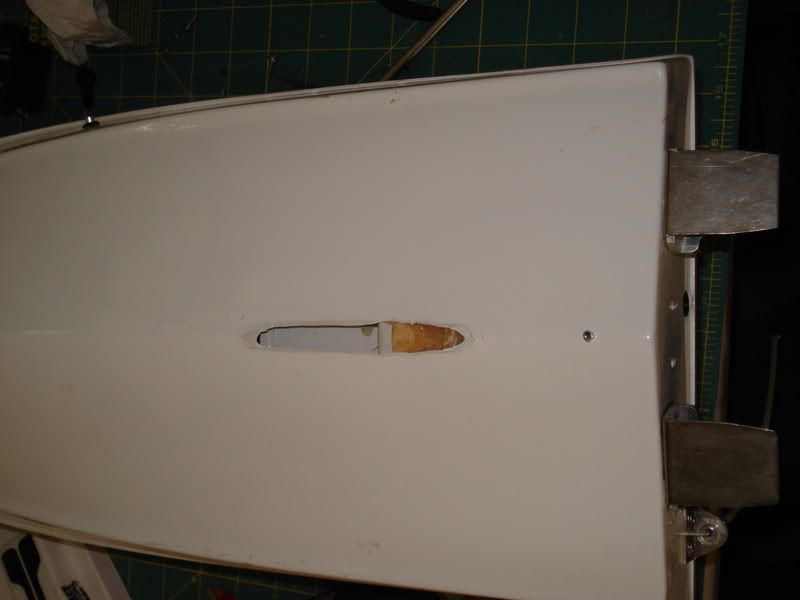

    This is an upgrade I am doing for my Brother. Last week the performance on this boat was inproved by the esc upgrade. It still suffers from a cavatation problem and lack of some top speed. It don't like real choppy water and the prop loses bite fast..along with the rudder. I have a Proboat outdrive (thanks again Deigo) thats going on. As you can see from the pics I have the exit form the old propshaft cut out. My problem now is the radio box. I can NOT get it out. I fear the dremmel with a cutting wheel will be my only option this evening. What a smokey mess thats gona be . We have a nice 12v air cooled 600 motor that Doozie gave us for some upgrade power. I think 7 cells will do the trick here. We now have cells in spades (Thanks Fluid!!!) so making up some packs won't be a problem. I am hoping I can get this little boat running with or past my Villain. ANY suggestions you guys may have on power or drive setup is more than welcome. Thanks and enjoy the thread.

    i pried the radio box out with a knife. i like this project. cheap upgrades are cool

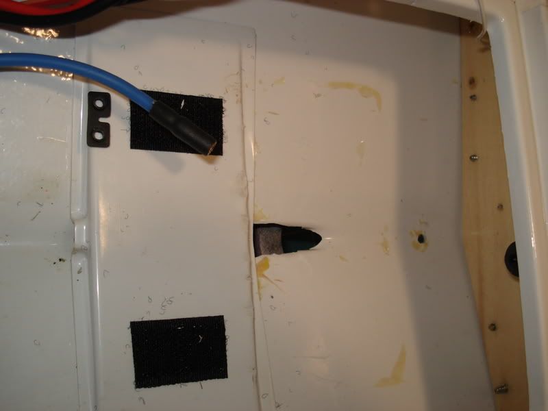

      Thanks man. I am afraid I will rip the bottom of the boat out. I cut out the stuffing tub exit with a razor knife for god sake..lol. We are having fun with this also. Most of the stuff were using are gimies:).I look foward to helping him build his firts brushless boat.

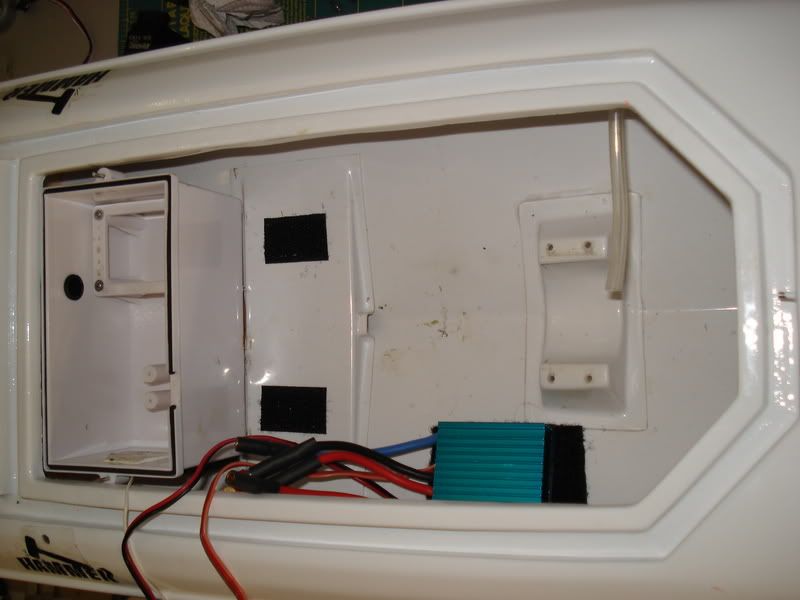

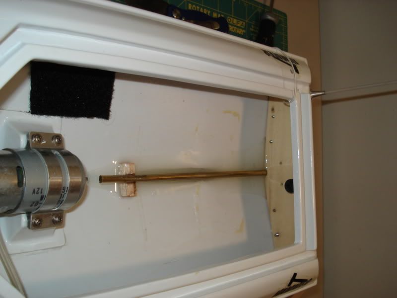

          I got the box out along wit the battery tray. Stuffing tube is epoxied in. I am going to put another tray in it tonight. I may get around to preping the transome for the drive also.

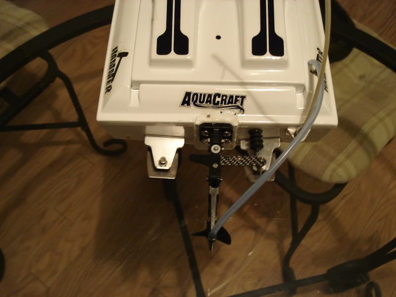

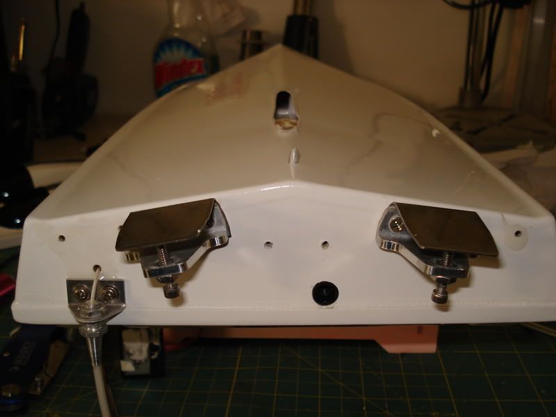

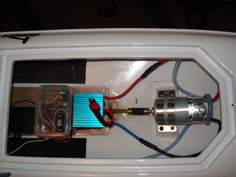

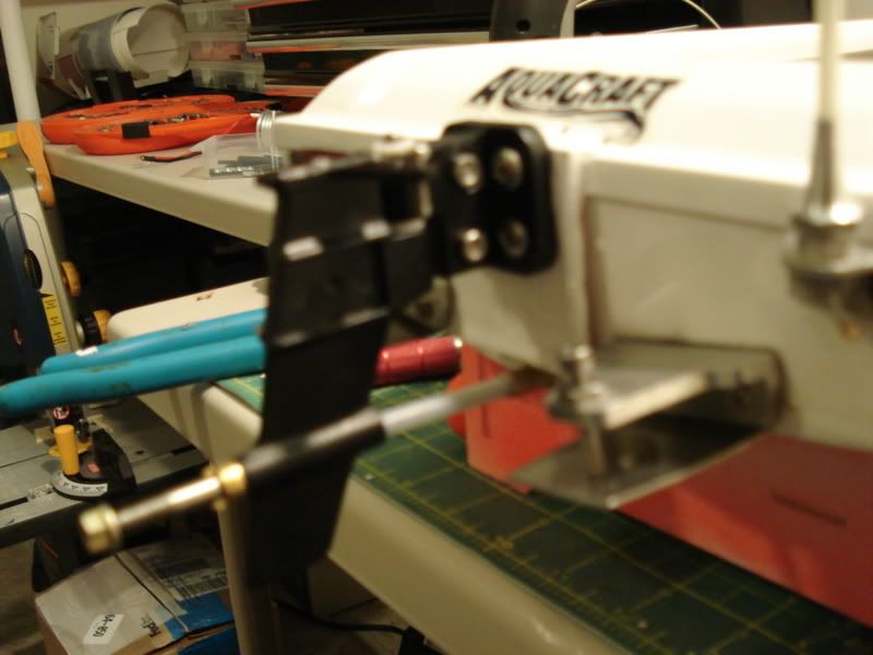

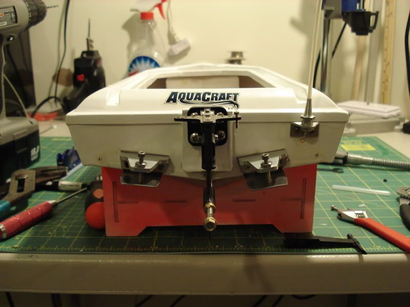

              I am almost complete. I got a nice level surface down the center line of the hull. I'll mount the RX servo and esc inline. That leaves almost a foot of space on both sides for packs. He will only be running 8cell saddle packs but they will be able to be place all the way @ the transome if need be. I had to make up a bracket to level up the transom. I had the epoxy set up last night. A coat of white paint dressed it up a bit. The outdrive was mounted up with some big stainless screws. Alinment looks good all the way up to the motor. The stuffing tube just need a slight tweek for it all to be perfect. It should be wraped up tomorrow afternoon. High winds will rule out any tests untill Sunday.

                    With that seerable outdrive and the relatively shallow 'vee' on the Hammer, you may find that you need spin fins on the transom to keep from spining out. When we used to race shallow vees without strakes, some of us screwed a turn fin on the right side of the boat at the CG to improve steering and cornering. Looked kinda funny but they worked great...

                      Thanks for the tip on the fins Fluid. Props has a set of turn fins in the mail for me. I will install the pair of them. As to progress I am alining the steering now. Some epoxy on the linkage boot and servo, then its off to the motor for brush coolers and connectors. I have about an hour left/

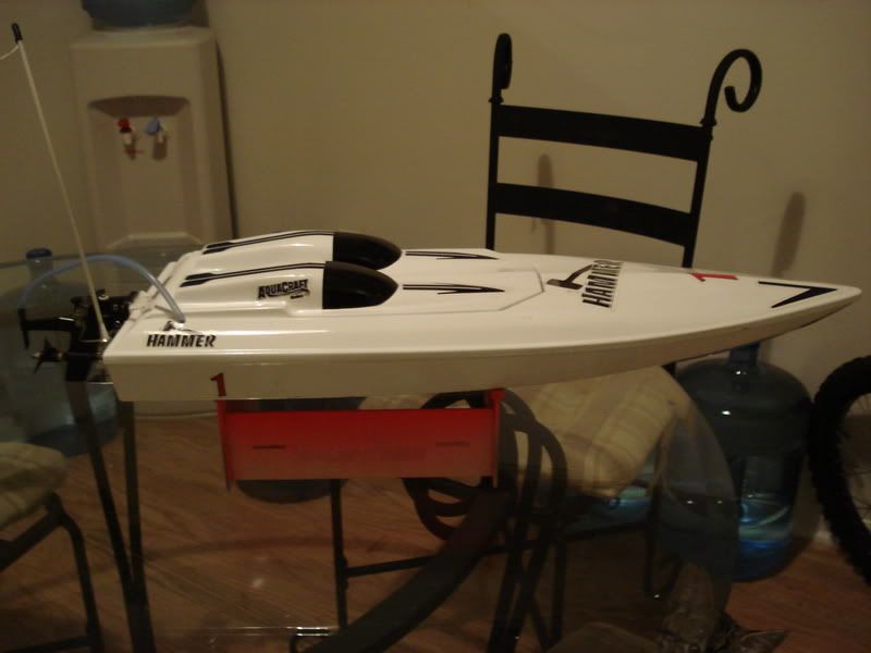

                        Id like to start by saying. Hey look I finished one:D. Prolly cause it wasent mine..lol. The bench test video is a first for me. I thought it was a kewl idea. So ok here we have it. Few things, Had to extend the crontrole horn on the OD due to servo placment. Drive lined up perfect with the motor. Cable turns smooth as butter. This was my first attempt @ installing brush coolers. I should have done it long ago it's simple stuff. I am content with the placement of every thing. I have to tape the ecs battery input plug. It's a little close to the coupler. This motor turns up pretty good. It's rated @ 12v and we are puttin 11.1 to 11.5 into it. It should run pretty cool. The esc will have to be watched. We have that just about @ it's 12v rating also. If it gets to hot I'll use some thermal epoxy and bond a brass plate along with an mhz cooling block to it. I want to test it before waisting the stuff first. It's not cheap. We will lake test it in the morning. I'll have the run pictures 7 videos tomorrow evening.
