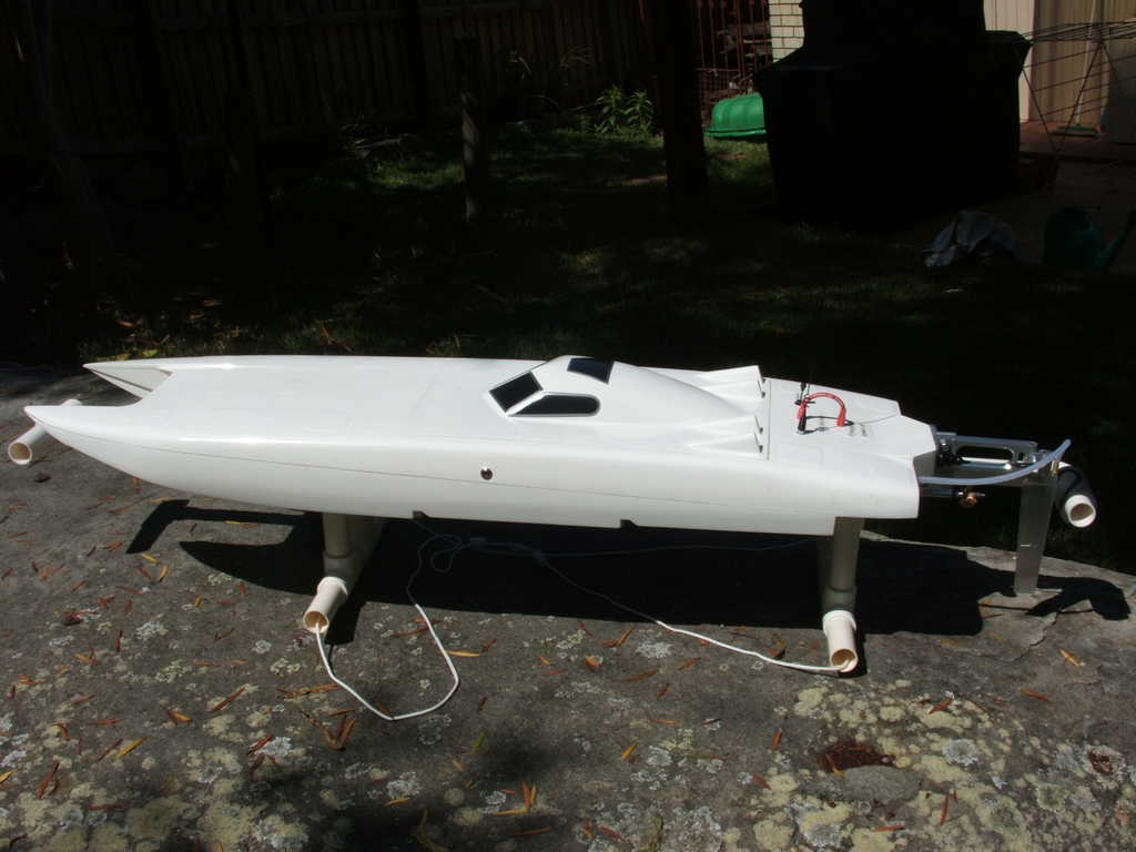

    The inspiration for this layout was from a Maritimo Cat that was built by Ray Schrauwen, whose project puts mine to shame.
    Design parameters.
    My budget did not stretch to twin motors so decided on single motor set-up.
    Motor is Feigao 14XL (but have options of using 10 or 8 winds)
    Esc is CC 125, which I already had in my Syncron.

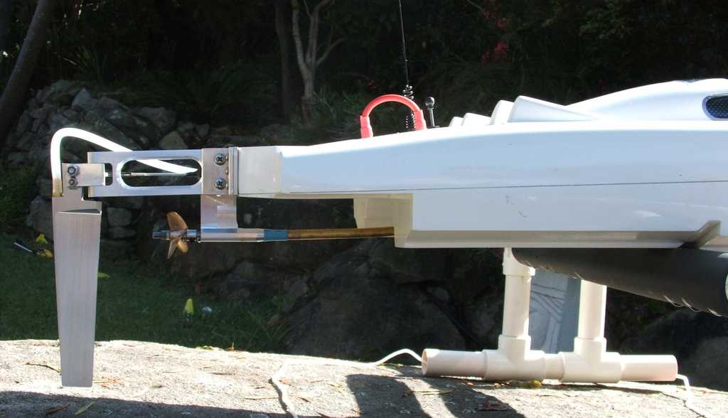

    Rudder , I wanted to go with an in-line rudder, originally opting on a MHZ Hydro In-Line Rudder but was not able to get this due to stock availability.
    So I decided on a speedmaster rudder which I then modified the bracket & strut to make almost in line (offset by 1/16 inch)
    For the dive shaft I opted for 3/16 flex cable to cope with any increase power in the future.

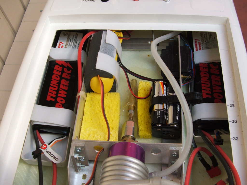

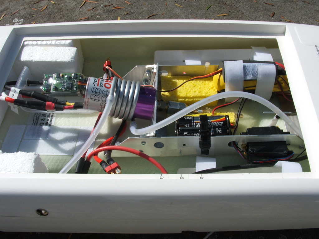

    Step 1 - Built structure for mounting Motor, Servo receiver & reciever battteries
    I liked Ray’s set-up for mounting the Motor and servo in a single framework, I was not able to get hold of any Carbon sheet or similar so opted for using Aluminium to build the frame (light weight was not a primary concern as I had read that this size Cat can suffer from flipping if to light)
    Also it was easy to work with the Aluminium.
    Step 2 - Modify Rudder and Strut
    Modified the brackets holding the rudder so the strut was close to being in-line, it’s actually off set by 1/6 inch.

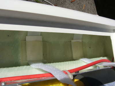

    Step 3 - Battery placement.
    I’m still working on the battery placement and how to secure them. I have made some fibreglass brackets, which are epoxied to the hull and am currently looping velcro though these.
    So far from tests best performance is with the batteries as far back as they will go.

    What is that red loop on the back of the boat. That boat will be very under powered running on 6s with the 14XL. I would suggest at least a 11XL or 12XL for that setup.

        The red loop is a safety loop. When you pull out one end it removes all power for the ESC. They work great!! BTW nice build!!
          The loop is a safety cut-off loop, you pull the loop to cut the power in an emergency or if you want to change props without taking the tape off the cover.
