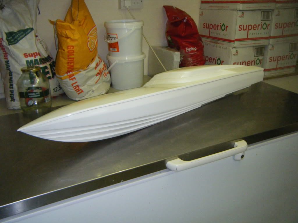

    Hi im new to this forum i live in the uk have been into r/c for a few years, im not really a forum person but i thought this build might be interesting. its not a step by step build i will try to explain what i have done.
    hull:- aeromarine challenger pro 43"

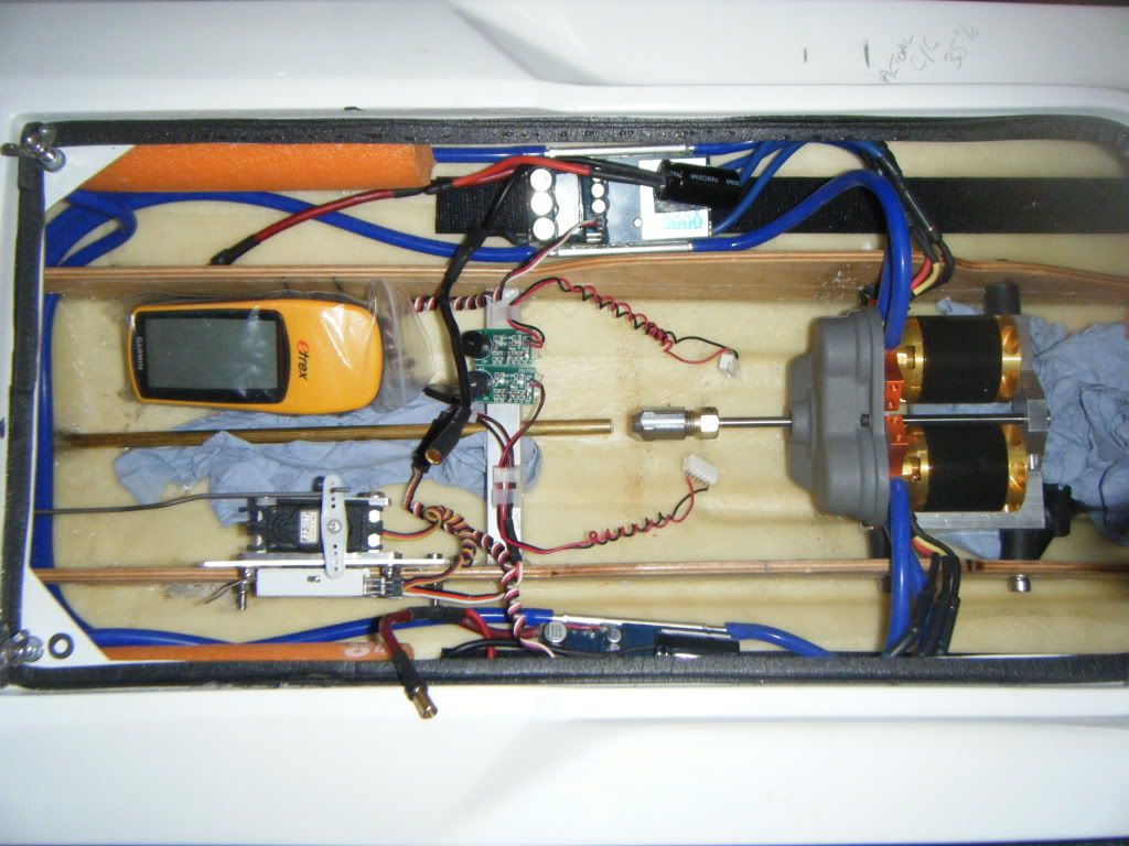

    motors:- scorpion hk30-1900kv
    gearbox:-mocom nitro ratio 1.67 traxxass revo 24/40spur
    2x turnigy 5s 5000mah lipos
    2x etti 100a 5s esc's
    .187 flex/octura strut
    octura x452/3 prop
    On the first run i managed 47.1 mph in the sea but im now getting 45-46mph on average. Im yet to try on a lake as we have nothing big enough locally.

      Sweet, twins rule... that is a gorgeous hull!!! Great build - she moves!
      Those are the exact water conditions I LOVE ! you may want a little more trim tab or down strut for that water - looked like she was wantin to blow over.

        What about the gearbox you used for the two motors, is that common in nitro boats? Never heard of those before is very interested
        Also who sells them?
        Cheers
        JC
        • elad
          • 4
          this is the gearbox i ve used i had to flip it upsidedown to get the gears to mesh then i redrilled the revo spur gear to fit its really simple to do once you have the parts in your hand
          The gear box is availible from prestwich models in the uk
          GB1NA MOCOM 3.5cc gearbox 3.5cc with standard 2:1 ratio 14T x 28T. Complete with CNC machined aluminium body, flywheel/drive gear, lower Mod 1-10mm wide delrin gear, 5mm drive shaft, bearings etc.
          NOTE. You can specify the gears you want on the gearbox.
          i used a traxxas twin motor plate off an emaxx mounted on the face of the gearbox frame.

                  Can we get picture of the gearbox with the cover removed?
                  I could see that you have mod the gearbox with some watercooling. Its really brilliant and seems like a good alternative to big motors with 8mm shaft (like a gas zenoah or electric littlescreamers).

                    Thanks everyone, ive quickly tried it again with flatter water and less wind much improved handling but speed is the same. if it was earlier in the year the weather wuld be perfet every day for testing as i live so close to the sea.
                    Im going to rty a 36 tooth spur this weekend it will give me an extra 1200 rpm at the prop will post more pics and vid then.
