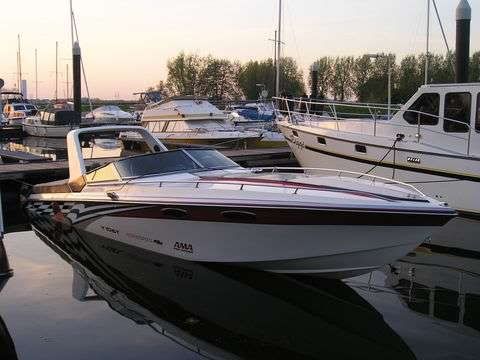

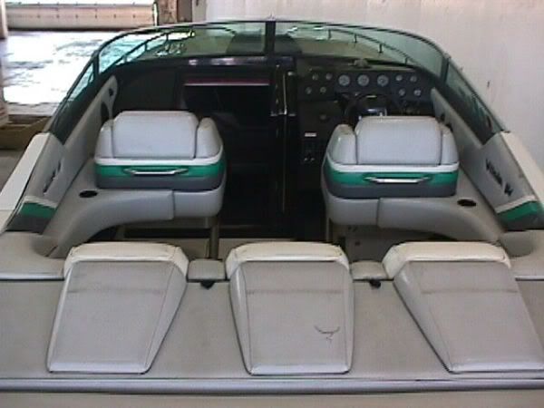

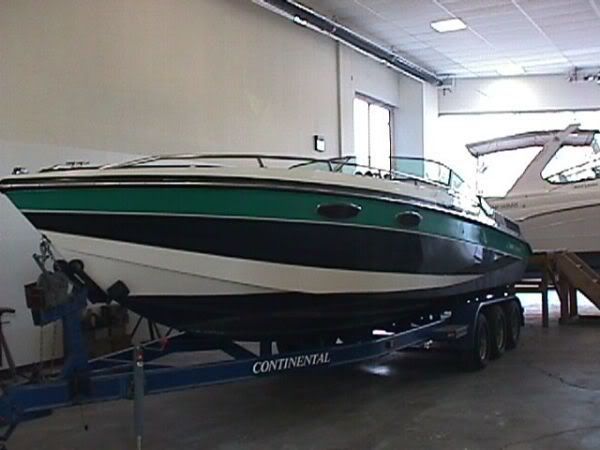

              Originally posted by skidooguymxz550
              this should be a good build.
              btw, the traxxas villian is modeled after the chapparal villian of the late late 80's and early 90's.
              Sure is:
              • hookedup
                • 312
                Originally posted by who8that
                niiiice that thing is sick!!!
