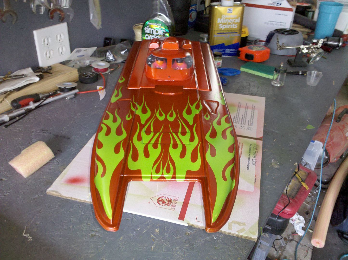

                      I just finished up color on my Volan(don't laugh). I still have to clear it, but it turned out pretty good for the most part. Some bleeding on the mask, blemishes here and there, but hell it was just an experiment and its an ABS hull.
                      Haven't decided if I'm going to do the bottom or not...
                      • dana
                        Banned
                        • Mar 2010
                        • 3570
                        looks awesome!! if you paint the bottom will you continue the flames underneath? looks like some intricate work and time consuming i'm sure
