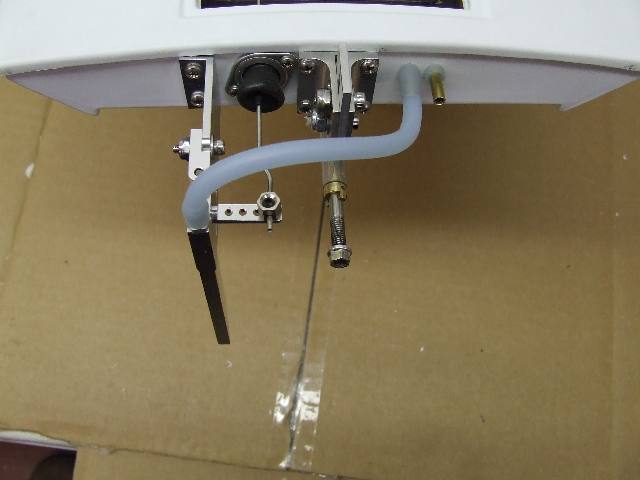

      My hydro came with a bolt in the top part of the rudder bracket but a cable tie through the bottom hole. It you smack something with the rudder the cable tie breaks and the rudder swings up and back. Easy to fix and seems to work. I have had it do that at least once before.
      You can't see the cable tie in this picture but you can see the top bolt
