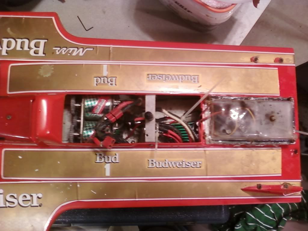

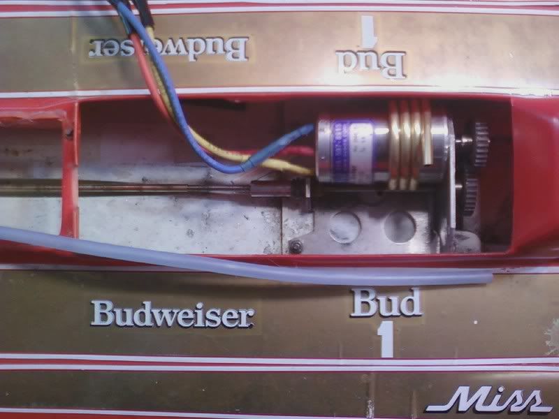

    I have an ABS MRP Miss Bud Boat that i got from my uncle. Ended up Putting a 2700kv Aveox brushless motor in it, with the stock prop and transmission, Made water pickup, motor cooling etc.. Boat never planed, ALways took on water.. Is it worth it to split the hull and put some real bracing and stringers on it and make it seaworthy? Or is she a lost cause?

    Transmission...............

      Easy enough to remove and run direct drive. I can make a motor mount or buy one, Im pretty handy when it comes to fabrication.. Any ideas?

        I'm not familiar with the boat off the top of my head; got any specs/pics?
        Jon

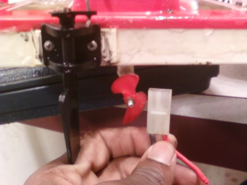

          I believe its 1/12th scale. stuffing tube is good, needs a drive dog and a new prop i believe.

            I had the same boat and ended up spliting it to get some of the webs out so I could get the batteries farther ahead on each side of the motor to get my balance point far enough forward
            I think you will want to change to a flex shaft also so you can change the angle of the prop

                  y535 prop, 1/8th inch drive im guessing?
                  What about running gear? I have no clue what to do for hardware. Stock rudder and turn fin could work, but i dont know how to support the prop and stuffing tube, Im a car guy- boats are new to me lol
