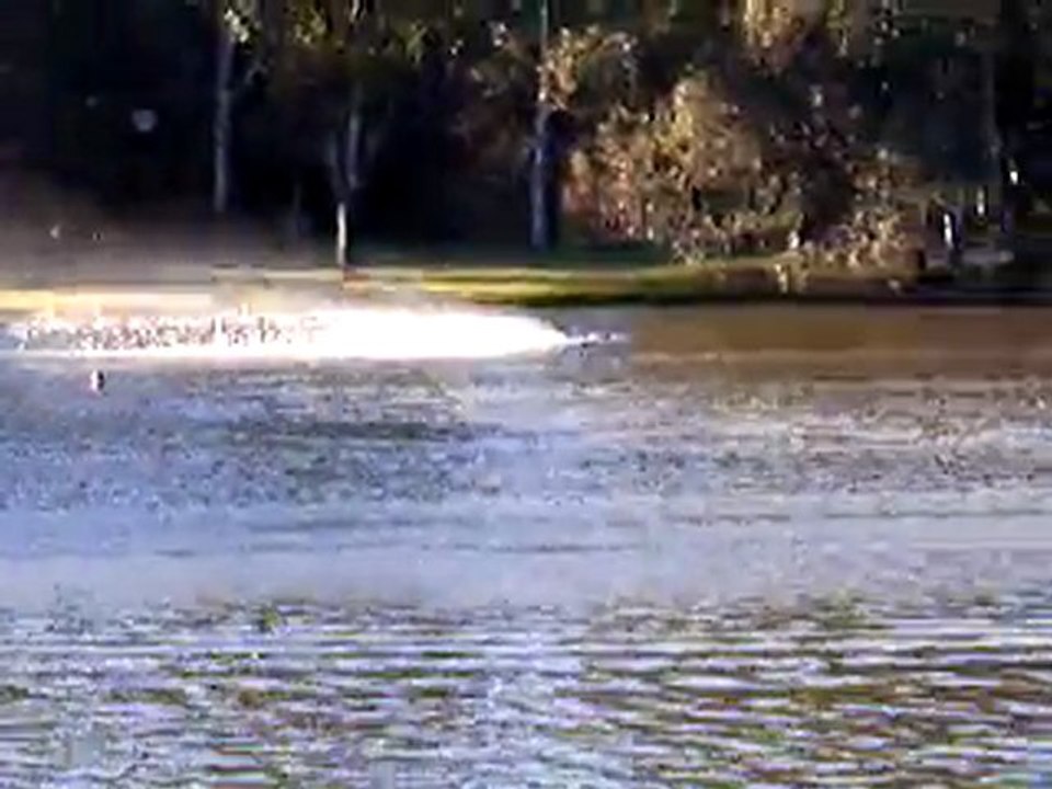

It originally ran nice & stable at around 45mph (gps) over 5 laps, with just one turn fin.
Then I decided to fill in the hooks at the rear of the hull & created an uncontrollable boat that just wanted to fly & flip, but reached 49.7mph. No amount of COG adjustment or strut adjustment or prop changes would bring it under control.
So with a set of trim tabs & a turn fin added to the left side it now runs like a boat should again. Not a world beater but a good solid performer. And cheap too.
Here's a few pics & a video.
